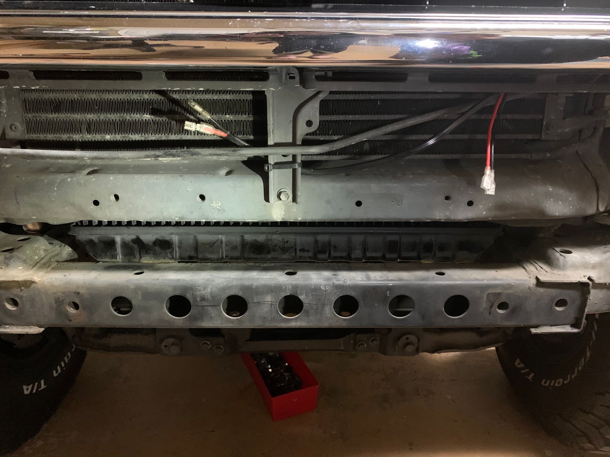

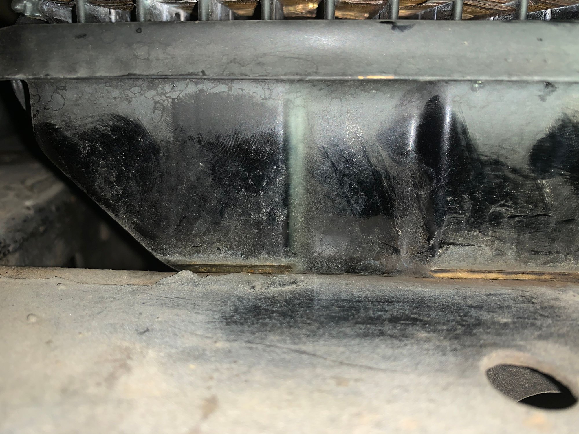

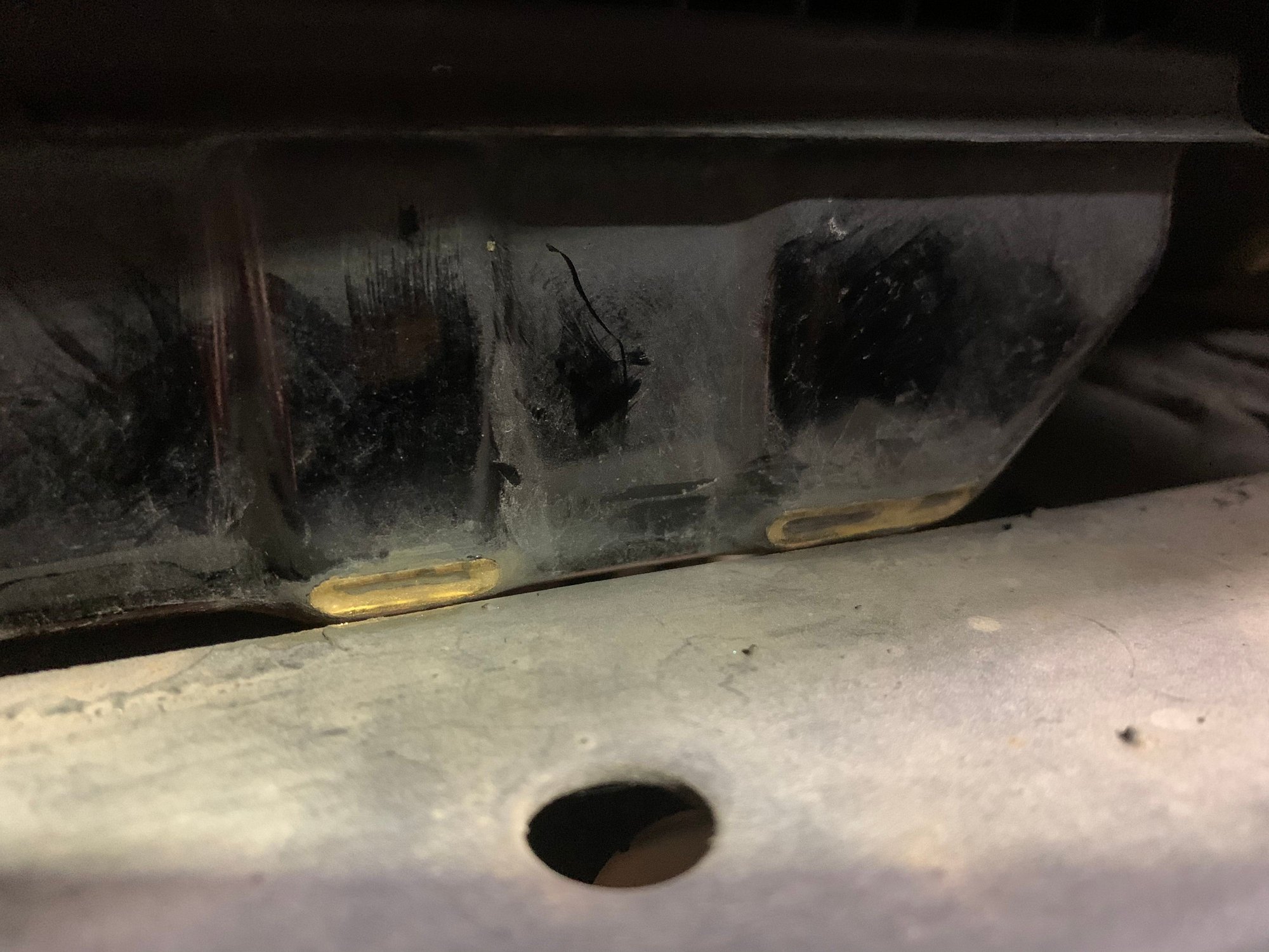

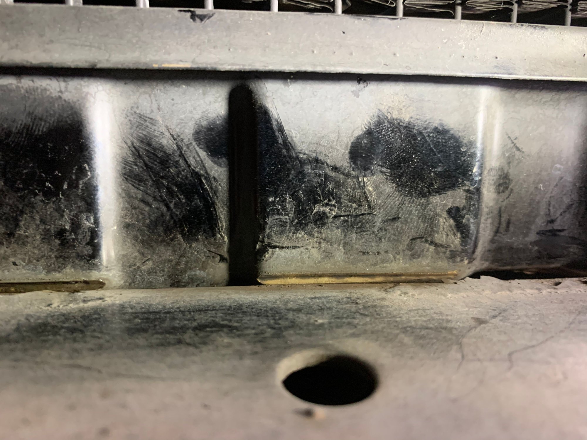

I took off my ARB bumper today and noticed my triple core CSF radiator was touching the frame. When I inspected it closer, I noticed not only was it touching, but it was pushing into the radiator. Now there are gouges on the bottom of the radiator. It’s not leaking at all, but I’m wondering if there’s anything in the bottom of the radiator where these gouges are, as these rads come equipped with the ports for automatic transmission cooling. My truck is a manual, so does not have anything hooked up to those ports. Can I solder just to be safe? What do you think?

Looks like the bottom tank to me so eventually you will have a problem. I’d figure out a way to protect it there. Perhaps some type of rubber bumper in between or something.

You might space the radiator back a tad, using washers between the mounts and the core support..

Thanks for the replies. So after researching a little bit more, and investigating the mounts, it appears the front radiator/core support bushings/mounts are shot, as would be expected for a 25 year old truck. I believe this is what led to the lower tank ever so slightly resting on the frame. So, the plan is (as I was planning to anyway) to replace the body mounts. Hopefully a fresh set from energy suspension or prothane will get everything sitting correctly. Anyone have a part number for a mount kit that just has the body mounts? LCE has a kit, but no part number and I’d love to save a few given I may be out another $200-250 for a new rad. The real pain is that this radiator is only a year old and one of the nicer copper brass out there. Ugh. Next question, is can I solder and repaint those dents to reinforce, or is that a bad idea? Like I said, she doesn’t leak, yet.

Update... What I ended up doing, is purchasing a body bushing kit from energy suspension, which contains the two radiator support bushings I need to get things properly in place. It arrived today and I’m extremely satisfied with the quality, so far, Ive yet to installed it. I’ve used their bushings before on sway bars, end-links and shocks, and I was impressed then. I also had performance radiator take a look at the gouges in my csf.. we determined that it wouldn’t be worth the risk so I ordered another 3 core copper/brass CSF 2314, it should be here this week. I did some research however, because I really wanted to find an all aluminum three core radiator. After spending several hours shopping and doing research, I really didn’t find anything I felt super comfortable with. Years ago on another truck I bought an all aluminum radiator from Yota1 Perfomance, it was quality, but the have since discontinued those. There were a couple 3 core all aluminum options on Amazon, but again, nothing I was stoked about, as I’ve learned over the years that often the mounting holes or shroud holes rarely line up.. not a risk I wanted to take in this case. So, the question is, does anyone know of a quality all aluminum 3 core rad out there, for less than $250?? I’d love to know where Yota1 was getting theirs awhile back, as they fit perfectly and were nice and beefy. What happened to the one I had? Well, I blew it up running a leaky head gasket (combustion gases, my hypothesis).
