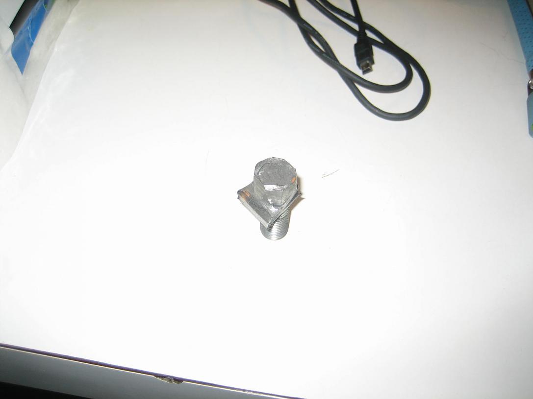

Just take a grinder and cut a little piece of the flange off. Then take the grinder and make the bolt as six sided as possible and put a socket on there that fits as closely as possible. It will come right off. Just be careful not to cut the pulley itself.
That bolt is sooooo hard. It will take forever trying to drill a hole through it...if it's even possible. Space it tight in there and I don't think a drill will fit down there and be accurate at the same time.

This looks like the right approach. If you can get a grinder/cutter in there. And if it's not finger loose after that, you could maybe use a punch and hammer on the newly flat cutoff top of the washer:

Oh, I forgot to state that I had to take the spark shield off my grinder to get in there. It's very doable...

F*** yeah, snobs was right about the flange on the nut. Once i cut off the flange, it twisted off with my fingers
