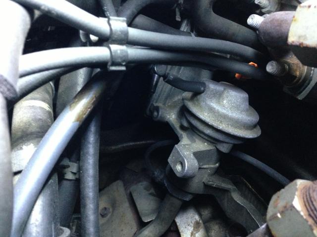

2. At start up the truck runs at 2000rpm. Once it settles in it runs at 1500rpm. Seems high compared to what ive been seeing on here. Ive attached a picture of the tps (I believe) with the motor running. Shouldn't the 2 pieces be touching? I don't want to adjust the idle and it really be something else

FSM for your PAIR system: http://personal.utulsa.edu/~nathan-b...78pulsedse.pdf
And FSM for your TB: http://personal.utulsa.edu/~nathan-b...93throttle.pdf
