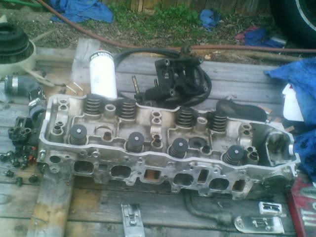

i dont know if u can see because of the light
but some dumm arse put silicone on the head gasket be cause they saw oil in the coolant
and the truck had over headed truck was given to my girlfriend
when took it apart i noticed that timing chain guide was gone chewed up
so i replaced chain

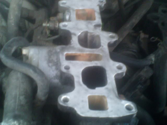

soon as im able to post ill be asking for help diagnosing my truck problems
i cant get it to run start yes but only with "starting fluid " ether

nice vacuum leak ya got there It will not run right without the afm hooked up.You need this for the computer to give you fuel. run a meter on it ( refer to FSM) to check if it's good. if it's bad your truck will run like crap.

i want to apologize to jlthieman for intruding on his thread afm air flow meter and yes there is a vacum leak because i blocked out the egr valve im not sure on what to do with the left over hoses one i hooked into system other i plugged any ideas pics are a lil mo0re helpful ty for ur time
