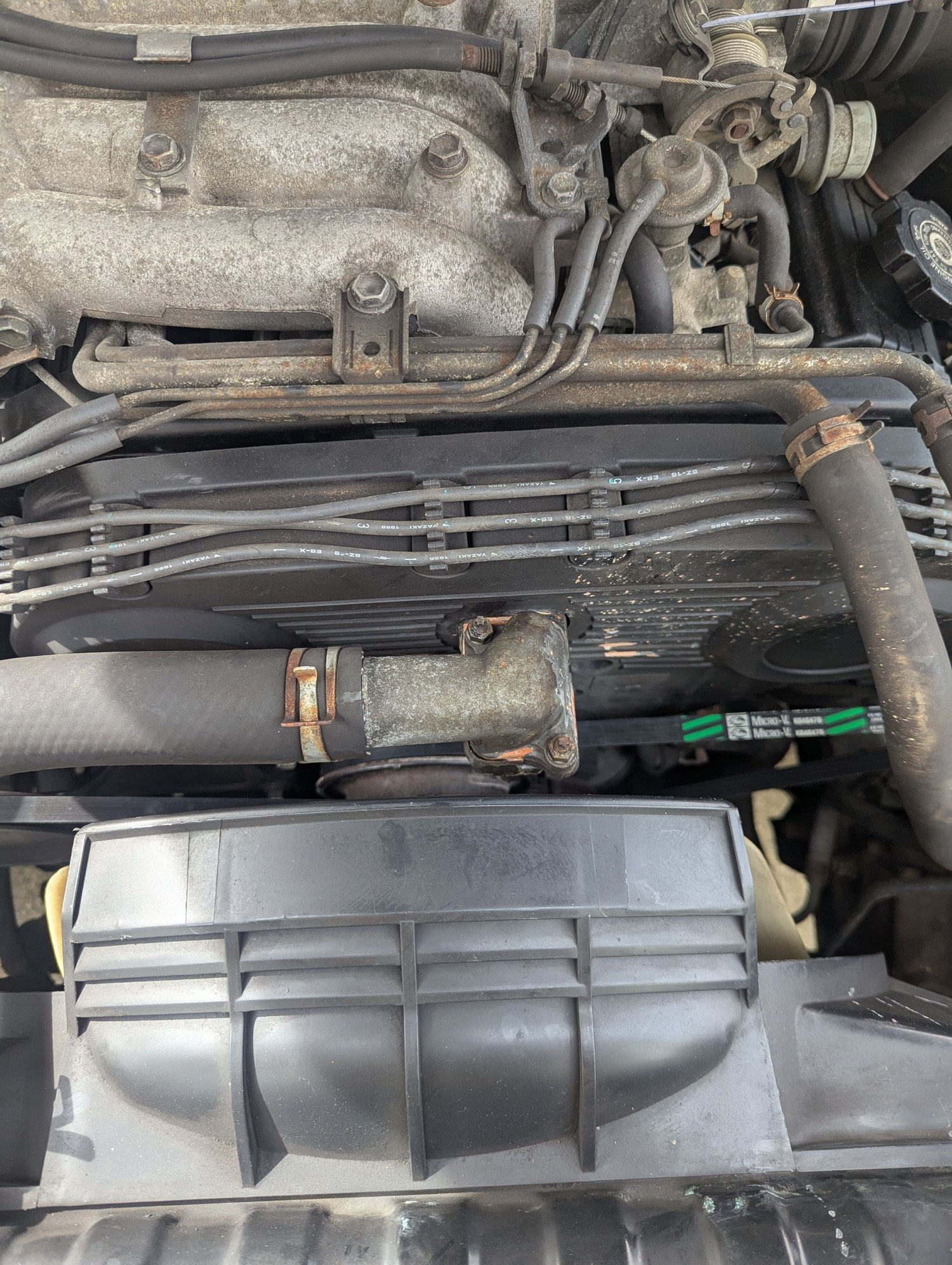

Hi all,
Attaching a pic here of my 3VZE in my 95 4Runner. As you can see by the staining, I am getting some coolant leakage from where the radiator hose enters the water pump area (at least thats what I think this is). I can definitely see the coolant seeping from the seam where the gasket is.

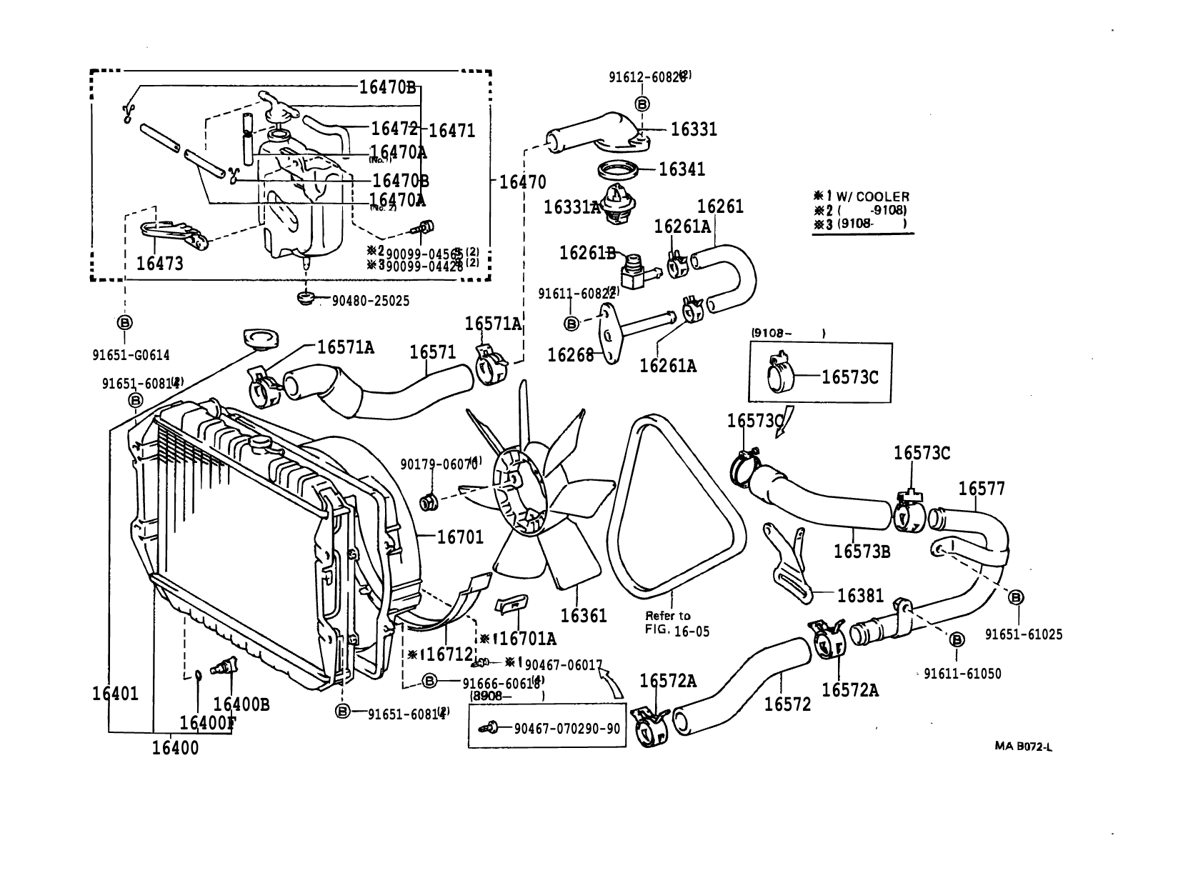

My inclination is to grab the gasket part #16341 on this diagram:
Is there anything else you would replace while doing this? Is the part labelled 16331A in this diagram the thermostat? It seems like it based on the image but I didnt think the thermostat was sitting in this housing. All of this is likely original so maybe I should just replace the hose and clamps as well? Not sure how far to take this, as I dont want to go too far as I do think a timing belt/water pump job is in my future (maybe next year)

Your engine is a 6 cylinder 3VZ-E type.
The parts diagram you show is for a 4 cylinder 22RE engine.
Your 6 cyl engine does not use the 16341 gasket, and your thermostat is not under that water outlet either.
You are gonna need some form-a-gasket material such as Toyota FIPG, or Permatex Ultra Gray.
Careful with the studs and nuts, they may be corroded and easy to break.

Ok I knew something was up with that diagram because it didnt make sense for the thermostat to be there because I know where its actually located on the 3.0
Is it not possible to buy a new OEM gasket for that section? any idea where I can see a parts diagram for this section on my engine because I would like to pick up some replacement studs/nuts as well

The original sealant was a factory installed bead in a groove that exists in the lower part of the housing.
I'm not sure whether any replacement is offered for that, or not.
There is usually no paper or rubber gasket found there.

Ahh that makes sense. Thanks so much. Ill have to grab some sealant then. Honestly at this point I may just replace that entire upper part of the housing along with the hardware.
