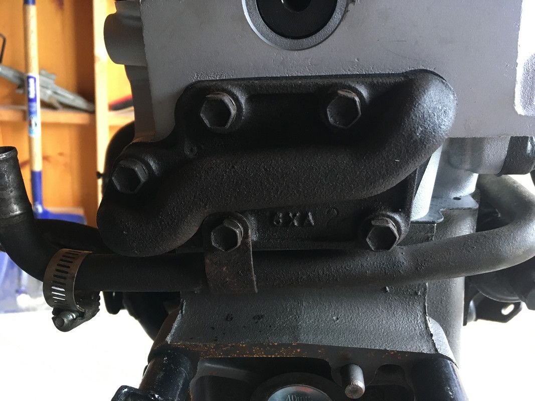

I've been chasing a coolant leak at the back of the 22RE engine for years. Sometimes it leaks, and sometimes not. I recently pulled it into the garage (2 minutes of operation) and after a couple days there was a puddle (1-2tbsp???) of coolant from having dripped off of the transmission bell housing. Garage is unheated, and was mostly around 48-55degF. Today I ran it in the garage for about 30 minutes, and no drips. Four hours later and no drips.
Ideas of where to look?
from 2024
from 2024
from 2024
from 2024
I'll check again in a couple days to see if anything feels wet, but it's tough to get a large hand in that area.

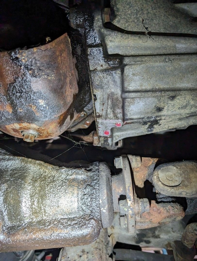

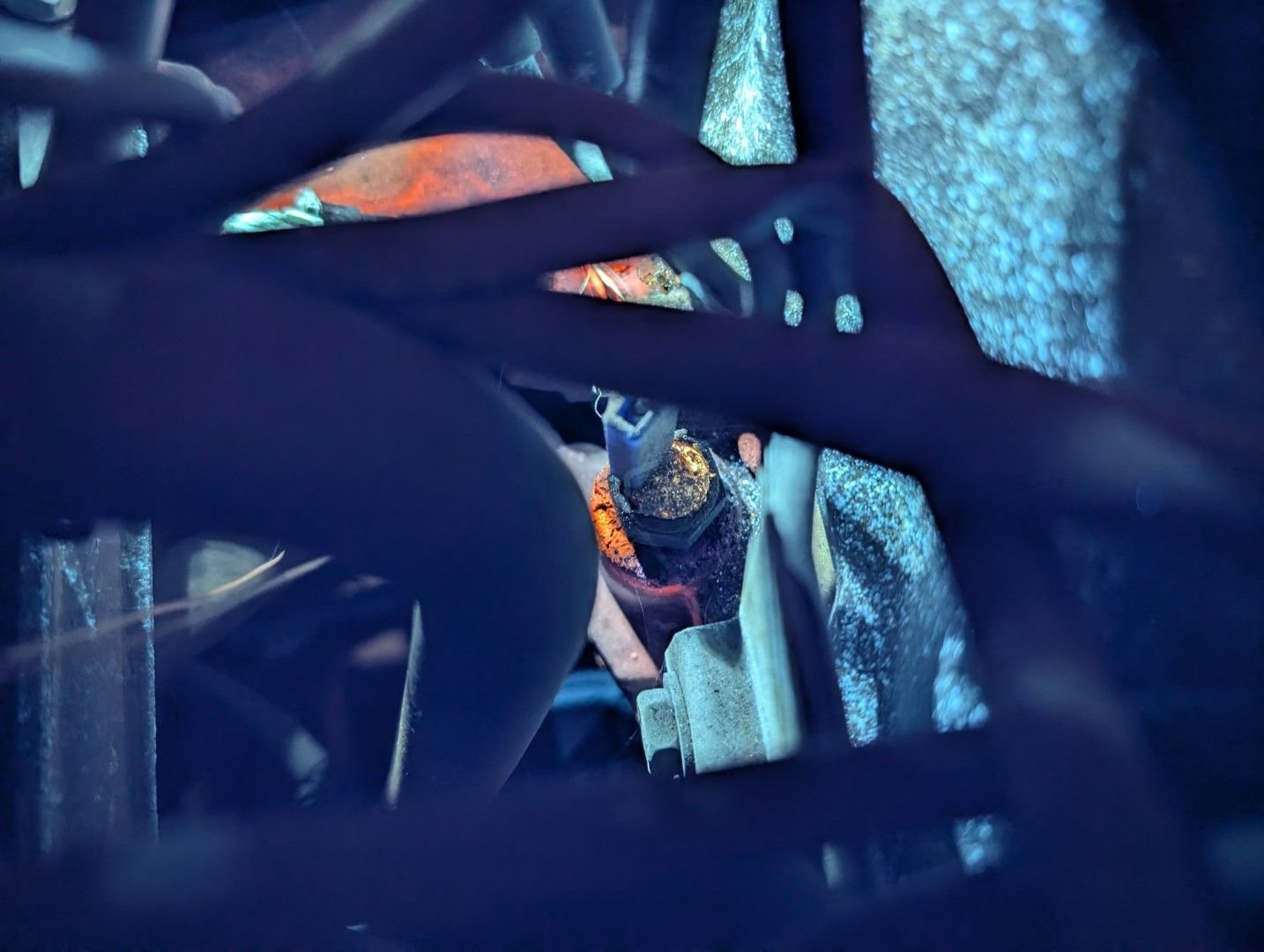

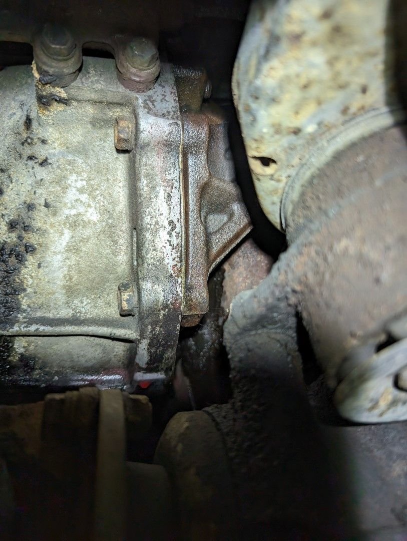

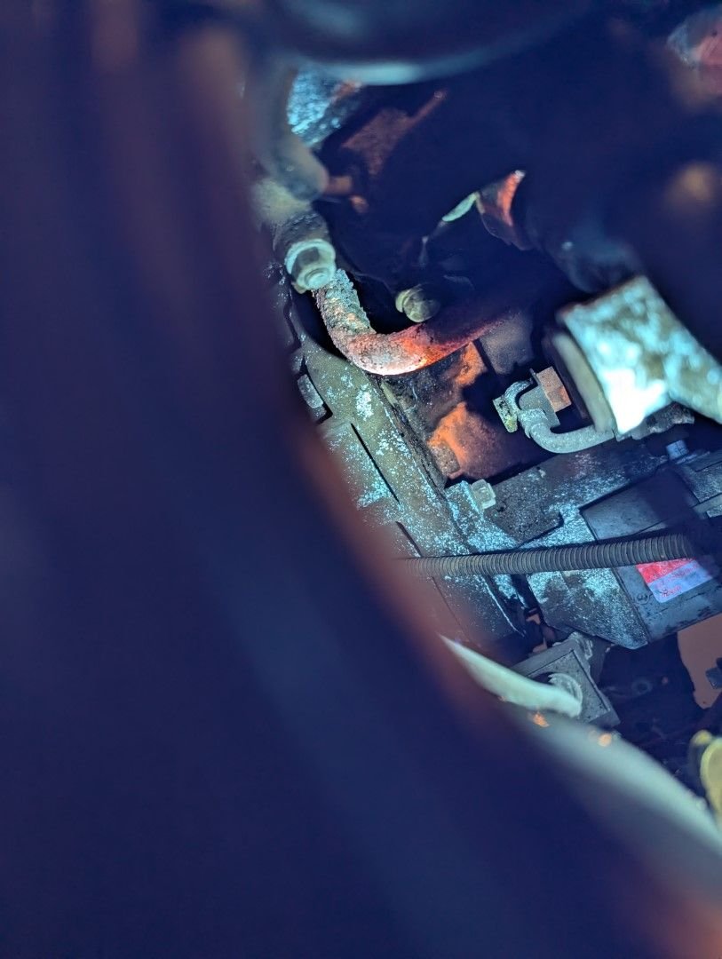

See pics using a UV light.
size of the puddle from running 2 minutes and parked two days

you might look at the back side of the block/head, where the egr cooler/bypass is. also in the photo is one of the freeze plugs at the rear of the block - it's inside the bellhousing when "mounted", so not fun to get at/replace if that's the source.
