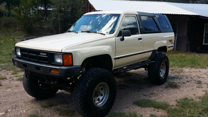

Hey guys, there's a very nice-looking 85 1st gen that I'm trying to decide whether is worth my dollars or not. Both the body and interior look to be in excellent shape, but it needs at a minimum the timing chain done, as well as new tires. Right off the bat we're looking at $2k+ incrementally over what I'd be spending for it, and then it's also geared all the way down to 5.71s and is also on a 7" Skyjacker lift which I suspect rides like an oxcart. So really we're looking at $5-6k incrementally to have work done on this thing to do the timing chain, put BFGs on it, go down to 4.88s or 5.23s, and potentially put a lift in that rides better on it. And of course you know that if we cracked the diffs, I'd want to put ARBs in there too.
My initial out of pocket won't be high for this truck but I can see a lot of incremental dollars down the road coming into the picture. I know these trucks are getting rare, but should I look for something that's more stock and has less stories, or would you consider going down this route? Truck in question pictured below. Thanks!

Cool find. Hard to give someone advice on such things. I do my on wrenching on most things, yet to do a dif. A 31 year old truck will need work, sooner or later. So price will jump exponentially paying some one else to turn wrenchs for you.

Anyone of the 3 trucks will need work.
The 2nd one looks pretty good.
The 3rd truck looks hacked with the rattle canned tube bumper
It all comes down to what you want. I like the 1st one, clean and you make get lucky and already have locker. ARB' s are gonna be $3-4k for both front and rear.
I look at project trucks as a hobby, over the course of the life of my 81 I knew I would never get out of it what I had into it (one reason I didn't sell it as a whole truck, a lot is being recycled to the 94) I could probably double what I have into the 4runner just because I got it cheap and have done all the work myself so far.

That's fair. Is there anything on the first truck that would make you walk away? If not, I think I'll drag it home and be excited about it.

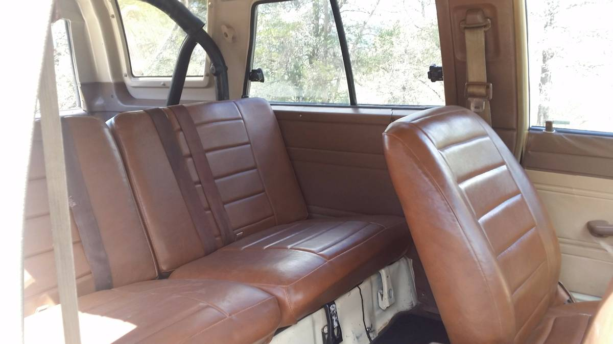

Looks like someone spent days cleaning the interior or never used the vehicle.

It looks like a clean truck.
I'd prioritize the needs:
1) timing chain now, because putting that off can get real expensive later. The parts are not expensive, and the work is not hard. My father did a timing chain and water pump on his old '86, and he does not have very much wrenching experience at all. He had a friend's help and a haynes/chilton manual. It took him a few days, but you said this wouldn't be your DD. (http://www.4crawler.com/4x4/CheapTri...ingChain.shtml)
2) do the tires NEED to be replaced? Mine are pretty worn, and I've "needed" to replace them for about a year. Still driving fine, just fails the ol' penny test. I don't have the spare cash right now so they'll keep driving until I do. If my tires go faster than I'm planning for them to, I'll buy some used ones to carry me as a stop-gap until I can do better.
3) suspension is a long-term thing, and my '85 factory suspension rides like an ox-cart. I can't imagine that lift being any rougher. Just my opinion though, I'd go test drive it and see if its just fine, if you can live with the suspension for a while, or if there's no way you'd drive the truck as is.
4) those seem like pretty tall gears, but those tires seem pretty tall too. My truck has factory 4.10's and 31's. I would not go any larger on tires without a gearing change or a serious horsepower increase - windy days have a direct and measurable effect on my highway speeds.
I personally like the look of that truck the way it sits - that looks about like the stance I'd like mine to have.
