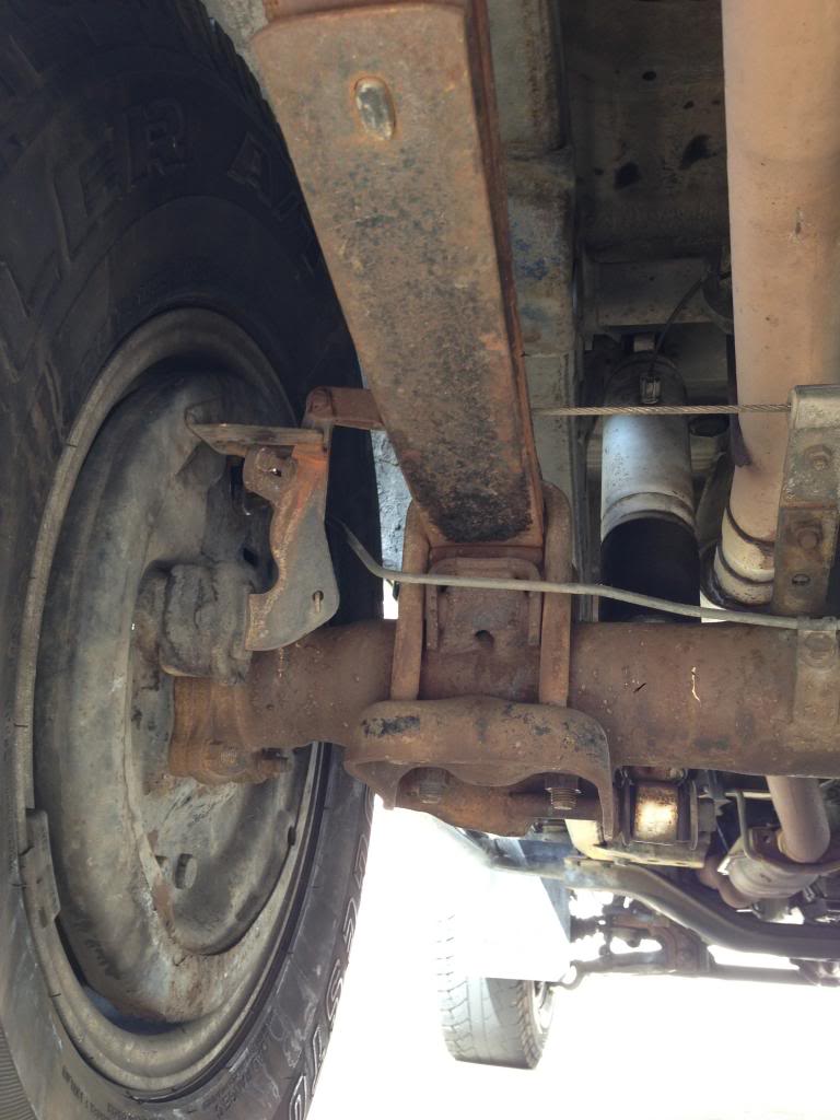

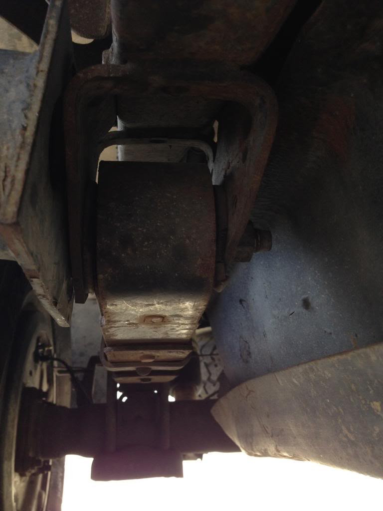

Take a long gander at the pic's again and then look at the diagram pic and if your (sure your still missing something), then your challenge of bull**** is just a moot point.
Old Apr 1, 2013 | 07:35 PM
  #42
Co_94_PU's Avatar
iTrader: (-1)
Joined: Dec 2012
Posts: 5,433
Likes: 555
From: Colorado

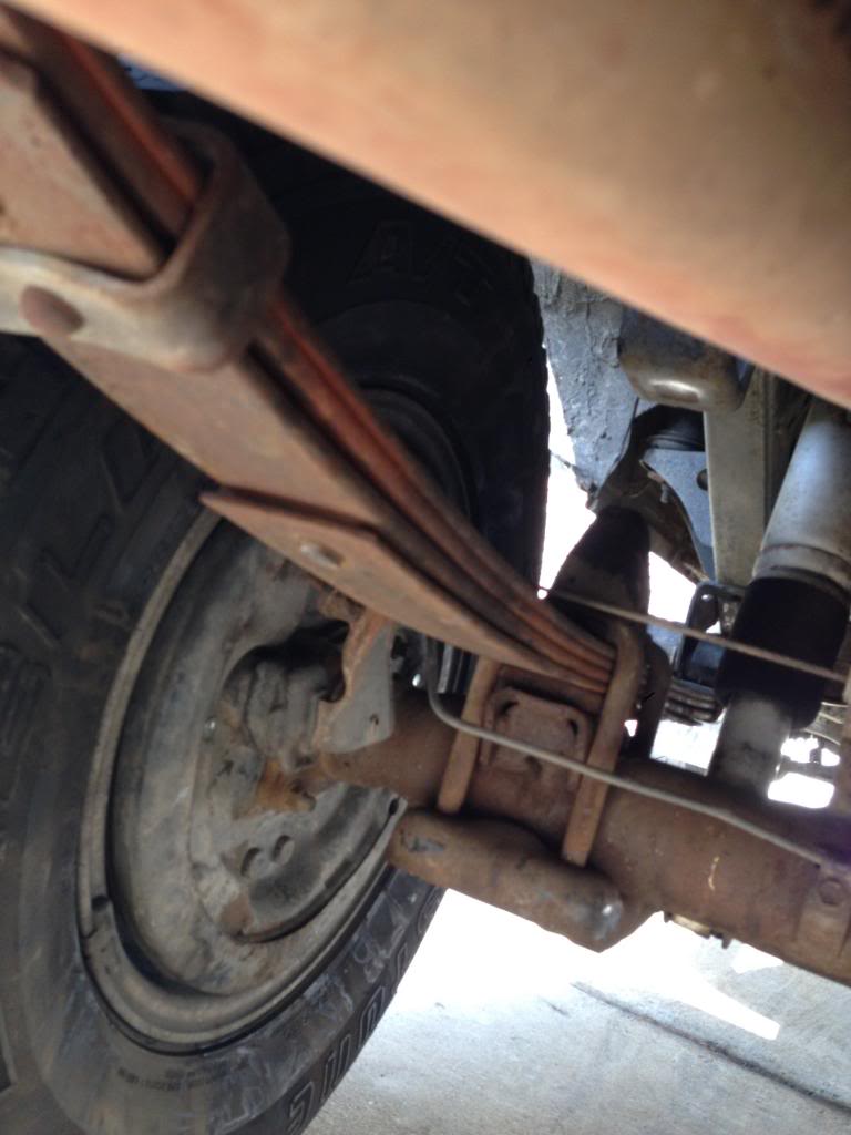

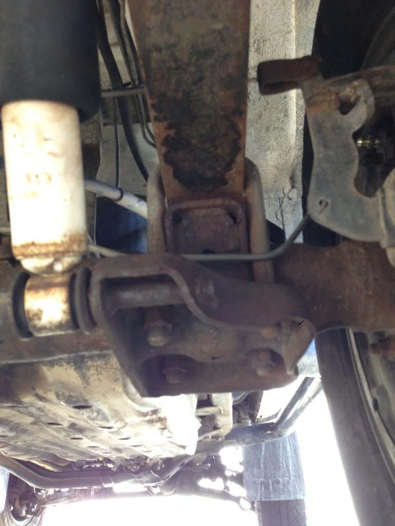

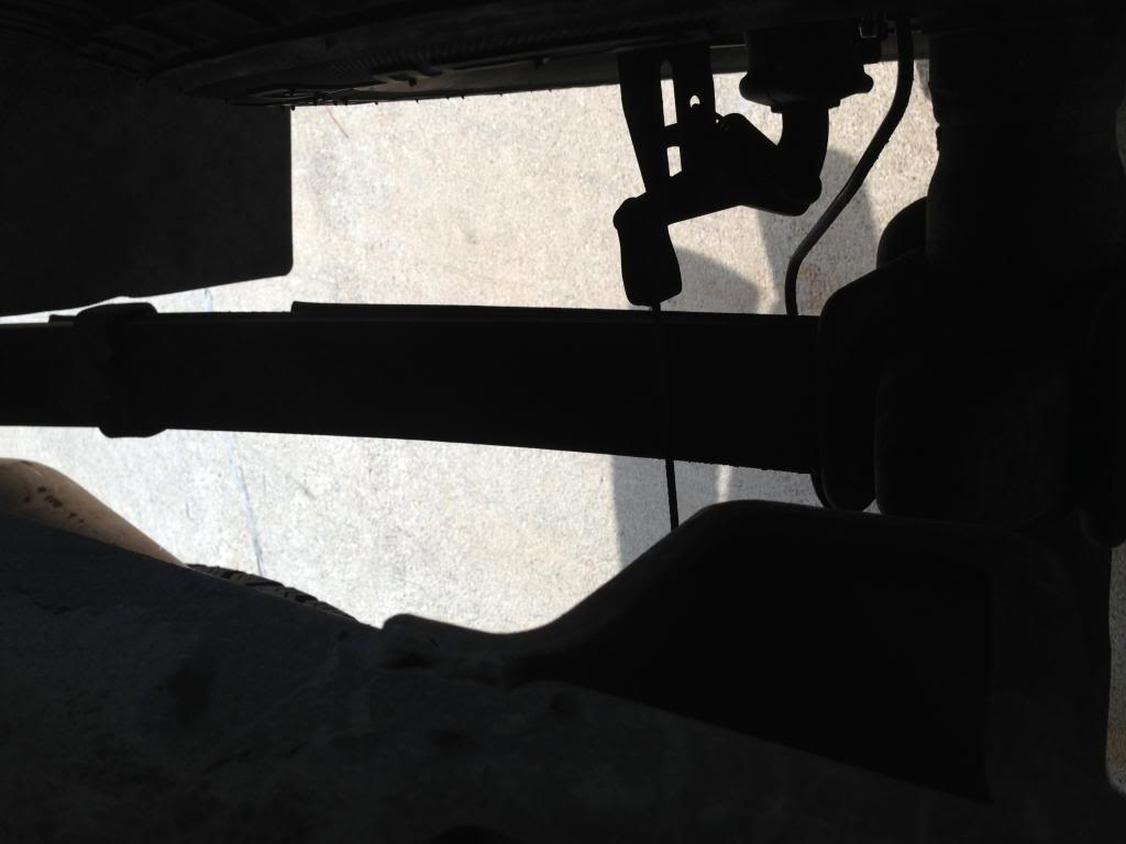

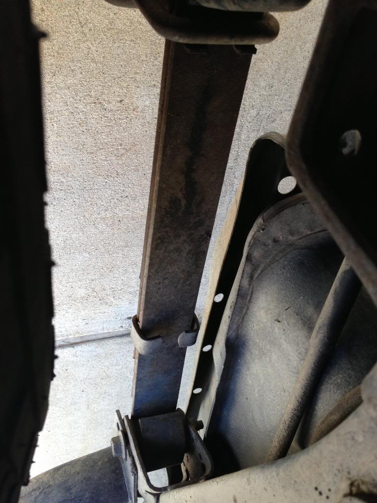

Diagram #1 is the 2wd, Spring under, note the "half wrap" location.
Diagram #2 is the 4wd, Spring over, note the "half wrap" location
And now that is clarified. Let me confuse you again!
My 94 2wd has none of those features and only 3 springs.
Then the springs are in correctly?

my point is i dont see a single spring wrap in any of those pics. which pic do you see a spring wrap in?
edit....ok after looking at the diagram again...i can see where reversing the springs would move the rear axle backwards like the diagram shows.
so basically the OP needs to make sure the spring wrap is in the rear and not the front......if.....his rear axle is on top of the springs and not sitting on the bottom. making sense now. sorry just trying to make sense of this so everyone else can too.

On closer comparison with the diagrams and my own truck, and those pics it looks to me like they may have used 2wd springs installed backwards... a lot of the extra clamps and stops seem to be missing from the ones in the picture... they might not even be toyota springs at all. If there was a picture showing more of the side/top of the spring it would be easier to tell... ie wheel off or shooting the left spring from the right side of the truck so we can see the full profile.

well with your diagram, it shows that if you were to reverse the springs, it would offset the axle towards the rear. which makes a whole lot sense. since the rear axle is sitting farther back than it should be. if the springs were spun around 180*...the axle should sit more forward on the springs. thus making it more centered in the wheel well.
the axle is sitting farther back.....which is also creating more drive shaft extension as well. yep you dudes are right. glad its figured out cause it was driving me nuts that i couldnt figure out why you were saying the springs were backwards

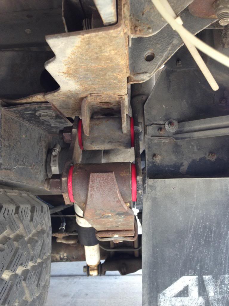

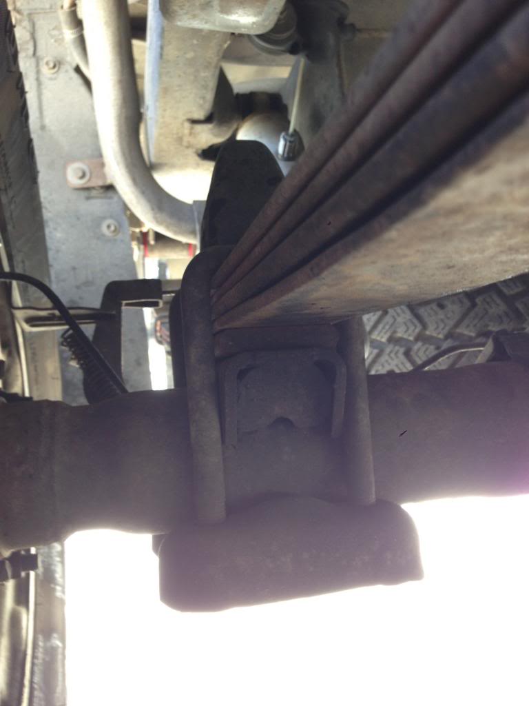

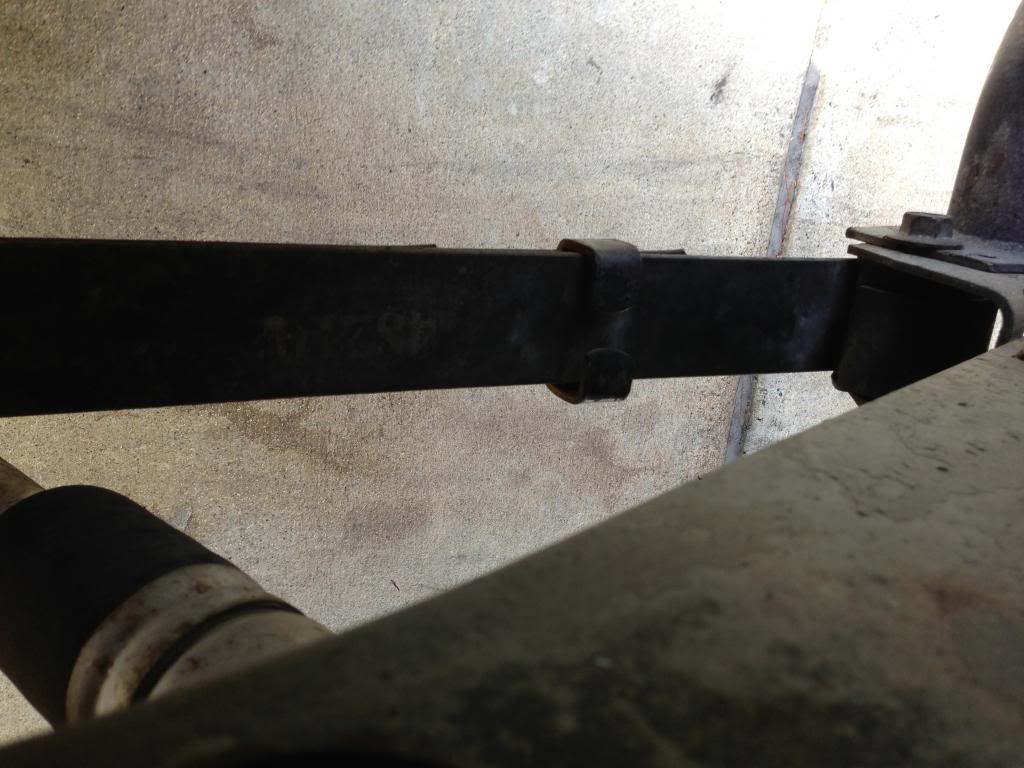

Glad you found it. Just to clarify we've been talking about the end of spring #2, not the "clip" parts in the diagram. The clips are multi function, the one on the overload keeps them aligned(not that the U-bolts don't..) and the others make the springs function as a unit during extension. The front end bend keep them from twisting, and reinforce the eyelet. The rear bend transmits the load onto the shackle pin instead of into the top spring(Eg. my "light duty" springs are flat and shorter than the top spring similar to the rear of the #2 spring in the diagram).
It should be mentioned above I think. But..
The locator "stuff" is more forward than the center line of the springs. This reduces the available amount of movement fore/aft of the axle assembly when used with the fixed forward mount.
My current thinking on the springs is they were sent out to be rearched, notice the bright shiney new rivet or whatever that is, and maybe they sent the wrong ones back to the install mechanic.
The 93 FSM has these dimensions between spring hangers, G-I
1250 (49.21) 2wd swb, 2wd 0.5 ton lwb, 2wd Xtra cab, 4wd swb, 4wd lwb, 4wd Xtra cab,
1151 (45.31) 2wd 1 ton lwb, 2wd Reg cab slwb
The 88 FSM. All 1151 (45.31)

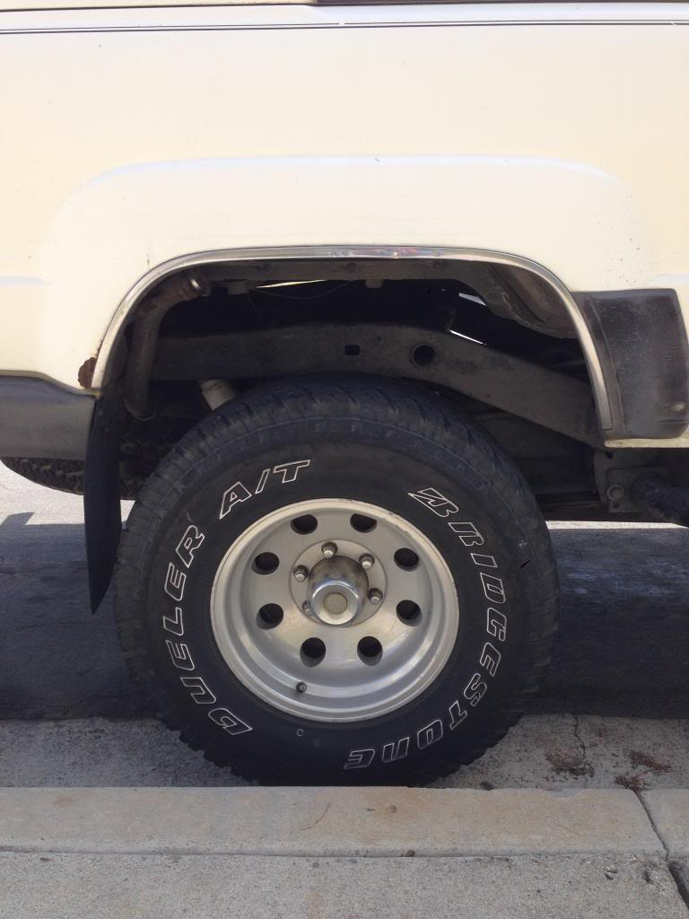

More brain twisters.. How are the axles looking so far off but then there are the bump stops that look like this.
And why did no one mention the gas tank fill tube hiding in the rear of the wheel well

Fill tube? You mean for the extra gas tank? It is connected to the tank, but the connecter is old and needs replacing, that's not from the shop. I did a closer inspection today and more pics. The rear appears correct, I have 4 springs like 4wd should have and the wrap around part is in front. I don't even think they removed the springs completely. I found that they didn't replace the front bushings even though I supplied them. I also measured distance from front spring bolt to middle of axle and it is supposed to be 20.67 and I got just a hair over 21. Also the u bolts for the axle mounts are slightly different thread lengths, and they are all supposed to be equal length. So the rear appears slightly out of alignment, but not horribly so. I also did video of the front, and you can see pitman arm hit inner body bumper. I don't know if that's cuz the aftermarket arms I got were different shape or steering box is off a thread. I'm still looking around for a quality alignment shop. Part of the problem with shops in the area where I live is reliability. I'm in North san diego, and there are quality shops that I could drive to but they are some distance away, and they charge more, and sometimes they don't let you supply your own parts. I actually know a few shop owners and they work good for certain things but all around high quality shops are few and far between locally. It's hard to weed out the monkeys from the mechanics sometimes.

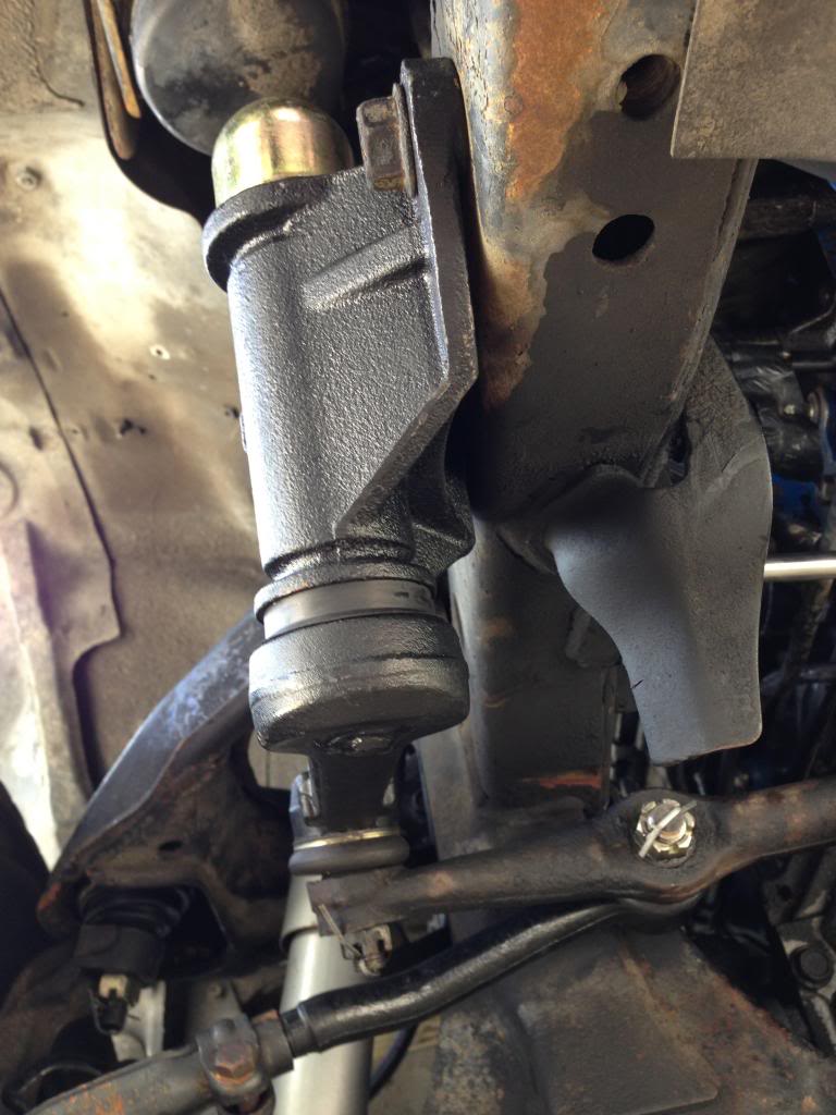

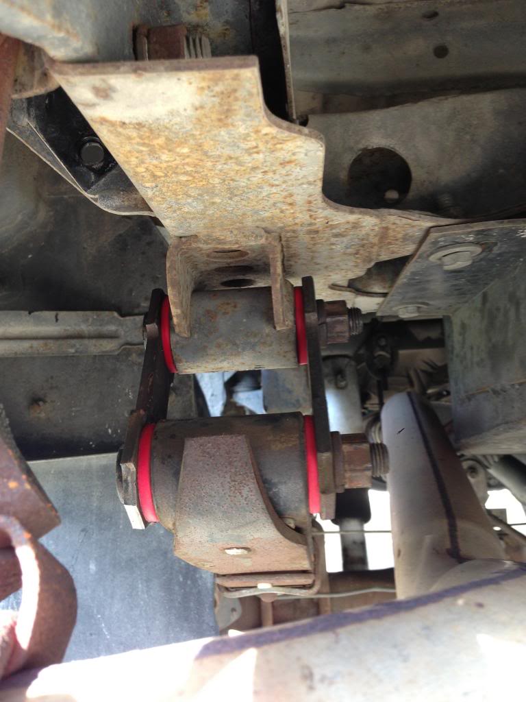

Aren't there three holes in the axel spring mount, perhaps they got shifted to the forward one.
I don't have photo shop installed to do some rough measuring. I'd say it's about 1-2" off center which sounds about right for those mount holes to of been shifted. That would also account for the Bump stop shifted to the front and the U-bolt length difference. Both of those attribute to it kicking the axel rearward.
The next issue (I'll tackle) the steering offset. The steering/alignment shop should be able to sort this but you can DIY.
Going to just by pass all the measuring and math, 'cause I don't wanna explain trig'.
Basicly what I think is going on is the drag bar is shifted to the passenger side.
Mark location of the split in the coupler on each side. Jack up the front end and adjust them. For every one turn lengthening on the right side you need one turn to shorten the left side. Try to get these as close to centered on the marks you made, it'll effect the toe setting if your off. Keep close track of how many turns! If you have to get an assistent cool, if not scratch thru mud and make tick marks on the frame or take a pad and pen with you.
Once you have the threads evened out it should turn an equal sized circle in either direction. My "Old man memory" says the right hand turns are supposed to be slightly tighter than left hand, just cause that is how the roads are designed, but centered is much better than "Holy crap I can't make a left handed U-turn on a 6 lane street!".

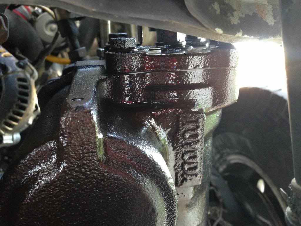

Latest Update: Got a rebuilt cardone booster and got that installed. Now the whole brake system has been replaced, the only thing original is the hard lines. Pedal feel is much improved and brakes work good and I can lock them up if needed but the only thing is the pedal engages a bit low imo, should engage within first inch. Parking brake works too. I'm gonna use the fsm to check on adjustments and such. It looks like the booster actuator rod that goes to bmc can not be adjusted and the backside rod that goes to the pedal is adjusted in as far as possible.
On a side note, as soon as I got it home I noticed a trail of fluid up the driveway. Turns out my steering box was leaking from the top middle nut it was way loose. Tightened it up and leak went away. I think this was from the retard alignment shop that initially did the truck they probably didn't tighten it good and it worked loose. Is there a specific torque to that one? I found a real good alignment shop that should be able to take care of the suspension issue, so gonna get it there in next day or two. Meanwhile, the day after the truck sprung a leak my car decided to have a coolant hose go, and they were conveniently located under the intake manifold. So that's my chore for the day, o the joys of owning older cars.
