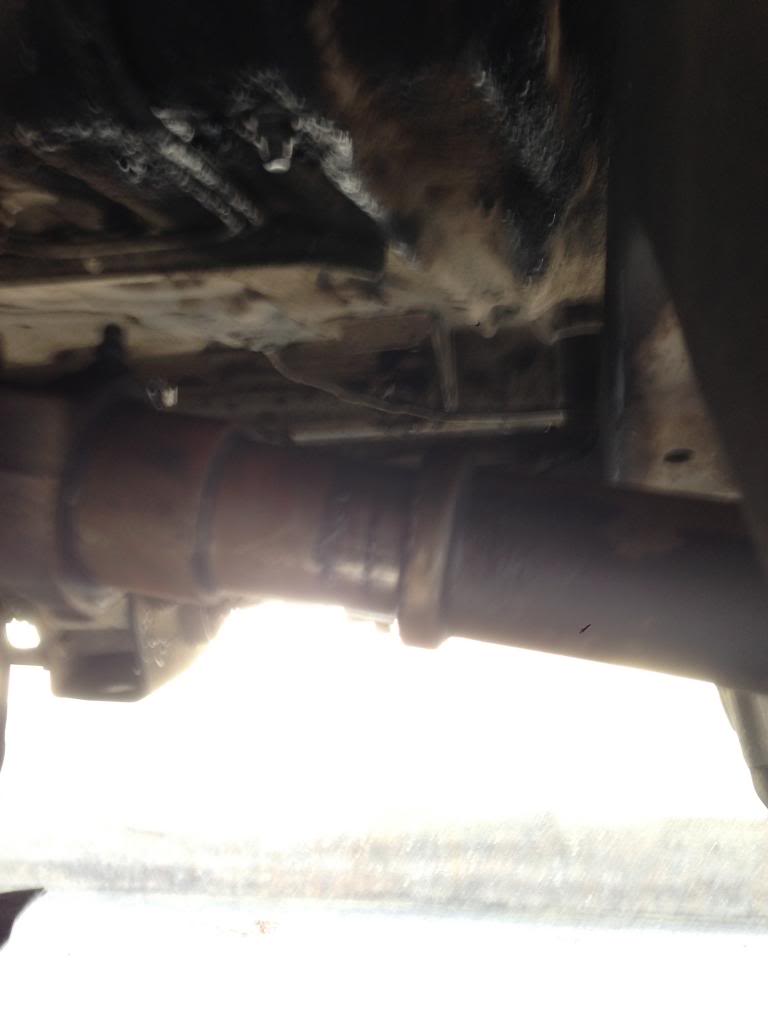

I'll have access to Mitchell and Alldata on Monday so I'll see what I can pull up but 30 hours is nuts, especially when it didn't fix much. I would be worried about the driveshaft, worn bushings can cause sagging and now that you have new bushings your truck doesn't dag so you see more driveshaft.

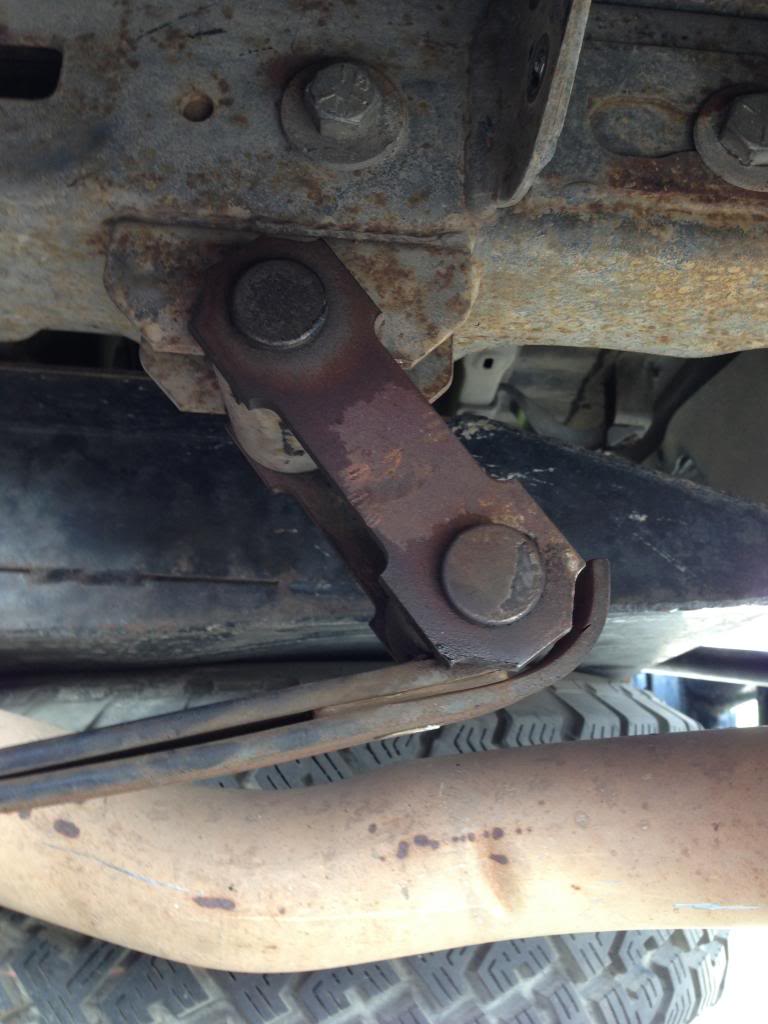

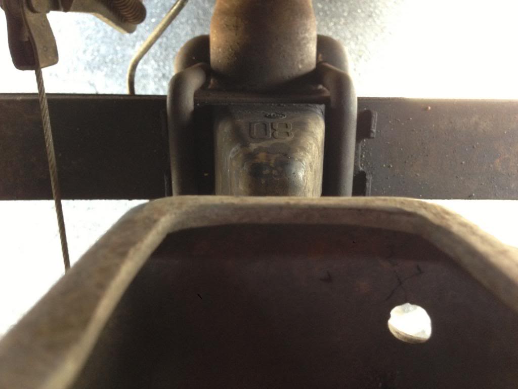

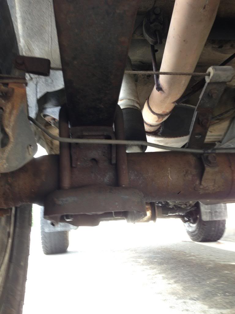

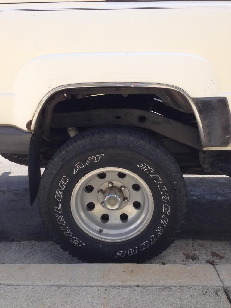

And yes that rear end definately looks uncentered. Also those springs aren't new, did you pay for new or reconditioned/used. Post a pic near the center and someone can probably tell you if they are the wrong pack assembly(too many too few).
Waiting to see what you guys with time estimates come up with. Personally I don't think it's to far out of the ball park, but agree its probably got some overlap and might be a little high.

PS. I think you're missing a leaf or two and they put the springs in backwards. Should look like this diagram
X2 they sure look like there in backwards, also maybe just can't see other leaf's- (are shorter) as pic shows more of the shackle.

The rear is def. off center badly... they are def. in bassackwards... idiots in that shop have no clue what they are doing. Probably had an apprentice doing the actual work... what part of the world are you in? maybe one of the members can recommend a shop near you that actually knows what they are doing.

Originally Posted by maachine
just out of curiosity......with those pictures, how can you tell the leafs are on backwards and the rear axle is out of alignment? i cant see it.
Easy... you can see from looking that the rear wheel is not centered in the arch of the fender. And the picture of the springs shows that the 2nd leaf with the wrap over the main leaf is on the front hanger when it should be at the rear with the shackles. This is why the axle is out of alignment... the axle on our trucks does not sit in the center of the leaf pack like a trailer but rather off center towards the front of the pack... this is the case with many vehicles actually,,, it is why the spring packs are often marked in some way to indicate which end goes forward.

i still dont see any wraps around the springs that shows front or back. i do see where the tire is sitting off center from the wheel well.
