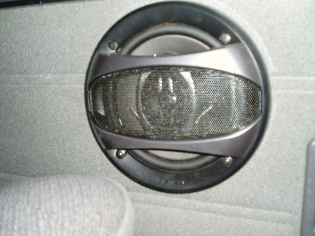

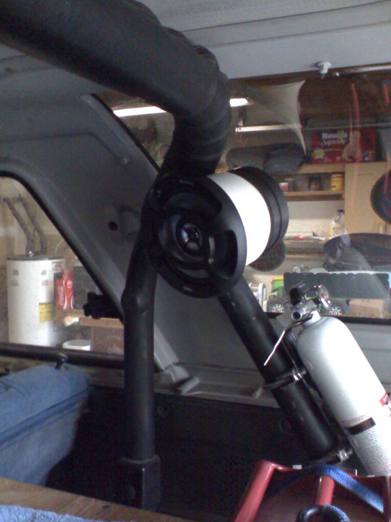

About the speakers....... The PO cut speaker holes into the rear seat panel........
Well the edges weren't cut great, the screws are barely hanging on, and you can't hear the rear speakers when they are mounted there, and its even worse when they are mounted in the cargo area.
My plan? I am gonna track down some new panels and then try this manuever.....
The rest of his write up is here.
https://www.yotatech.com/forums/f96/...eakers-210463/
I heard them in person, they sound really good. I didn't get to listen to them with the top off, but they were already better then the stock location, and it keeps the panels from falling apart.

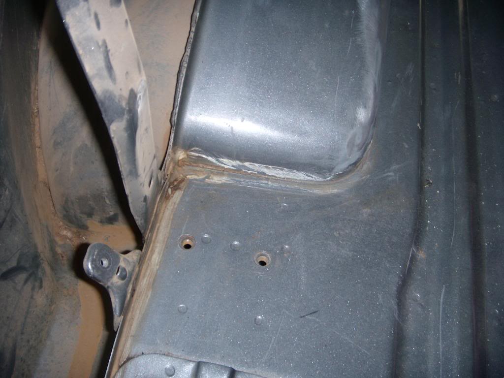

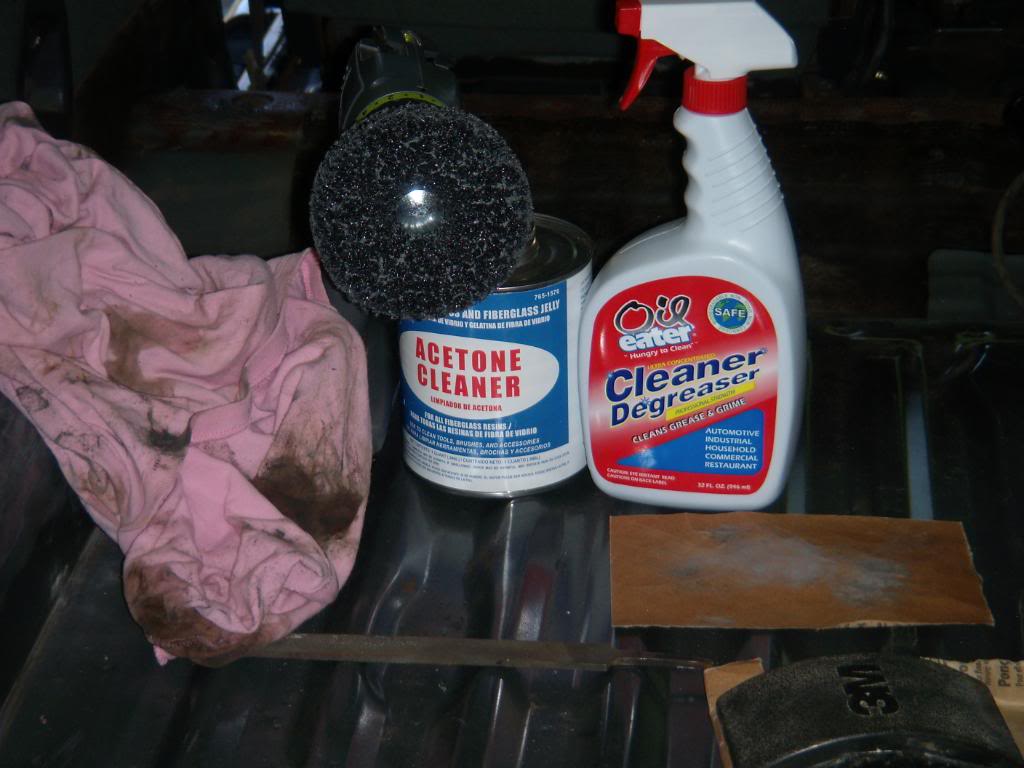

So I started prepping today. Got all the supplies I think I will need. About 15 bucks through my work.

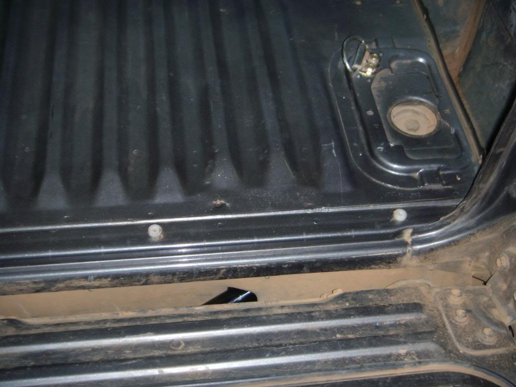

There is some sticky stuff on the wheel bump that took a while to get off.
Now im wondering what you guys think I should do in these types of area around the corner and the edges.
there is some modling (like caulking) around the edges and the wheel bump thing. Shouuld i get rid of it all, or just clean it a little and put the liner over it. It will be easy going on the bed itself, just a flat level surface. I'm just not sure how I should go up to the edges and other curved surfaces.
I also plan on masking off any whole and bolt holes. Also, should I go over with the liner where the roll bar bolts down, or just around some edges. Sucks because I woke up early to get this done today, but %&*holes at work called me in to work at 12 to 5. Nice and smack in the middle of my progress

If I were you, I'd remove all the rubber drain hole plugs, and the bolts that hold the D rings/tie downs, and line the inside of the holes with blue painters tape to protect the threads. For the roll bar...not sure how easy it would be for you to get out with the top still on? I'd removing it, but then you don't want to cover where it mates up to the floor, as it would not make a level mounting surface...hmmmm, got me on that one!

Spend the extra time cleaning and prepping. it will pay off.

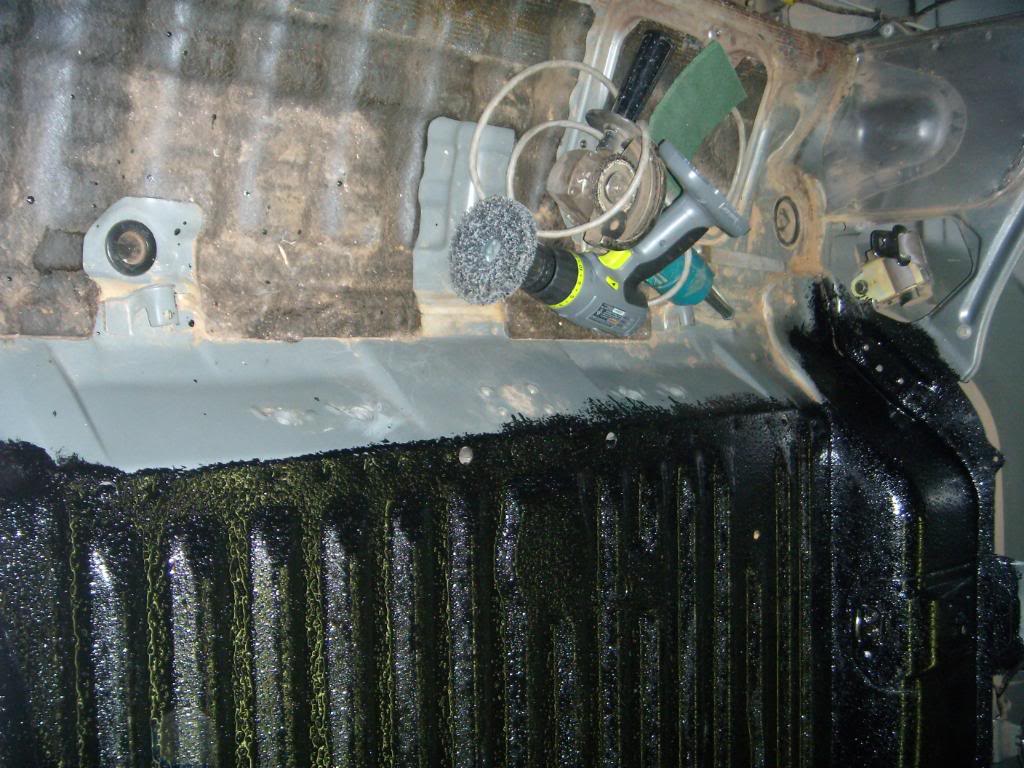

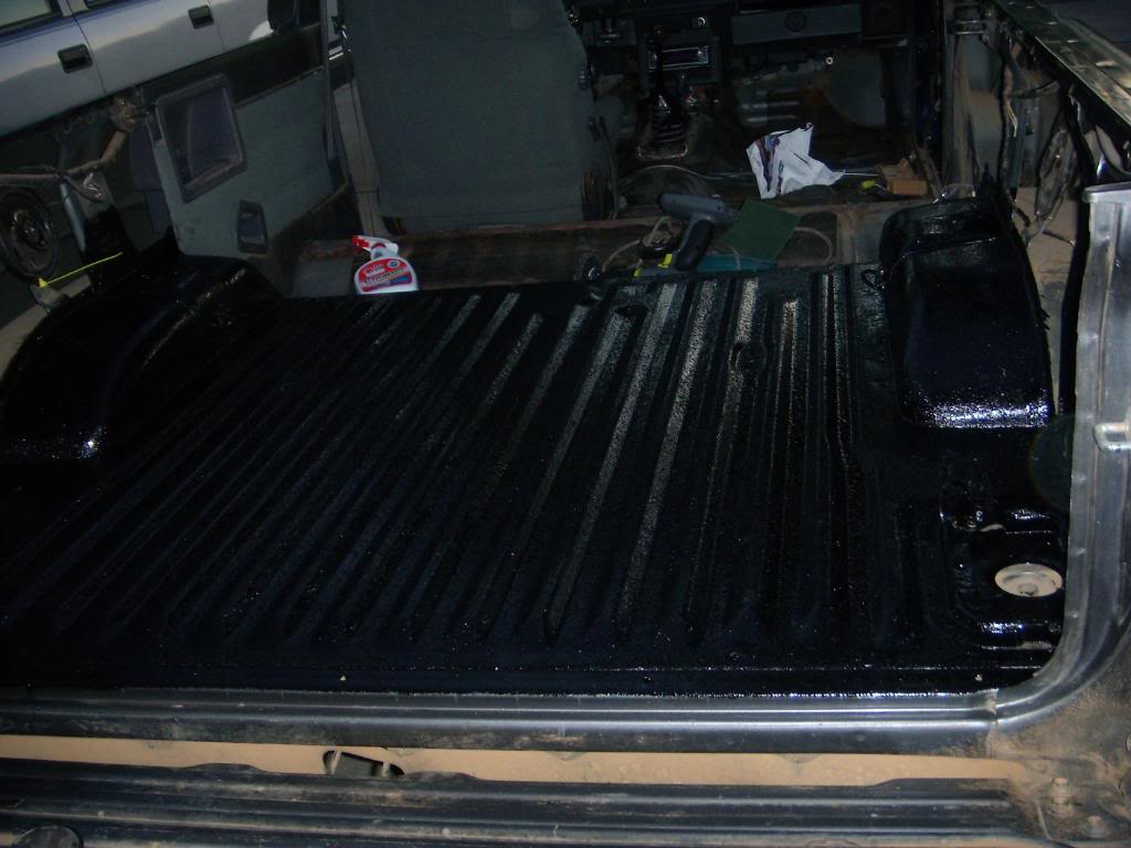

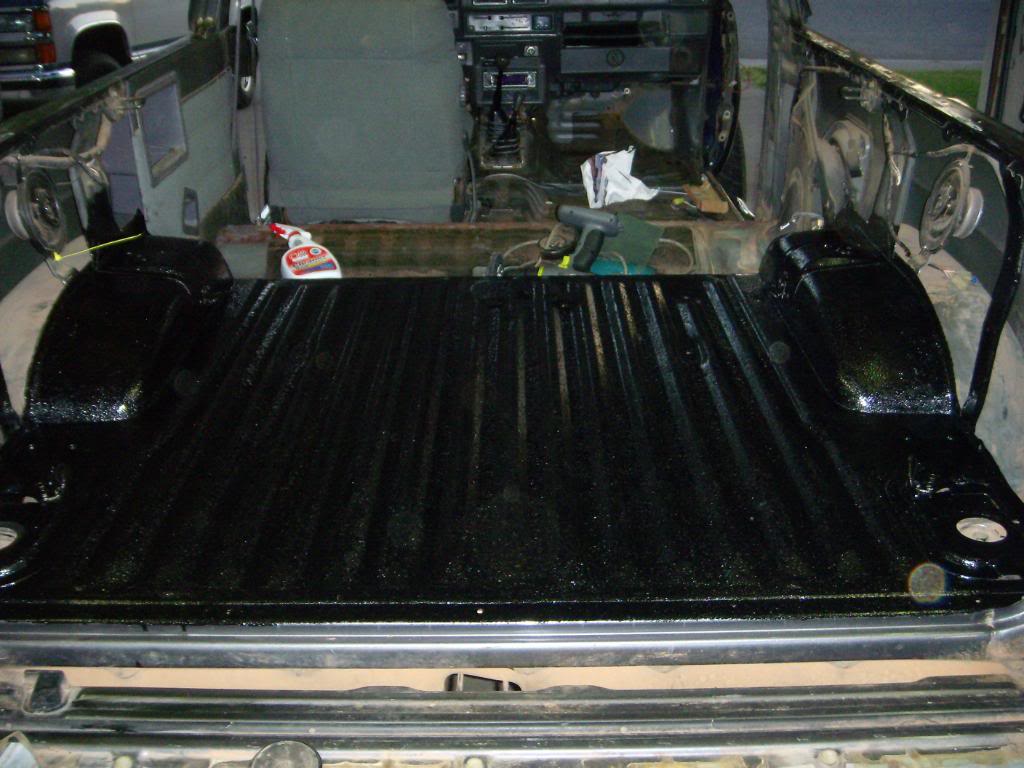

So this is how far I got in about an hour.
I started with the corners and edges first. Then did it in halves. I'm an idiot and didnt tape off any bolt holes. I think the only problem this will be for is the roll bar. I'll find out if that's a problem or not down the road...
Damn this stuff is messy!!!!
I stopped here.
That's where the rear seats will be. That is going to be a lot harder to clean and prep. I am trying to think of a way to fill in the bare spots where there is no sound dampening matts to make everything even. I am going to clean a small spot on one of the mats and put a thin layer of the liner on there to see if it will stay or not.
I am not sure if I am going to line the front area where I will be driving or not. I might throw the carpet back in there. Not sure at all.
Also, I guy that comes into my work a lot was showing me what he did with his quarter panels. He just had probably 1/4 inch ply wood and made his own. It looked good and he said it was easy because it was straight and he didn't follow the way the factory panels curve near the tailgate. He didn't spray paint his though, you guys think if I made my own and sanded one side and sprayed painted that side they would look good?
I stopped here.
