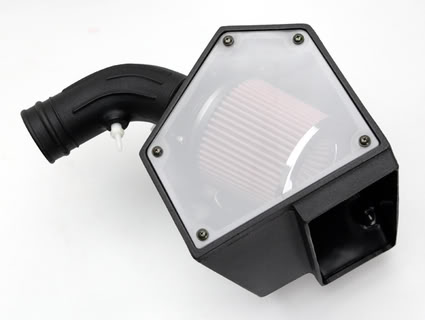

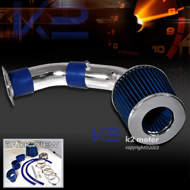

The trouble with DIY is adapting the AFM inlet to a round pipe or filter opening. Most ISR mods re-use the air box for that reason.
I wanna buy this first kit just for the adapter. But for $40, what you get is just as good as the ISR mod I did, plus you get the better filter. They sell red or blue.

Yeah, the trickiest part of the ISR mod is finding or fabbing and adaptor to fit the VAFM to the filter. I used some plexiglass, a 4-3" reducer and some screws and epoxy and it's still holding up perfect but took a little time. not all that hard though. My biggest concern with that kit ^^^ is that it's metal and will really up the intake air temps compared to stock intake or plastic pipe. of course you could wrap it also with some heat insulation. put the chrome tube in my taco and it got hot and stayed hot reeeeeally long after shutting the engine down. I used some insulation and alumninum tape but I want to go to plastic tubing.
