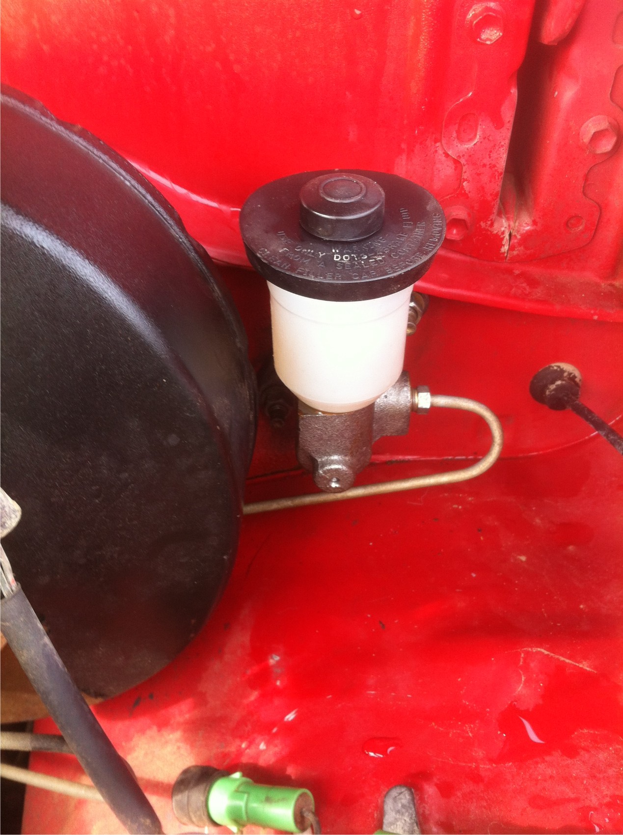

Can someone take a look at this image I've attached and let me if there's a way I can reverse bleed this?

Not sure what you've seen on line, but the reverse bleeding we used to do for single engine airplane brakes, which should work for the clutch, is as follows:
- Get a large, pump operated oil can. Make sure it's squeaky clean and fill it with brake fluid.
- Find a length of clean hose that will fit tightly over the output nozze of the oil can, and also fit tightly over the bleeder valve. Clear hose makes it easier to see what you're doing.
- Attach the hose to the oil can and pump until a clean stream of fluid comes out free of air bubbles.
- Now attach the open end of the hose to the slave bleeder valve.
- Take the top off the master reservoir and use a syringe or turkey baster to empty most of the fluid out of it. You're going to be filling it from the bottom.
- Crack open the bleed valve, and pump until you see no bubbles coming up into the reservoir (takes two people). You might overflow the reservoir, so make some provision for catching the mess.
- Close the bleed valve, top off the reservoir, and you should be done.
- Make sure you don't run the oil can dry, or you'll have to start over.
When done right, it's an almost sure-fire way to bleed the system with no remaining air bubbles. It relies on the fact that the trapped air would rather go up than down through the system. Any air bubbles get pushed through the slave cylinder, up the tubing, through the master cylinder, and out into the reservoir where they no longer matter.

What I saw online was a guy disconnecting one of two lines coming off the master reservoir (they were side by side, but now I'm questioning my memory on what I actually saw, lol). He screwed, I believe, a 10mm bolt into it with plumbers tape on the end. This appeared to seal it so that when he pumped the clutch it forced the air bubbles out the reservoir. Made sense I guess, but my reservoir only has one line coming out of it.

Does this sound like air in the line? Should I go ahead with the reverse bleeding technique?
I'm just confused, I didn't expect there to be so little pressure in the clutch. Something just doesn't seem right, but then I'm not a mechanic either.
Thanks guys for any advice,
I've been reading a lot about having someone watch and re-fill the reservoir while another person pumps the clutch as I loosen the bleed on the slave.
We did this quite a bit and a lot of bubbles came out with some black puffs of fluid once and a while. The pressure seemed to be building up some and has maintained a little more than previously, but still not enough to allow the gears to shift.
Any ideas, am I on the right track here, do we just keep doing it?
It just seems as much as we've done that technique all the fluid would have circulated by now pushing out any and all bubbles. That doesn't seem to be the case though.
Also, the slave cylinder rod is not traveling but maybe 1/2 inch. Would this eliminate the possibility of it being internal issues like the clutch fork?
I also just adjusted the rod on the master and clutch pedal which gave us more travel/pressure than previously but then we bled it again and lost it. Back to no travel or only a half inch. When I adjusted the rod it gave us about 3/4 inch travel on the slave but still not enough to be able to shift gears still.
I'm getting lost here, lol. HELP!!

Just what brand parts did you get some can be complete Junk from new.
If they were used they might be worn so hard they will never work.
Bleeder valve sucking in air
If the person went cheap that could be the problem.
Then part of the problem could be your rubber hose blowing up like a balloon under pressure lots of people never think to change them.
If they don`t leak why bother is the theory of some.
I always change the hose and don`t have any problems bleeding clutch hydraulics

PLEASE STAY AWAY FROM PARTS STORE CLUTCH HYDRAULICS!!!! I have had nothing but bad luck with either clutch master cylinders or clutch slave cylinders.Put those parts on(Advance Auto Parts) and could not bleed the air out.Got a clutch master from Carquest and bled the system in 5 minutes!If i could of waited i would of used Aisin parts for the clutch master and slave.Also a good idea to replace the rubber hose as it is approaching 30 years old.Good luck with it and i'm sure many others have experienced this.

Thanks Wyoming and Mainetoy for the help. I had my fingers crossed someone would jump in here.
If any I think the master the guy put in might be junk. It just seems sloppy, a lot of play and movement.
I will replace the hose next and get another master. So you think from Carquest is ok?
Also, because of the lack of travel in the slave would that eliminate the clutch fork as being the issue?

Lets hope so on the clutch fork.
I would use Aisin hydraulic parts if possible .
I might almost think about the Toyota Dealer I know they are expensive but peace of mind most times is not cheap.

I got mine, by doing what I described, to 3/4 inch (basically) but still not enough to enable shifting. Then we bled it traditionally(pump, hold, bleed) one more time and lost that distance, back to 1/2 inch. Which I don't understand either. You tighten the bleeder before the clutch is released right?
Posts: 13,381
Likes: 100
It is possible the bleeder is bad allowing air to be drawn in .
Your connection at either the Master or slave is not sealing like it should allowing air to be drawn in.
All it takes is a spec of dirt /grit whatever to keep it from sealing
It will not leak fluid but can draw in air.

So I pulled the master that was purchased from O'reilly's out and slapped one in from Carquest. I would have liked to get the better one from online but for $25 I figured I'd try this one first and just get er' going. IT WORKED!! LOL
It's hard to believe a brand new part from O'reilly's can really be that crappy but apparently so.
Once I put the new one in I bled it from the slave and everything was fine. Just opened the bleeder, pressed the clutch a few times with a hose running off of it to a bottle of brake fluid. When the bubbles stopped I closed the bleeder and that was it, done deal.
For the record, I was getting about 3/4 inch of throw from the slave with the O'reilly slave, 1 1/2 - 2" with the new one from Carquest.
