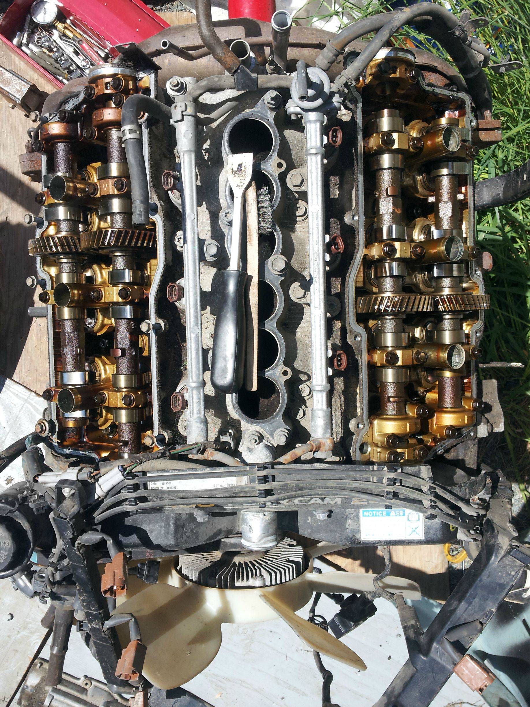

Posts: 39
I will pay for creative input with pictures of the swap!!

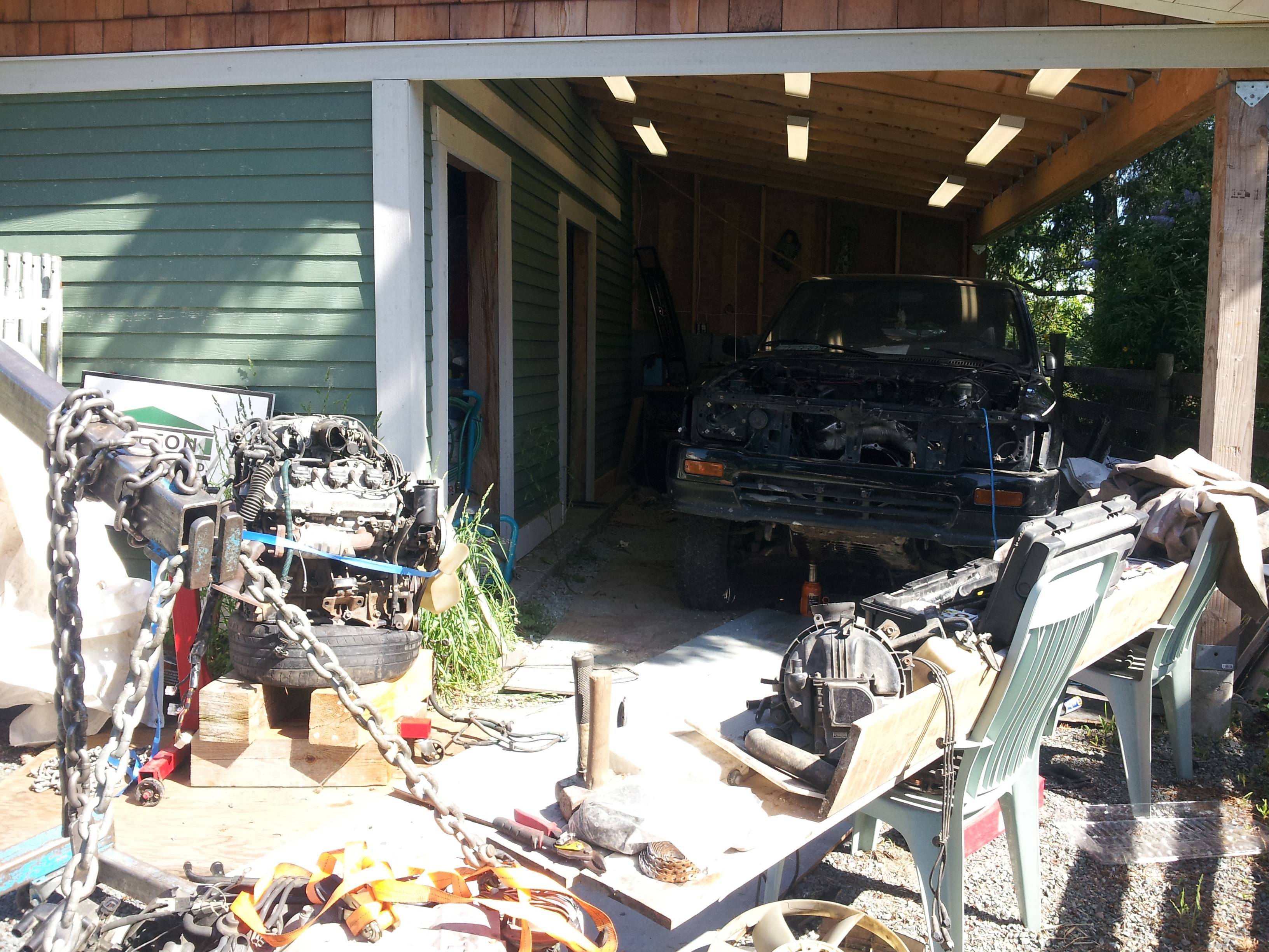

guy at the shop says i also need to use the 3vze's flywheel/clutchpack/ect.
Is that true? that's not what i read...

I used all 3vz parts on mine. You can use the 5vz flywheel, pilot bearing and clutch. If your using the original 3.0 transmission you need the 3.0 throw out bearing.
