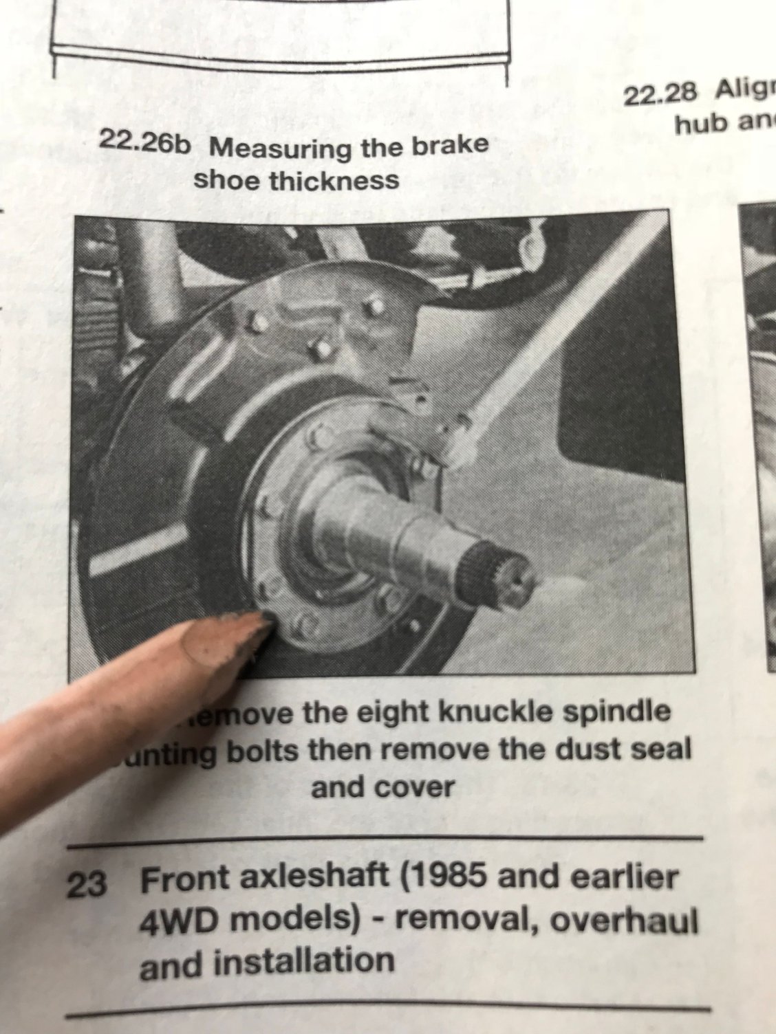

Another part finding question. I can’t seem to find a replacement for the spindle dust seal. I remember when I did my brakes a few years ago the dust seal was cracked and I needed the truck so I just assembled it. I want to fix it now. This is the seal I’m talking about. I’ve seen it called a dust seal or also an oil seal.
Any help would be appreciated.

Ahh, this is crazy. I haven’t had a chance to drive it since I dropped the truck after cleaning it, but I’m just now at the Advance Auto parking lot and the noise is gone. I went over a handful of big bumps on the way here and speed bumps in this parking lot and nothing! This is weird. I suppose removing the wheel and reinstalling it *could* have done something, like maybe the wheel wasn’t fully torqued and now it’s good? I’m still doing the axle, but this is really strange.

My notebook says this dust seal is national 710266, but I've never replaced one so I cannot say 100%
It is not inexpensive, no matter where you source it.

Thanks Millball, I see prices from $14 up to $50 for that part, haha. Most of the eBay listings show it as a 93-98 T100 part, though. Could still be the same part. I’ll have to do some more searching, but thanks for getting me going what seems to be in the right direction.

Called my local dealership, game him my vin, and he said the part number is 90313-93003. I found it on FJParts.com for $24 shipped instead of $65 from the dealer. I ordered it already because I want it soon, but does this part make sense to you all? Hope this FJParts website is reputable and the part comes quick.

The correct wheel seal is the Beck/Arnley 052-3487
RockAuto has it for like $20.
The dealer gave me the part number in the above post which is wrong for my truck. It has 8 mounting holes where I need 7.
