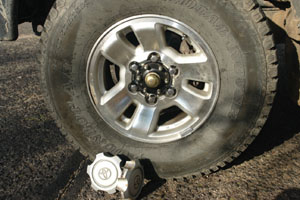

Hey all-
I'd like to pick the collective brains of those out there who know more about Tacoma/4Runner Chou Seiki alloys than I do. I installed a set of 15x7 alloys on my '93 4WD 4Runner w/auto hubs from a '98 2WD 4Runner. The problem: the center caps on front are too shallow and don't fit. The size stamped inside the '98 2WD wheel is J15x7JJ. I noted a '96-'98 4WD Tacoma today w/ alloys that had T15x7JJ stamped inside. A different wheel for 4WD vs 2WD? I inquired at Desert Toyota here in Tucson but they were useless - no help at all. Does anyone know if a deeper 4WD center cap exists? Should I modify/cut out the center? All recommendations welcome...
Bryan
