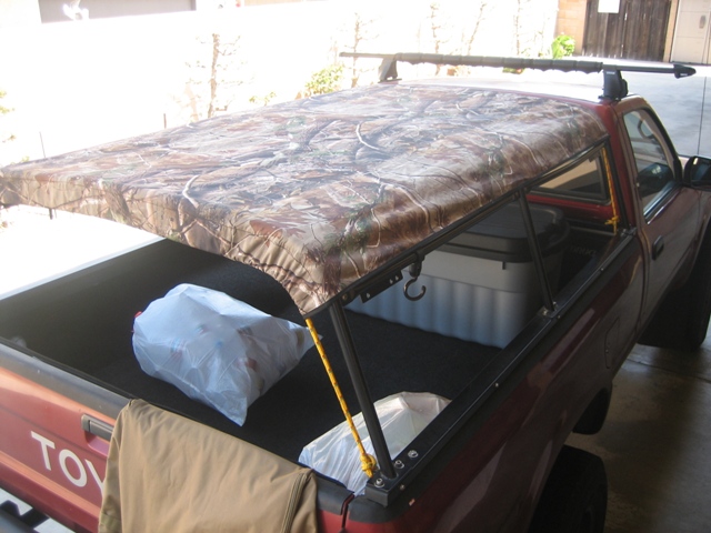

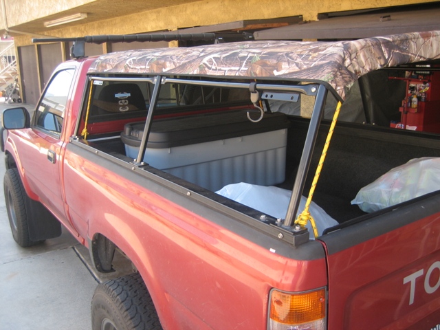

You can play with some less expensive material. I'm using this stuff treated with 303 aerospace fabric guard to see how it holds up. I think it was around $10 a yard. "Realtree APG" AP 60" Wide Denier Urethane Coated Cordura, Waterproof - Outdoor.
I already have a sunbrella canvas top that came with the canback, so I wanted to try something different and I like the camo pattern. It's significantly thinner than the sunbrella stuff, and I don't have enough experience (time) to say how well or how long it will hold.
For your final product I would recommend sunbrella material treated with 303 aerospace fabric guard.
There is also sunbrella edging material, there's a specific name for it but forgot. I would recommend using that stuff also so it doesn't fray. You can see I used it below (it's the black edge stuff sewn around the whole thing)

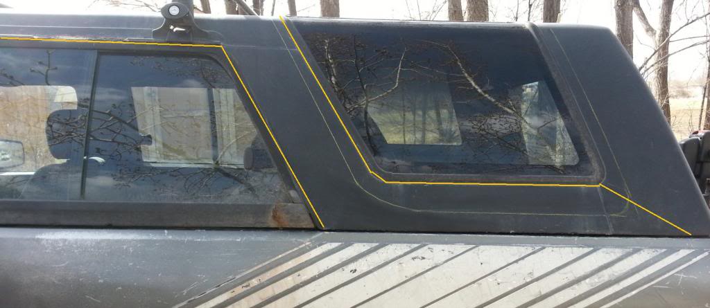

Got some pics today. I'm playing with two different ideas:
Here's one version of #2:
And here's a view of the roof with both short & long sunroof ideas roughly sketched in:
Of the two ideas, I like #1 more, because it's removing significantly more weight than #2 does, and it's still long enough to use the roof rack. I haven't looked at the shape of the underside much to see what structural ribs are there that I should consider. I like the idea of reinforcing the cut areas with flat or angle stock to keep it from flexing too much.
- chop the top just behind the opening for the slider windows so that it's a half-top, and cut a medium-big sunroof in the part I keep; or
- just cut a gigantic sunroof in the top but keep most of the fiberglass on the sides and remove the windows.

#2 has an interesting T-top look to it, but i prefer #1.
#1 is less fab work to make it reattachable, and allows the most cargo room. I'd center the cut in the first photo for symmetry and mounting reasons(more roome for a flange and clips).
For the "sun roof" you might want to consider using the size and shape of the fixed body one, this way you can go glass easy. Maybe poke around at the salvage yard for one a little larger.
If you extend the cut in #2 down to the bed frame you could fab a rear wall that would allow rear passengers not to bang thier heads(I think).
Anyways just one guys ramblings
Keep us posted, looking forward to the progress.
