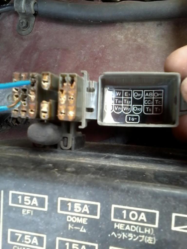

A paper clip will work or small wire. Jump TE1 and E1 and count the number of flashes and look up the codes. You will need the codes for 85-87. 88 and up use different numbers.
85-87 Codes
Code 1 System Normal
Code 2 Airflow meter signal
Code 3 Ignition Signal
Code 4 Water Thermo Sensor
Code 5 Oxygen Sensor Signal
Code 6 RPM Signal
Code 7 Throttle Positon Sensor Signal
Code 8 Intake Air Thermos Sensor Signal
Code 10 Starter Signal
Code 11 Switch Sigal
Code 12 Knock Control Sensor
Code 13 Knock Control CPU

Count the number of flashes? What flashes when you jump the pins?
Old May 8, 2012 | 08:44 AM
anthony1's Avatar
Joined: Oct 2003
Posts: 1,561
From: torrance, CA.
The check engine light flashes.
You just turn the key on after you connect the jumper. don't start the engine.
To clear the code, just remove the EFI fuse on the mail fuse box.
