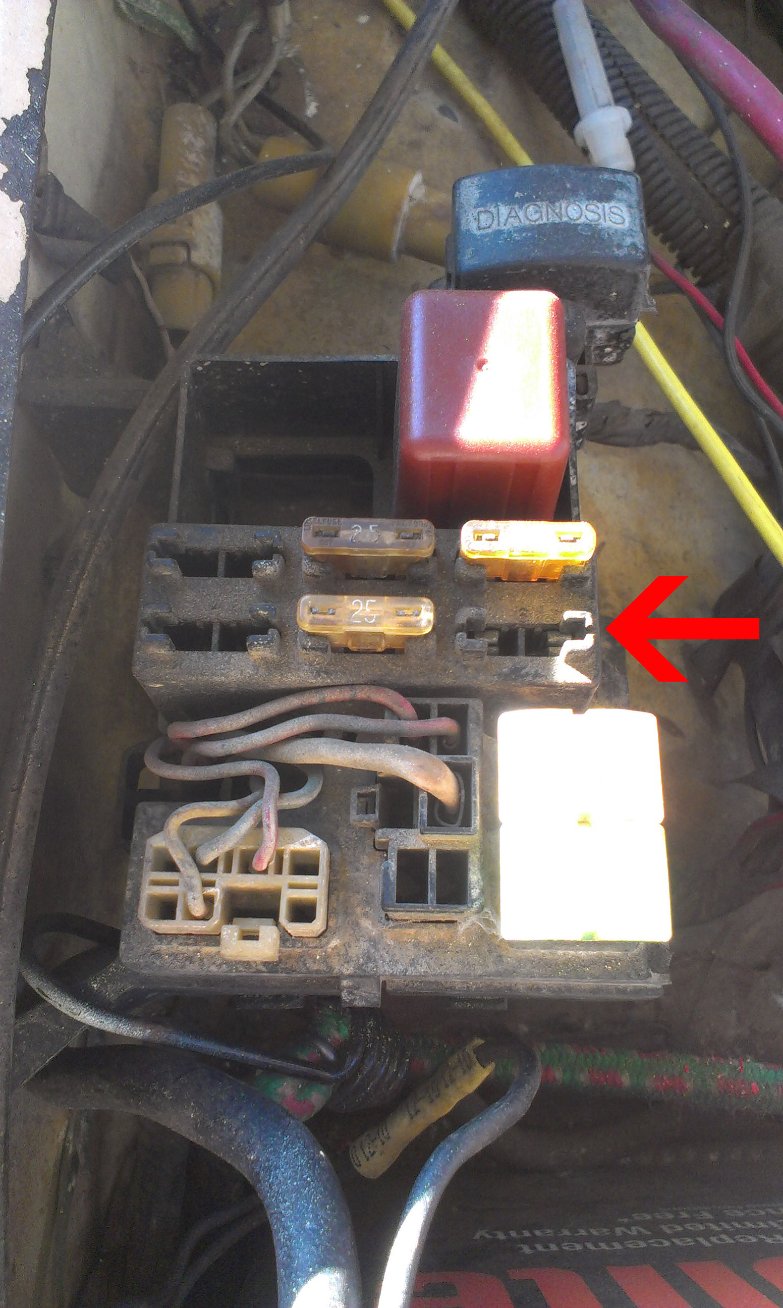

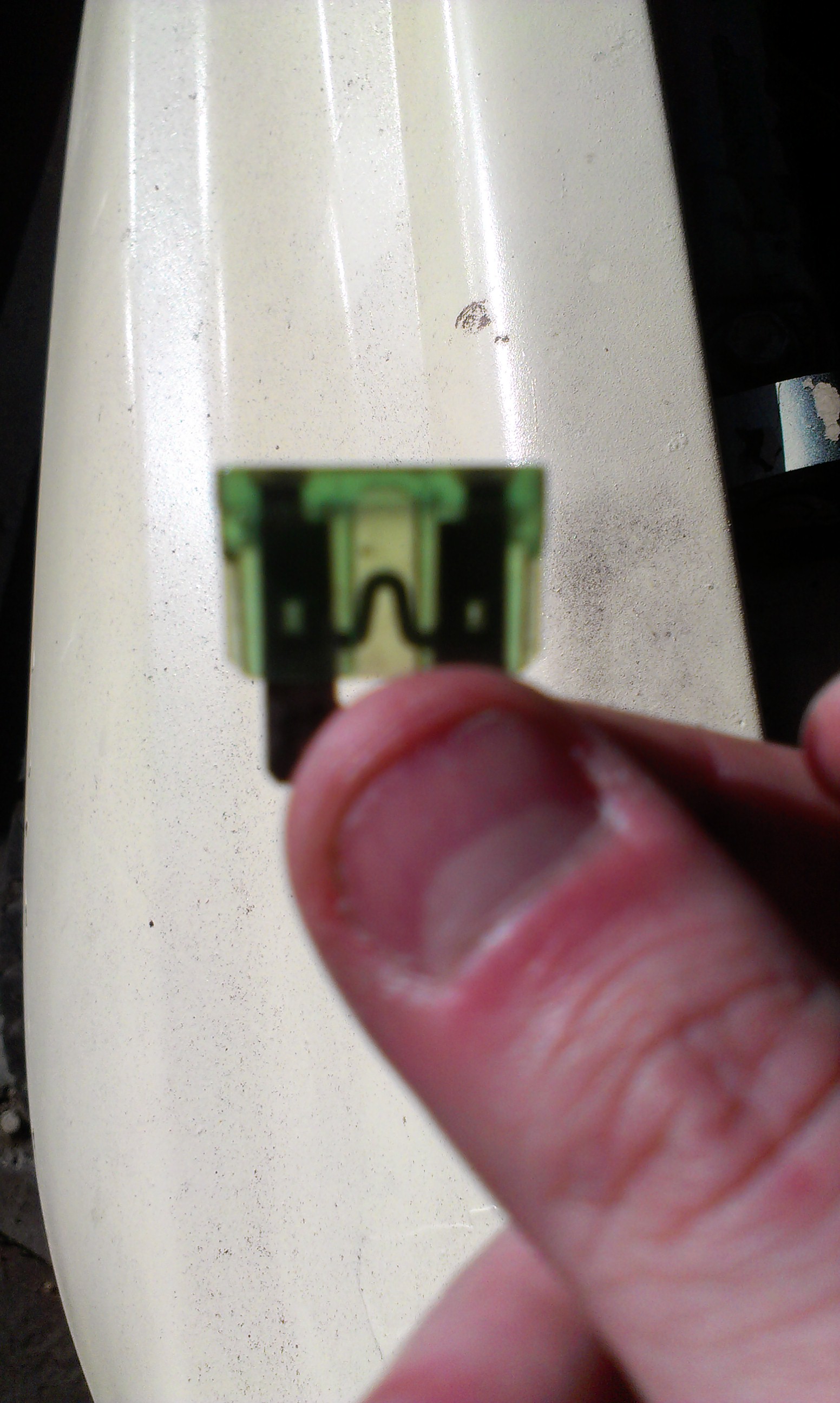

So I removed this fuse from the fuse box in the engine bay and all appears to be right with the world again. The parking lights, tail lights and all turn on again using the headlight stork on the steering column and are otherwise off. Not sure why exactly just removal and not replacement of a fuse has resolved this issue. At least I think it's resolved. Any problems with driving without this fuse? I would have thought without this fuse, my parking lights and etc... would not work at all?

The fuse you pulled unless your wiring has really been modified is the Hazard/Horn Fuse!!
The only down side is these not working with the fuse pulled.
Which really makes me think there is a alarm or parts of one in the truck.
Did your Horn ever work??
Did the Hazard lights (4 way flashers) work at all ??
Will either work with the fuse pulled?? They should not but at this point who can say.
