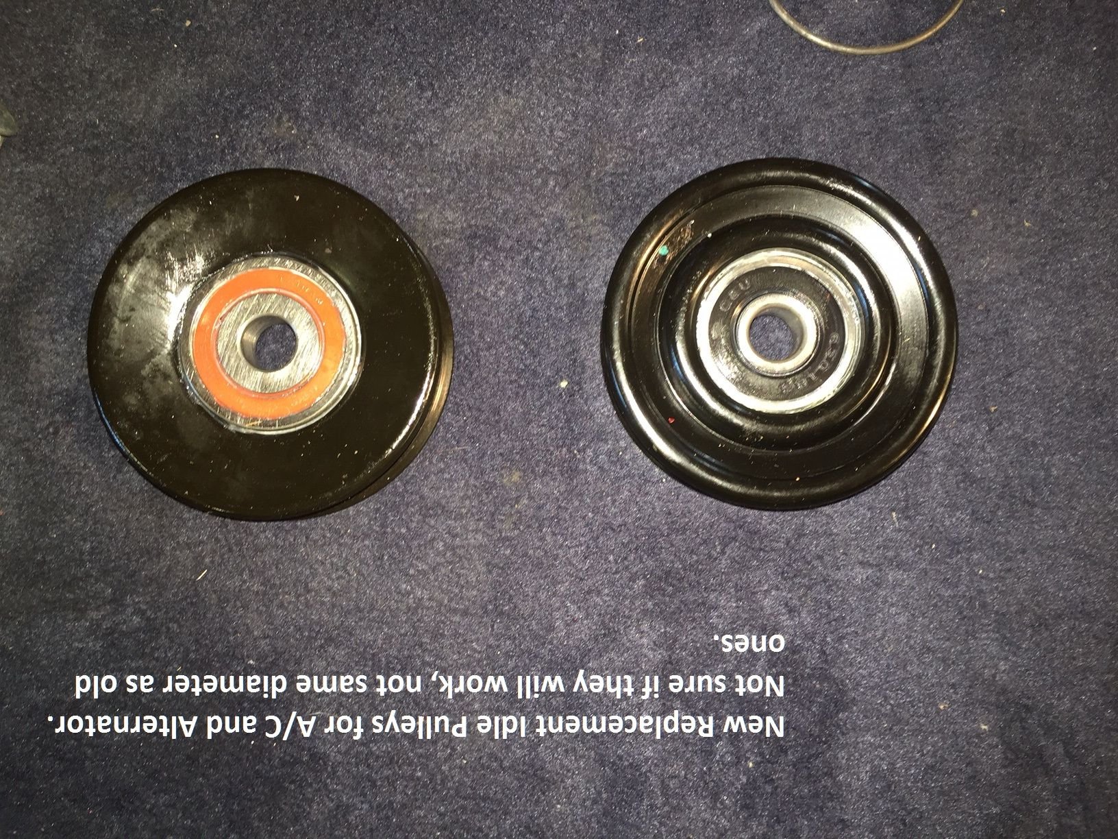

Here are the pictures. Once again, my concerns are:
1.) Will the "4 crankshaft pulley and "6 water pump pulley cause issues?
2.) Can I use those replacement idle pulleys even if the diameter isnt the same but the bearings are the same size?
Do you see any issues with the overall design? The water pump and oil pump are new from LCE (the upgraded "Street" versions", I also painted them which is why they are that color (P/S pulley and pump is original). I decided not to mess with the timing setup because I am making a lot of changes already and I couldnt get the quality parts over the weekend. I have a new kit with metal brackets along with a new oil pan coming next week for that fun.
New LCE "4 Crankshaft Triple Groove Pulley. (Came in their kit with the #6 Water Pump pulley and timing tag which is why the timing piece is cut off the oil pump).<br/>
Original idle pulleys, I painted the in case I use them instead of the replacements.
Replacement pulleys, different diameters but the bearings seem like the same size so they technically fit, just not sure if the difference in size will cause issues?

Not sure what your question is specifically. Will it work? If nothing is rubbing and everything spins, then yes. Obviously with modifications of this type, your water pump, PS pump, A/C compressor, and alternator will all spin slower. So less water flow, PS won't be as strong, A/C might not work as well, and charging at idle will be reduced. Willing to live with those? Then it will work. If the belt is too long, get a shorter one. Depending on the belt brand the last 3 digits in the part number are the length with the last one either 0 or 5 for an even inch or a half inch. So XXXXXX465 is 46 and a half inch long. Different idler pulleys will work fine as long as their offset is the same as stock so the belt isn't bent out of plane. Diameters aren't super important as long as the tensioner can make up for it. LCE's front pulley should be accurate as far as timing marks go because there is no rubber insert for the marks to twist on. But the timing pointer that bolts to the oil pump is adjustable so you'll have to adjust that yourself otherwise it's all useless. The stock harmonic balancer can be inaccurate because the outer pulley spins on the inner hub so the marks aren't lined up anymore.

you should be able to walk into any flaps and get a slightly smaller belt.
i would however go back to stock... harmonic dampers are engineered to be heavy for a reason.
