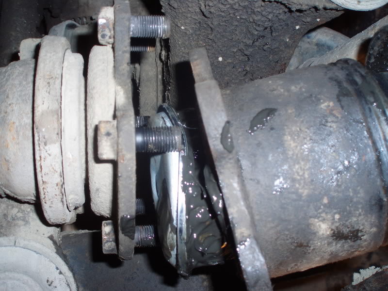

              Gah right now i can get my cv to slide out, its stuck on the bolts where the cv mounts to the diff flange..

              Maybe let the A-arm unflex a bit, get the CV to clear the diff flange, then flex the A-arm again, once its clear.

              This should pretty much explain whats going on...

              If it makes any difference, this cv is shot... it doesnt even rotate as one piece.. so im thinking where it mustve seperated this is what makes it longer, so thus making it harder to slide out?

              Your CV ain't supposed to look like that. Its definitely not salvageable. I would just muscle it out with a pry bar.
