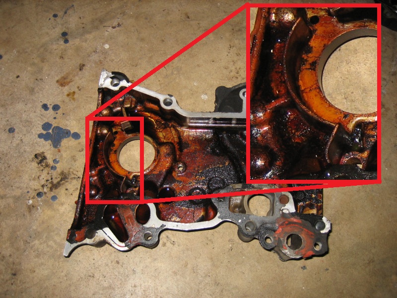

Mystery metal in pan
I currently have my 22RE apart for the same issue and here's what I found:
I had some pieces of the driver side guide in the pan, but also a bigger chunk that was loosely riding the chain inside the tower, which had been making a small noise of it's own (on acceleration/deceleration). Now those little pieces in the pan began as a whole guide and they could only get that munched up by zinging thru the slapping chain and drive gear. That puts you at risk of having severely jumped timing/or bent valves.As far as the MYSTERY METAL- There is a thin-walled semi-circular casting at the lower end of the tc cover made to limit the chain slop. Perhaps a 1/2" square piece of that was found in my pan-pretty chewed up. It came off the end, so you had to look closely and barely tell the tc cover was missing a small bit and the geometry of that semicircle wasn't true.
Haven't taken the head to the shop yet, but I turned the head upside down and filled the valves with water and they didn't leak! Still, it's going to the shop, to have the valves checked for peace of mind. Good luck!
