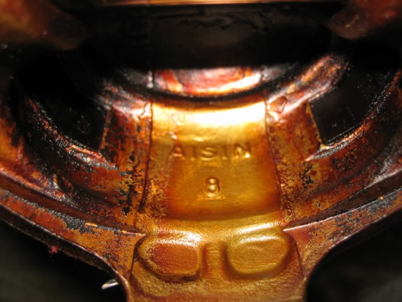

It does feel like aluminum. I can't seem to locate exactly where the coolant is coming from inside the motor even with a floro. seems like it may be leeking between the walls but it really hard to tell.Originally Posted by plumo57
It does look like piston skirt. I didn't see that you mentioned, but is that a piece of aluminum as it appears in the photo, cause that would lean heavily toward piston skirt in my mind. As to the coolant... Can you get a bright flashlight or shop light and try to follow the drip upward to narrow down its source?
Quote:
what in the hell is that from? Originally Posted by Double D
I've been all the way through a 22re, and I still can't see what that could be from, lol

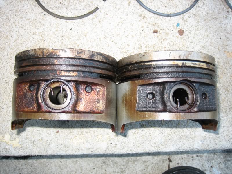

shine a flash light up the cylinders and make sure all the pistin skirts are still in tact...
but, the walls of the pistons aren't quite as smooth as what's in that picture

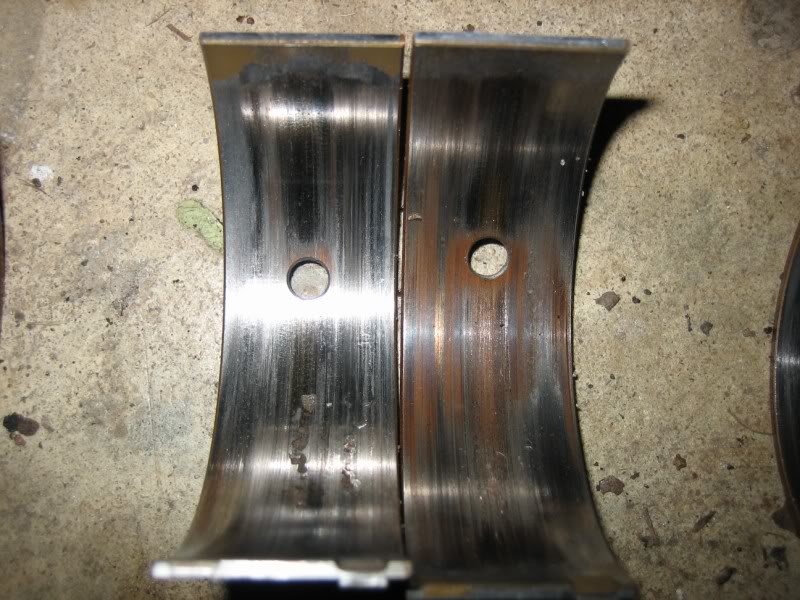

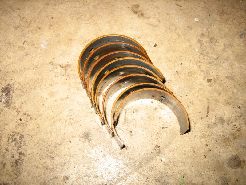

and MAYBE a rod bearing, but how in god's name would it get out? and if a chunk like that was missing out of a rod bearing, it would be VERY obvious, lol

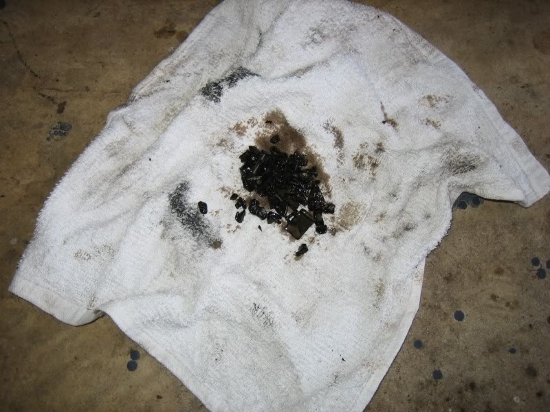

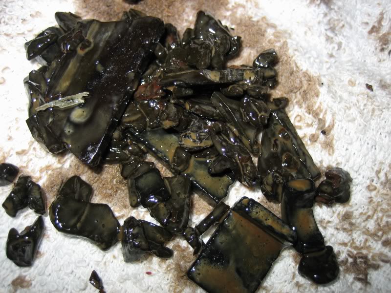

btw, the plastic is definately from an old timing chain guide, lol

Thanks for the input. I can't seem to figure it out either. I have a three month license suspension awaiting me starting on the 22nd (in two weeks) so i'll utilize that time to rebuild. I was gonna SAS but maybe not yet. Motor seems more of a priority. Since this thing was treated like , I think I will rebuild either way. Originally Posted by iamsuperbleeder
For now, I have replaced the oil pan, and filled her up. She runs like a champ and I don't hear that rattling noise anymore. I don't over heat. I don't have any signs of bad head gasket and can't see an external leak of coolant.
My guess is the timing chain and a hole in the cover like was stated before. Hopefully when my driving time is up, there will be better signs of whats wrong. Thanks again, I will continue this thread with follow ups as this info has been very helpful to me in understanding more about my new toyota. Thanks guys

Quote:
Looks to me like the inside of your TC cover.Originally Posted by Double D
So here are a few more pics of the metal pieces. I haven't yet determined where the coolant is coming from but my guess is its not good either way. What do you suggest I do. It's dripping now about a drop a minute or so. Seems more frequent than last night. My timing chain looks brand new from underneath so maybe the plastic is from before it was changed. My guess being that it was changed recently? Do I still need to take the valve cover off? Thanks
That would make some sense...
Light pot metal, Perhaps from last go around???
Repo
Repo
Whats in store for the job if the timing chain has worn a hole through the cover allowing coolant in? I understand the concept of what happened but I don't know what i'll be up against if this is the case. Should I consider a full rebuild or just focus on this issue?
Take off the valve cover. 4 nuts. Check the chain for slack. Then look into the cover for guides. It will be the drivers side thats gone. If thats the case. If they changed the timing chain , gears and guides and didnt pull the pan. That explains everything . The old crap was in the pan from last timing kit change. Anti freeze gos in the pan changing the front cover. Could have been slinging around in the oil pan. Chances are if the cover was changed it would be cleaner than the rest of the engine. Bad news is. The anti freeze kills bearings. Not to mention the rest of the trash you found in the pan.Wont be long, if it was run long in the oil. It will start a low knock. Then get worse. If it were mine I would tear it down and fix whats needed. Dont push it and ruin a crank.

That makes alot of sense. I wouldn't doubt my bearings are going then. I do hear a real low knock at around 3500 to 4000. Things are coming together more now.Originally Posted by tinkertoy

Piston skirts and rod bearings...

On the timing cover at the bottom there is a ring formed into it that's designed to help keep the chain on the lower timing gear. When you have a big hunk of the plastic timing guide go between the chain and that gear it pushes the chain outward and breaks this cover off and you get the chunks of metal you have in your hand in the oil pan. Look at a picture of the timing cover and you'll see that at the bottom. I had the same in my pan when I jumped time.
You just need to do a timing job and replace all of that. You can try to do it like some say here without pulling the head but I didn't have any luck at all doing it like that and had to redo it because it kept crushing the front of the head gasket. Do it once and do it right. Pull the head, get a complete engine gasket kit and a timing set from engnbldr with the metal drivers side guide.

Yep. It's not a piston skirt, and too thick to be a bearing. Most likely it's that bottom round part of the timing cover.Originally Posted by ovrrdrive

As long as nothing else is wrong a complete timing job with a new cover should fix the leak. Funny thing about engine problems though is that there could be other stuff wrong. From the way it sounds that's the problem but as with the mechanic there are no guarantees.

I know exactly what that metal is.....
it's the brace on the timing cover that is under the chain.......the guide broke got jammed in there and broke off that support
oops someone already posted that
