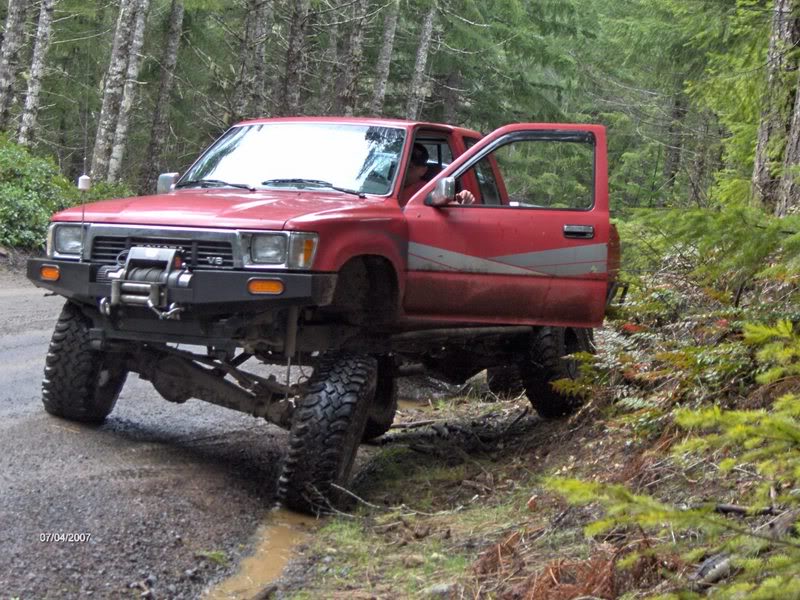

If your SWR's are high on ch1 then your antenna needs to get longer (loosen the set screw and raise the stinger up).
If they are high on ch40 then the ant needs to get shorter (loosen the set screw and lower the stinger).
Once you get to the point where your SWR's are the same on both 1 and 40 you'll want to check them on 20 (it will probably be lower on 20) and you are as good as you can get with the antenna in that position.
When you think about the term SWR it means "Standing Wave Rejection" the bottom 1/3 of your antenna is parallel to a steel surface so you may never get your Standing wave down to the ideal 1-2 but if you gotta run 3-4 to keep it in your mounting location its not the end of the world. I run a Wilson as well and the best I can get with a similar mounting location is 2.
