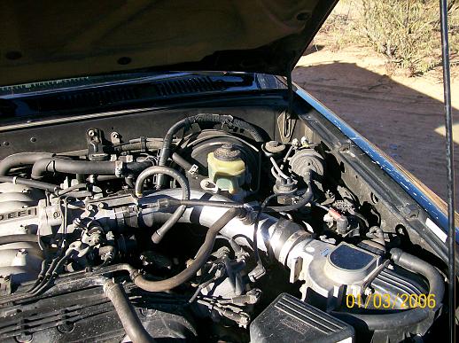

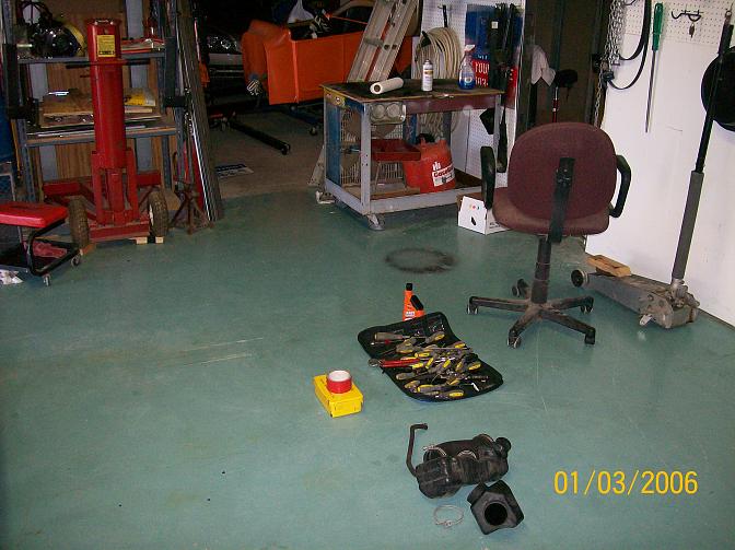

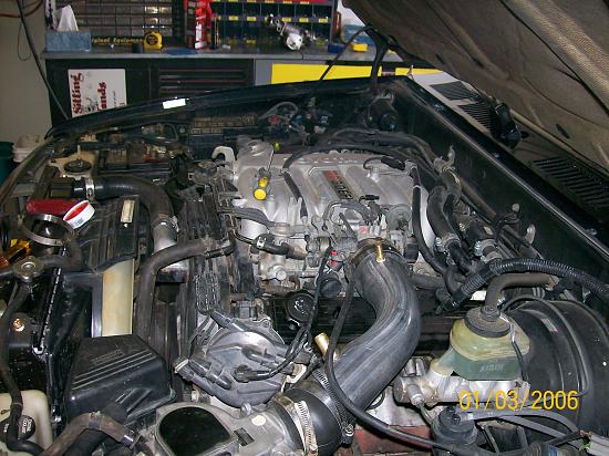

I.S.R. mod for me
Ok, I ended up getting an 18 in. pc. of 3" exhaust pipe, 7 dollars. I took solid wire and made the form I needed, wire I had, .50 cents. took it to the exhaust shop down the road to have it bent, a can of coke. 3" rubber coupling for ABS pipe, 8 dollars. a 3/8 MIP to 3/8 hose barb fitting, $2.65, 5/8 MIP to 5/8 hose barb fitting, $2.95.
the feeling of accomplishment....priceless.
I found that the 3" I.D. pipe is a bit too big as the openings from the mass a/f and intake are 2 3/4". also the ABS couplings are about 3 and 3/8 I.D which sucked. so I ended up getting a 3" flexible 90 deg. and cut the coupler ends off. perfect fit. the curve of the rubber was kinda a bear to get cut properly. (I was told an innertube from a off road mtrcycle would be perfect to strectch and clamp on for the couplers, will find out later). drilled my holes and tapped them using an iron pipe fitting of the same size.
(I actually screwed up there and put my larger fitting forward when it needed to be rearward...lol...no fret)
pulled out the I.S. unit and installed the pipe.
Attached Thumbnails Cant find ISR mod parts...-100_2498.jpg   Cant find ISR mod parts...-100_2502.jpg   Cant find ISR mod parts...-100_2504.jpg

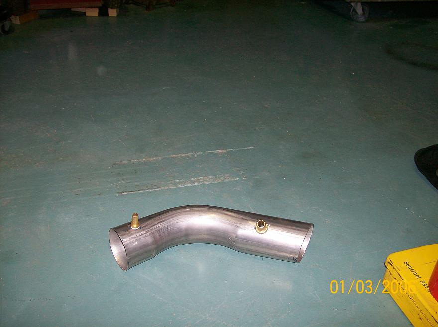

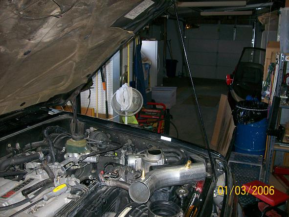

I did notice a small differance in performance. Now this is coming from a mod that I really didnt expect to notice too much from, but! I found somewhat more mid range power at about 3rd and 4th gears (accelerated much better on downshift to third and into fourth while passing an old lady creeping at 40 mph on the hwy.
low end might seem a bit more torquey as well as it climbs in 3rd what I used to have to downshft to 2nd for. so all in all I think it is well worth whatever it may cost for the do it yourselfer. I basically ended up with what I would have gotten from K&N for a couple hundred bucks only no air filter.
Thanks TUBBYFATTY!
Attached Thumbnails Cant find ISR mod parts...-100_2503.jpg   Cant find ISR mod parts...-100_2505.jpg   Cant find ISR mod parts...-100_2506.jpg
