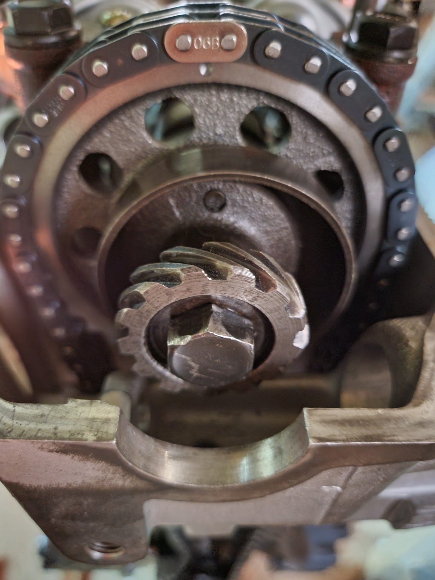

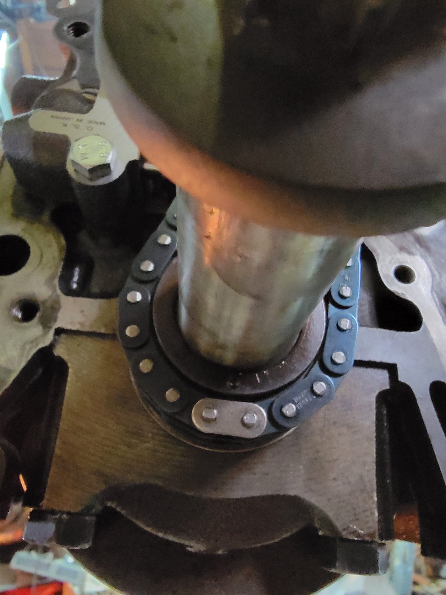

Took the cover off and the different links seem to be where they should be?
Tried turning the crank clockwise and both rocker arms on piston #4 get snug but NEVER at the same time.
If one is snug the other is ALWAYS loose.
Ive tried turning it around multiple times and checked both arms the entire time getting the same results each time.
In the last post I had mentioned how the lobes dont seem to be able to make the arms tight at the same time on piston #4
with the way they are oriented on the cam, making me think that there is something wrong with the cam.
