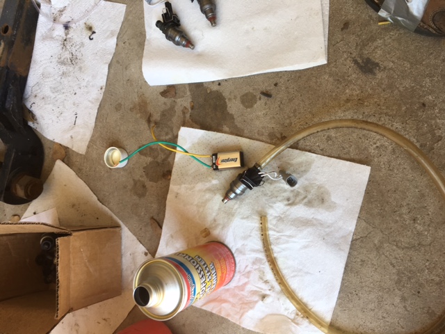

So took fuel injs,fuel rails etc back off today,thought I'd give it one last try before I give up.Re-Cleaned everything,took each inj,hooked a clear tube up to eac one{one at a time}filled the tube with some Inj cleaner,blew on tube while hitting contacts with battery to blow those out.Re-assembled everything.Started it up.........drumroll.........it's fixed!!!!!
Thanks for the help
Thanks for the help

Nice, thanks for reporting back on the mystery. Plugged injectors and junk in the fuel rail makes pretty good sense
. That filter pic kind of helped us focus on the right area lol. Hopefully there isn't anything in the fuel lines, but worst case, you know how to clean it again if it came down to it.
