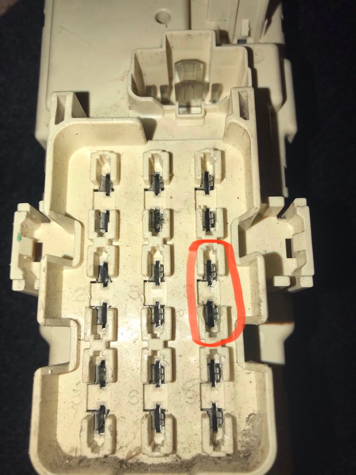

My truck- if I left it the way it was probably would’ve ended up in a fire too. The previous owner put oversized fuses in all the slots. I didn’t catch it until I realized my brake lights didn’t work and voltage dropped the circuit. Fuse block started melting slightly from all the heat buildup in the circuit.

The PO put 20A fuses in every slot. i’m guessing he thought bigger is better in that aspect haha. Luckily no fires, and nothing super expensive was harmed.
My guess is one of the contacts for the bulb was corroded and started causing it either arc or build up heat from the resistance. The fuse wouldn’t blow from it being overrated for the circuit.. Either that or a loose fuse in the block, but they were all tight in the block.
When trying to figure out the problem I scraped all the dirty contacts clean and it still didn’t fix it. All that extra resistance had damaged my fuse block in that circuit. (slightly discolored and deformed in the picture). Anywho I picked mine up for $35 on marketplace, put the correct fuses in and good to go!
