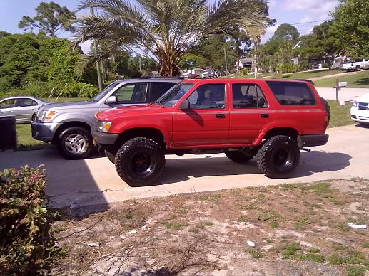

Easiest way to do this will probably be just to load a few pictures. First is when I first got the truck, stock everything. crappy 15x10 wheels and 32x11.50r15 bfg all terrains. Second pic is still stock everything, but some 15x8 wheels and 33x10.50 swampers. Third pic is BJ spacers and landcruiser coil springs, 33x12.50 pro comp mud terrains on a different set of 15x10 wheels. Will post pictures in a minute

Oh, and 3.75 backspacing will be good. Don't think you'll get away with stock wheels and 12.50's cause I think they'll rub the upper control arms without spacers. I don't know what the backspacing is on the stock 4runner wheels, but I know for a fact you can't use stock tundra wheels with 285/75/16's cause they juuuuuuuuust barely rub. Both of the sets of wheels I currently have (the 15x8's and the 15x10's) are right at about 3.75 and I have tons of clearance.
No rubbing at all. I have absolutely no idea whatsoever what kind of wheels these are. I bought them for cheap locally because the steel wheels are easier to balance. They were originally chrome or something that started rusting and looking chitty, so out came the krylon touch, and they actually came out pretty nice. And for a $50 set of wheels, I can't complain

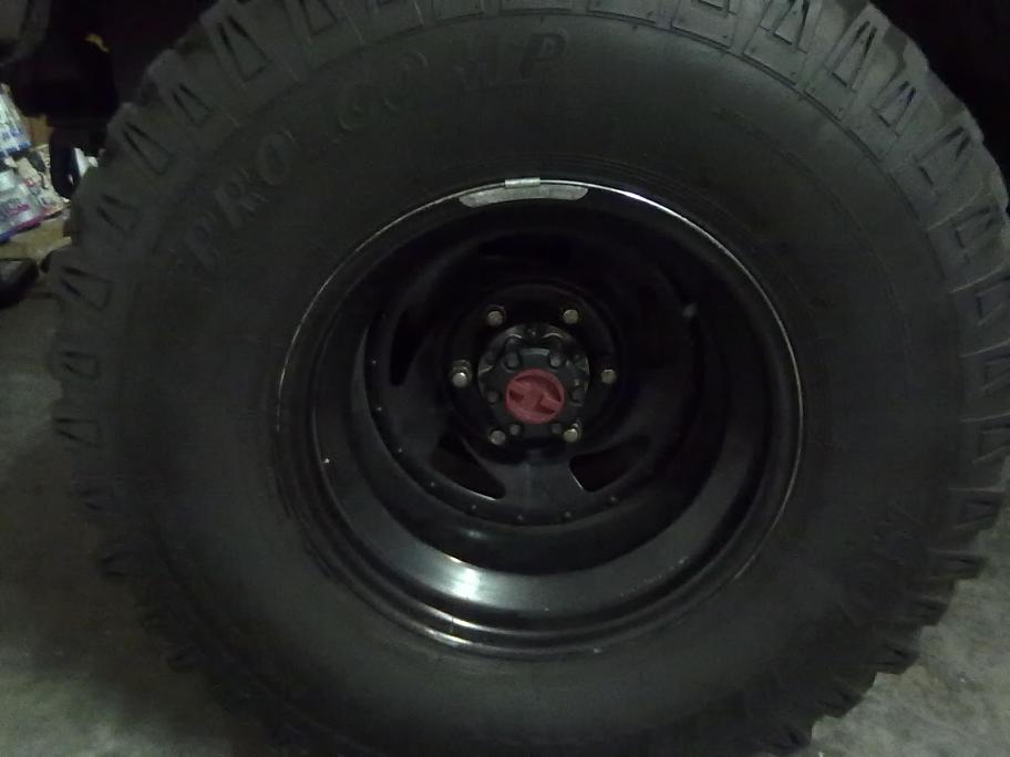

I have the procomp mud terrains now and overall I'm pretty happy with them. They're a good happy medium... Don't do anything exceptionally, but do everything more than adequately. They don't ride like an A/T tire, or street tire, but ride really well. A bit noisy, but not bad at all. On the flip side they don't dig like my swampers did, but then again ride well (I didn't have any complaints about how the swampers rode) and they're a hell of a lot quieter.
I like 'em, and have probably 10k miles on them now (guesstimating... I have about 5k on them, and got 'em used in a trade) and they're still at about 14/32 tread depth... so still about 65-70%.
As with ANY mud tire, STAY ON TOP OF YOUR TIRE ROTATIONS. I don't let it get between 2500 miles between rotations, and they wear great. No chopping, cupping, feathering, etc. Everything is nice and even, which helps the ride a lot.
