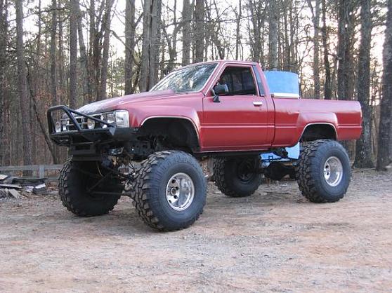

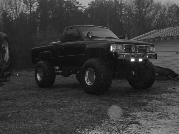

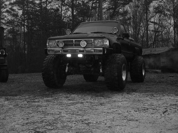

Ok what i got is a stock ct-20 turbo from a stock 4 runner its rebuilt im not really looking to build alot of boost because of the 3vz headgaskets i just rebuilt my motor about 4000miles ago i have shaved heads ported polished cams true dual exhaust no cross over junk reworked valves and a few other odd and in things the truck really has alot of power compared to the pother ones a have had in the past i can smoke a stock 4 runner with a 5speed and i have stock gears sitting of 36" swampers with 14"wide chevy truck wheels ..but back on topic i really just want the sound and alittle bit more power i just dont want to over load the 3vz so help me out
there are some pictures of the black truck the red truck is my other project 302 conversion
