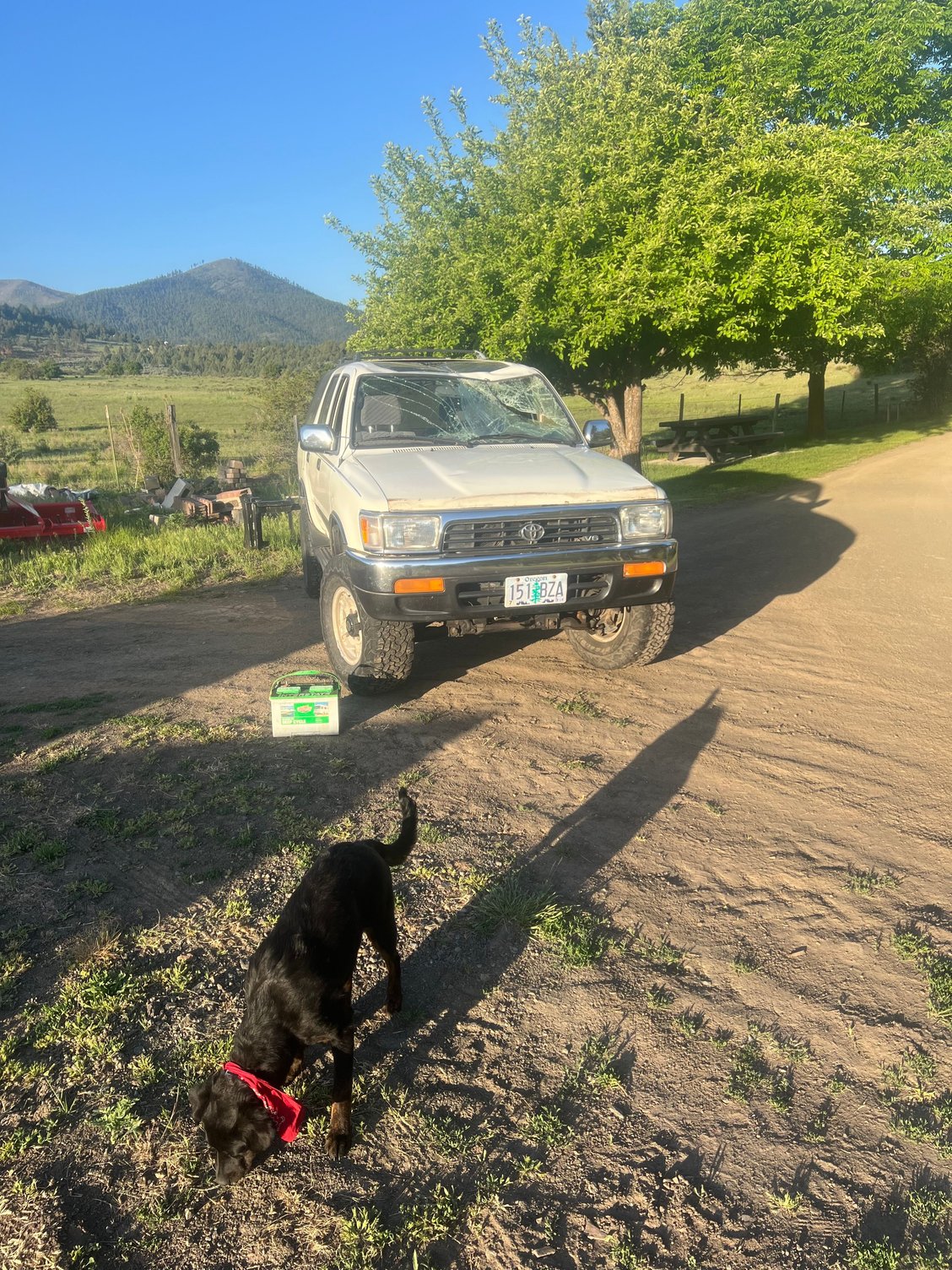

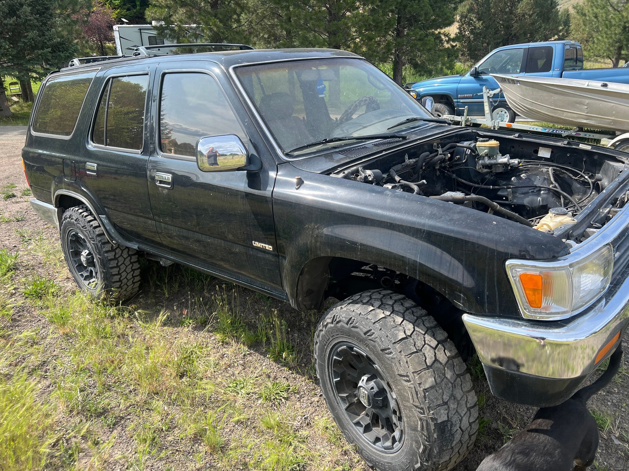

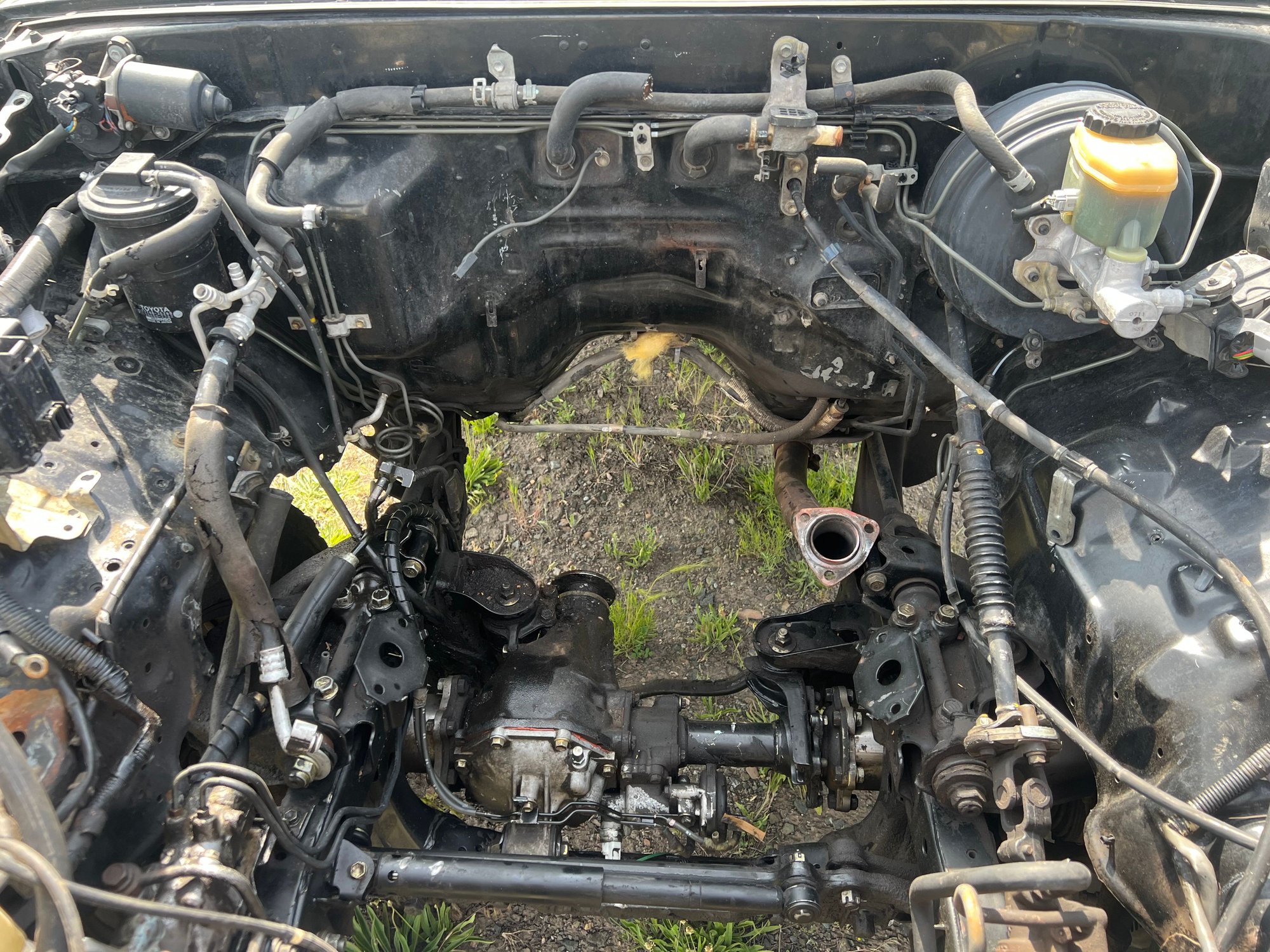

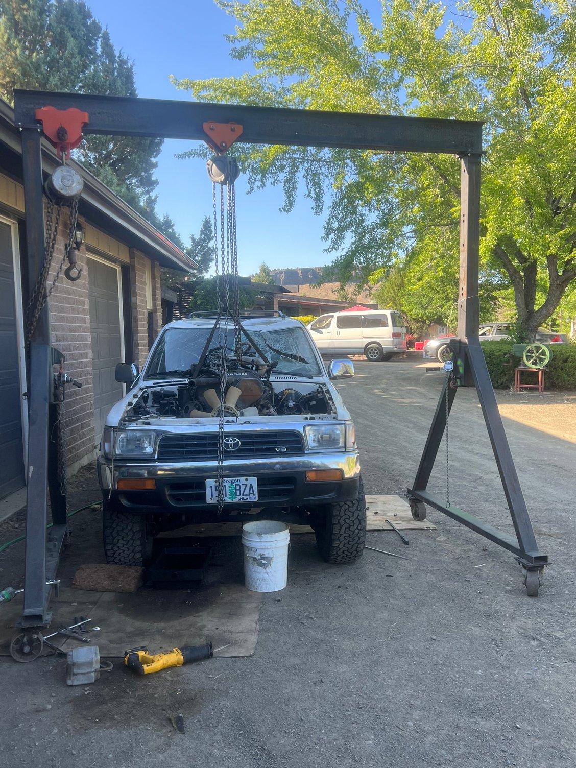

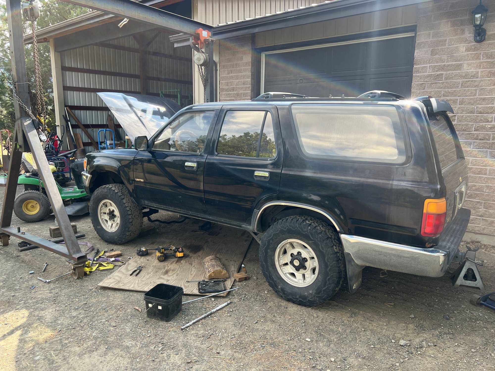

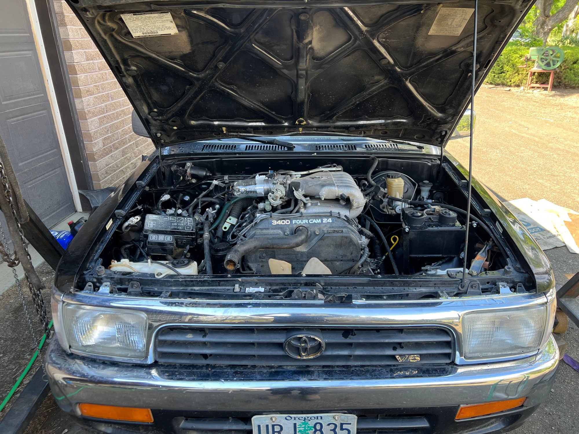

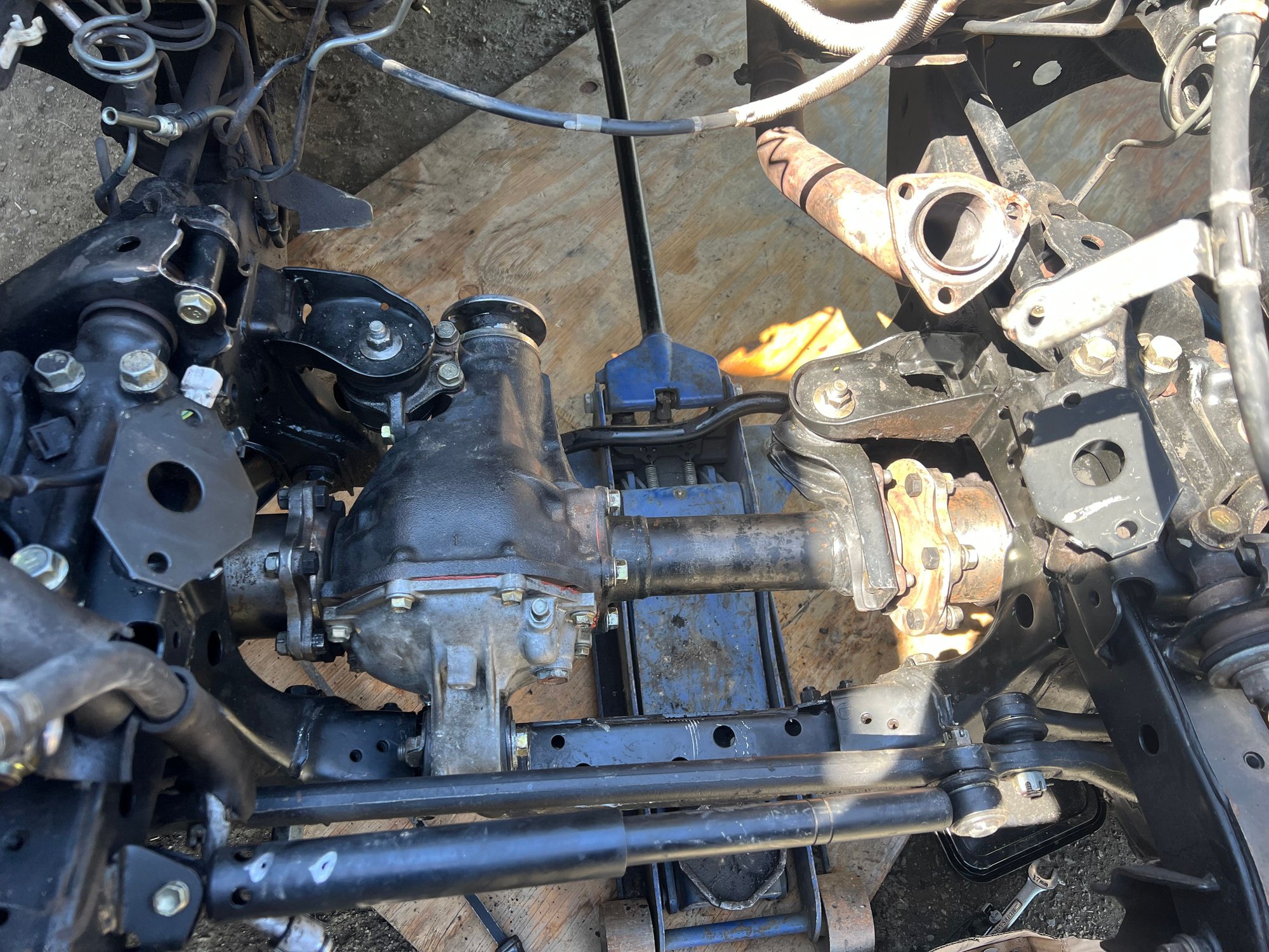

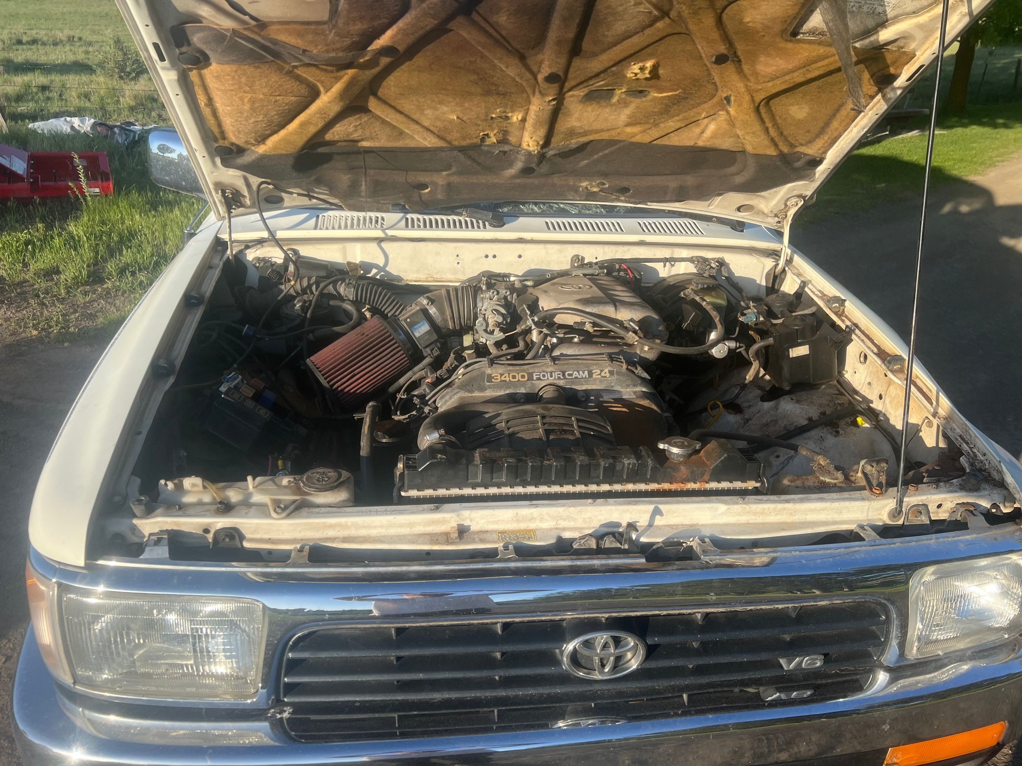

Got a free 95 4Runner in great shape, 3.0 ran, trans would not go into reverse, while searching on Craigslist I found a rolled 94 with a 3.4 swap already done and a manual transmission behind it. I’m in the midst of doing a 5speed swap, 3.4 swap and manual hubs. Progress at the time of writing this is I gutted the 3.0 and auto, on to tearing apart the donor vehicle. If anybody sees parts in the rolled rig they want lmk
cost of vehicle: free
cost of donor: 1500
Not bad for free
Not bad for free
Getting ready for 5 speed and 3.4

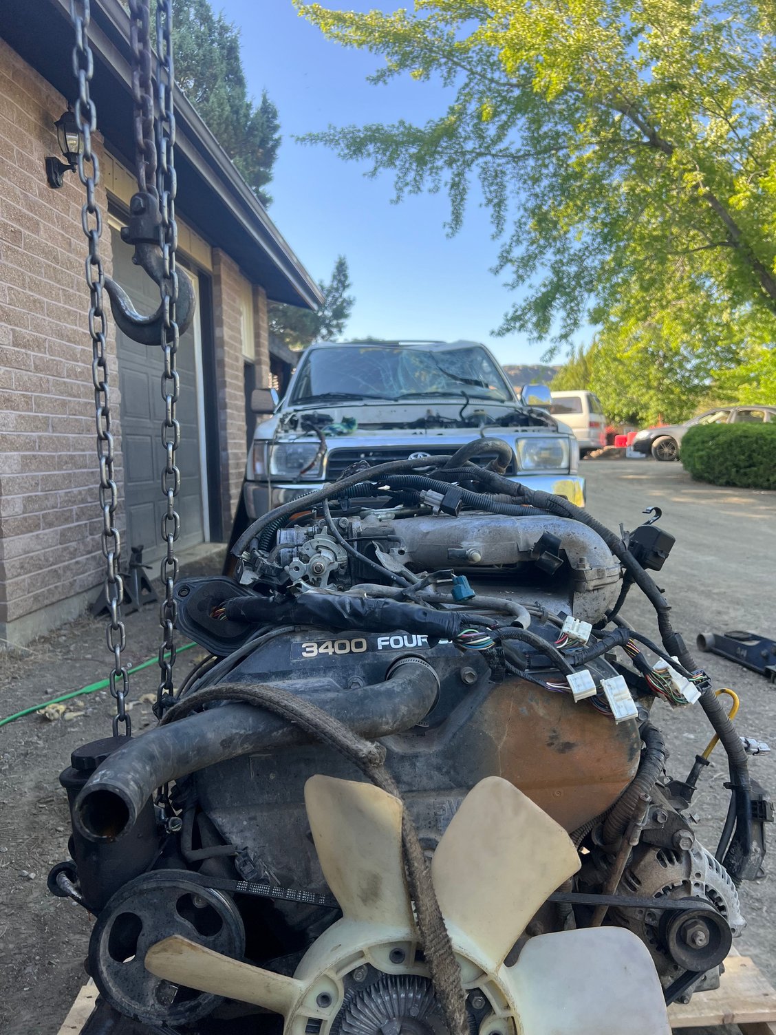

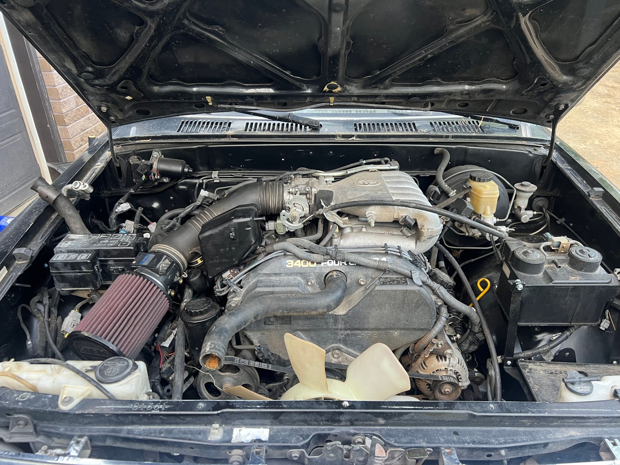

Donor 3.4
Donor 3.4

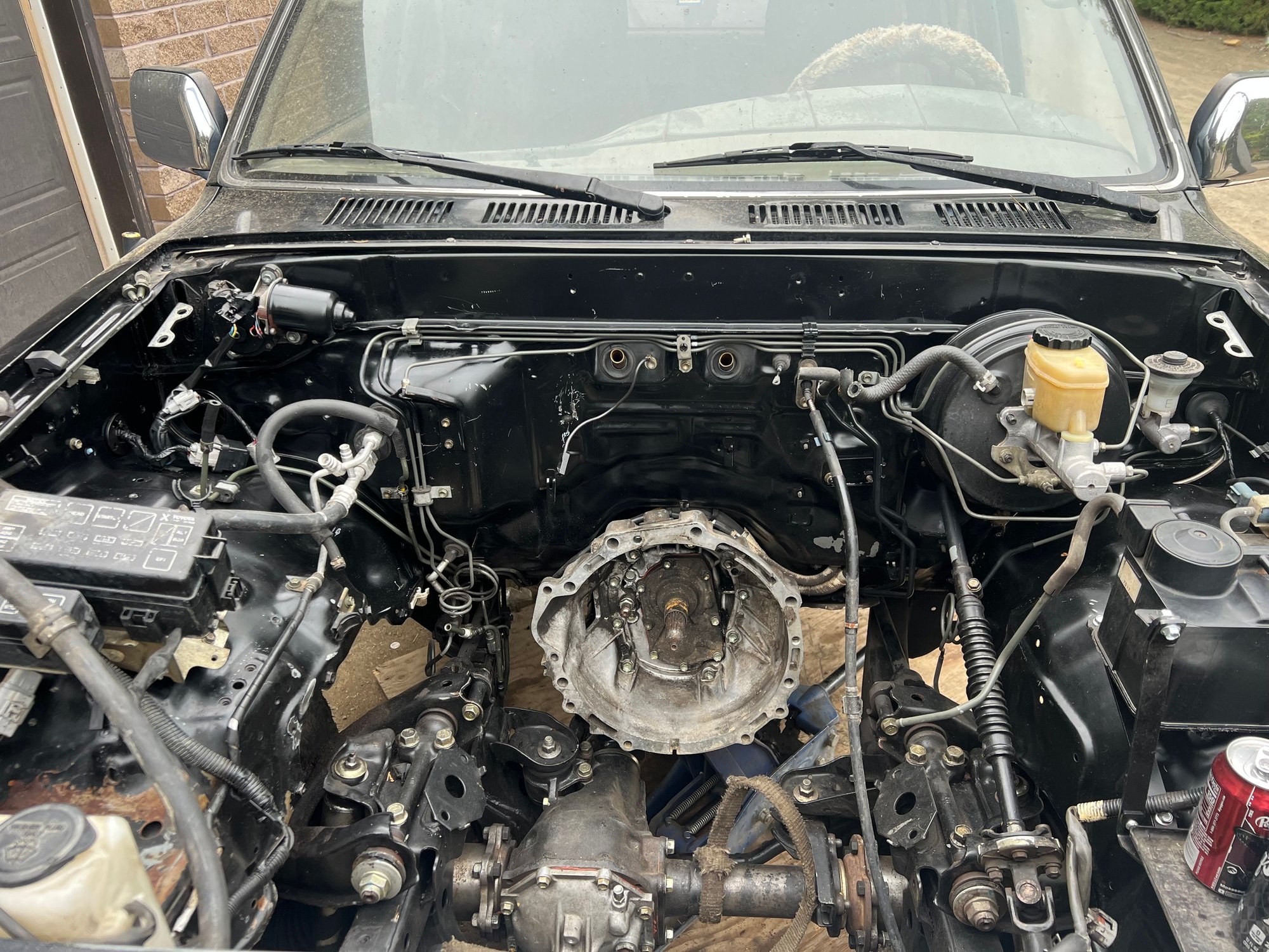

5speed👍
5speed👍
Rolled donor was nice.

Tons of parts on that rig from what I can see in the pictures! I have 4wd pickups, 91 and 92 standard and extra cab manual 22re engines. There must be some good bits that crossover onto mine. Both are well worn trucks pushing 300k

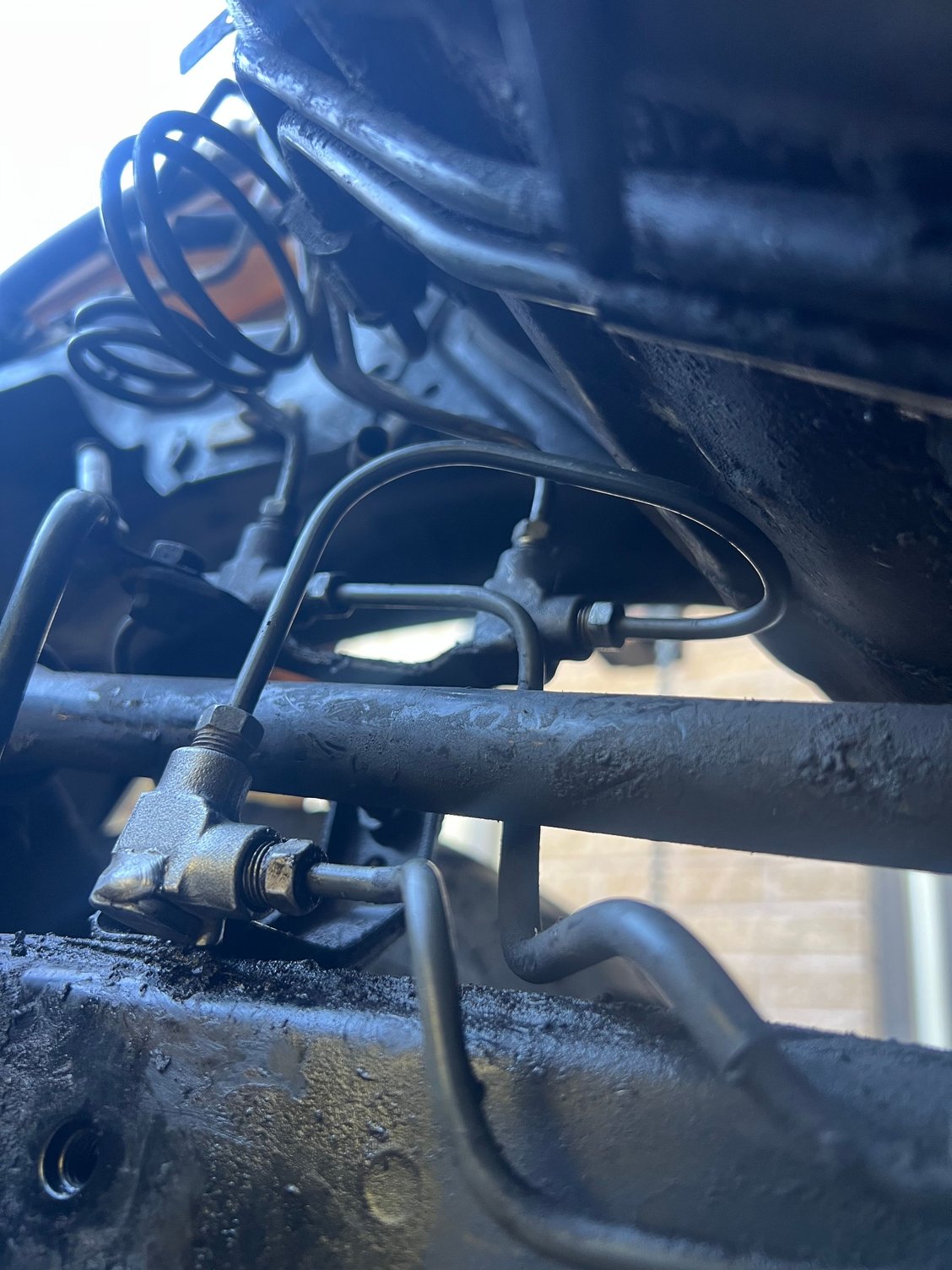

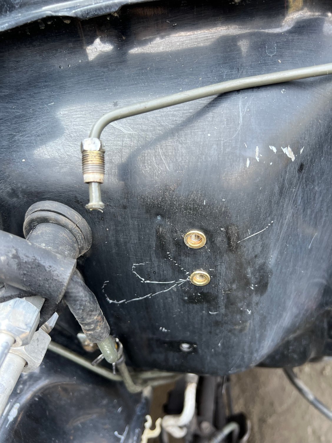

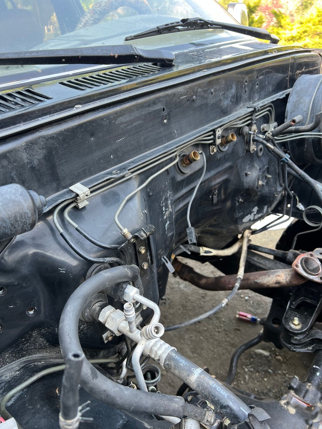

thanks! Luck is what I’ll be needing, after looking at the black 4Runner I noticed the funky abs system, I’ll be doing a full delete on that, I have a parts 89 pickup with the same wheel base, gonna use the rear brake hard lines from that… it will all be worth it in the end

as far as lines go I found a oem style replacement for the non abs on rock auto and I have a 22re pickup parts truck and after research the brake line is the same p/n so I lucked out there. Hopefully tonight I’ll start getting that 5vz pulled. Found someone locally that wants to buy my donor trucks seats for 500 bucks so that’s going to help make this as budget friendly as possible. Who knows maybe I’ll have a 500 dollar 5speed 3.4 when I’m done🤷‍♂️

Progress today! Now I’ll start taking the transmission the rest of the way out and get all the 5 speed goodies off of the donor (clutch hard lines, master cylinder, and pedal assembly)
Cleaned some of the gunk off

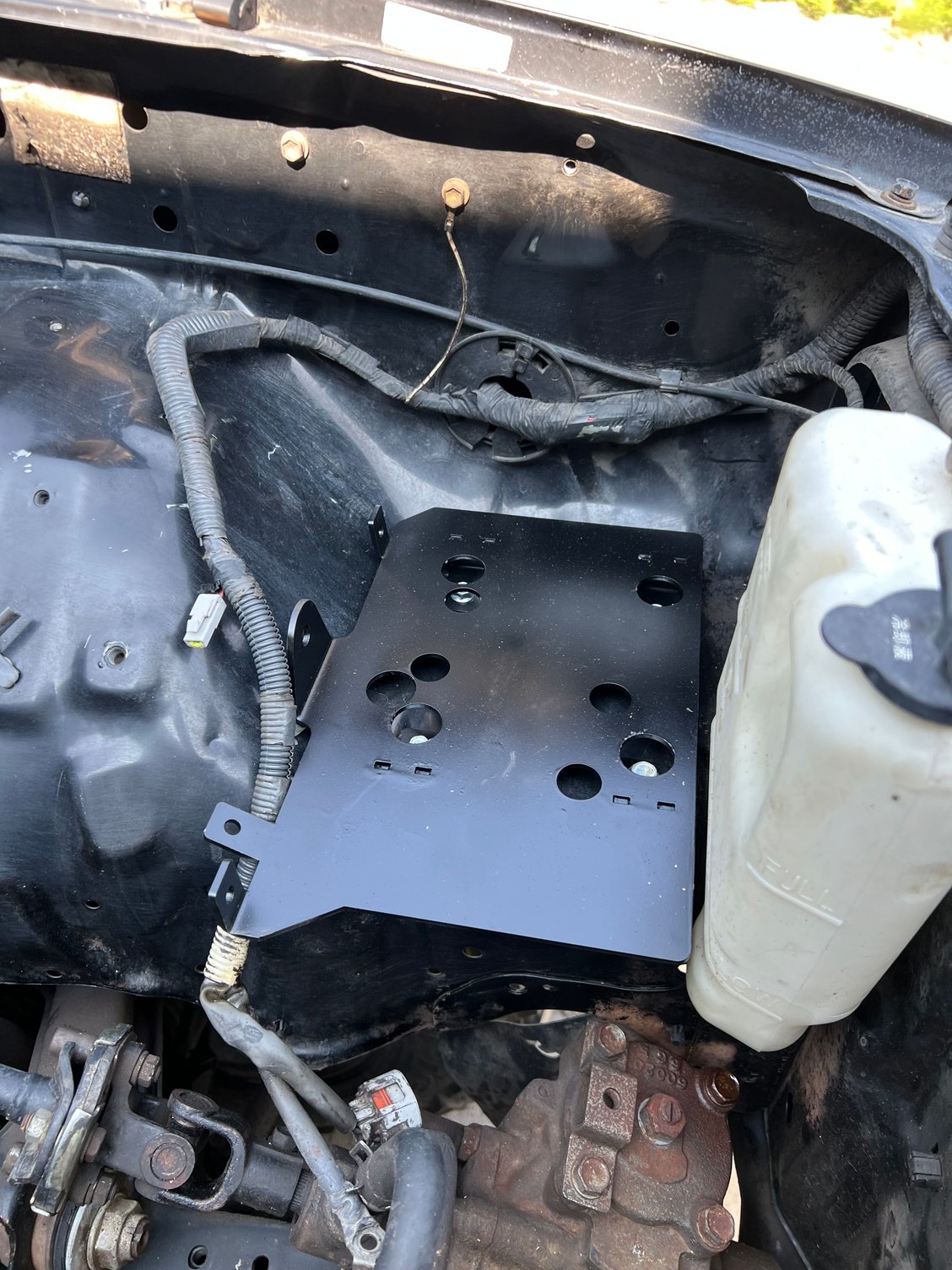

Made more progress, the weather has been wet and working in the dirt sucks so it’s been slow. Got the clutch pedal, master cylinder, and all the clutch lines installed and a toyonlyswaps battery box

Well I got the abs delete figured out, after thinking I could use a 3rd gen Toyota pickups brake lines and finding out they are way different I ended up making a short hard line that bypasses the abs. I used a 90° junction that I cut off my parts 4Runner and made this special little short hard line

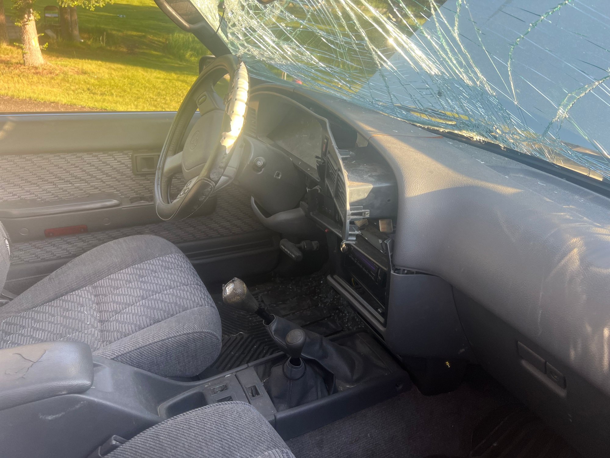

Got the manual transmission in, need to cut the tunnel out to accommodate the 5speed shift levers. I also prepped the engine bay for the engine. Looks clean.
