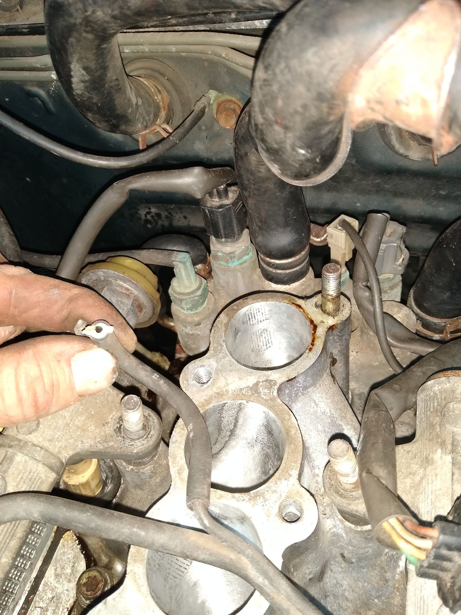

Broke thermal vacuum valve. Can i still drive the truck?
Old Apr 21, 2022 | 07:03 PM
mike250's Avatar
Joined: Feb 2014
Posts: 43
Do i need to temporarily plug vac lines now?
Old Apr 21, 2022 | 07:10 PM
millball's Avatar
Joined: Aug 2013
Posts: 4,262
Likes: 683
From: Southern Arizona
OK to drive. Either plugged, or maybe better with the hoses joined together.
Might affect cold idle a little, as the valve is meant to be closed on cold start, then open to continuously purge the evap cannister at all other times.
Old Apr 21, 2022 | 08:49 PM
scope103's Avatar
Joined: Sep 2007
Posts: 8,381
Likes: 873
From: San Francisco East Bay
A) replace the TVV https://parts.lakelandtoyota.com/p/_...092505047.html
B) join the two hoses together, so the throttle body is scavenging the Evap cannister all the time (risk cold idle, as millball points out)
C) do nothing.
If you do nothing, you can certainly drive, but there will be nothing to remove the vapors from the evap cannister. It will slightly affect mileage, but the most likely result is the smell of gasoline on the passenger side.
