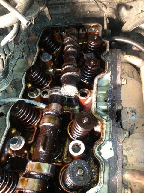

Dug into the truck a little today, the bearing is obviously bad and has chewed up the cam shaft and head

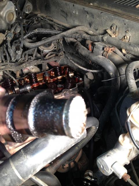

Still cant believe that scoring the outer part of cam shaft would cause it to break
