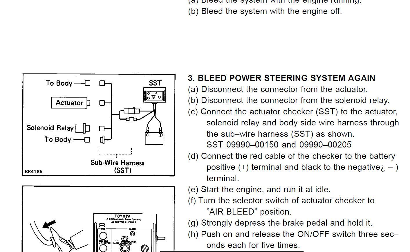

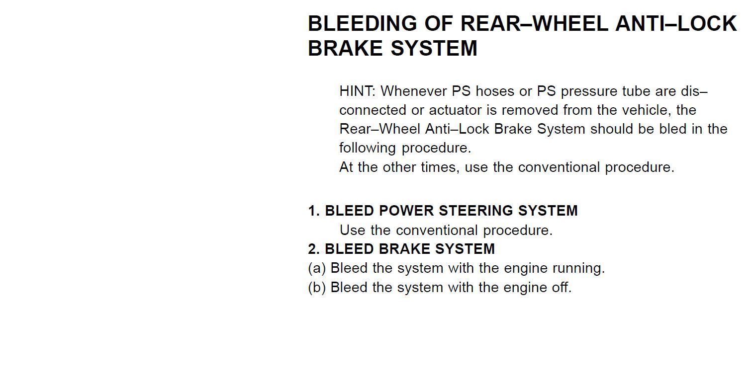

Now after all this i started researching, this truck has ABS. I read in the FSM if any part of the power steering system is opened the ABS actuator needs to be bled. So i remember the previous owner said he replaced the PS pump. Ok i look up the procedure, it states as seen in attachment.
6. I bled the power steering, got some air out of it
7. bled the system with engine running then with it off (2 person method, gravity method)
8. Now that i do not have the SST required in the FSM i took 12v straight to the solenoid on the brake actuator. I had my son hold down the brake and i momentarily held 12v to it for 3 seconds and repeated 5-6 times. He did not release the pedal during this time. I could hear the solenoid clicking

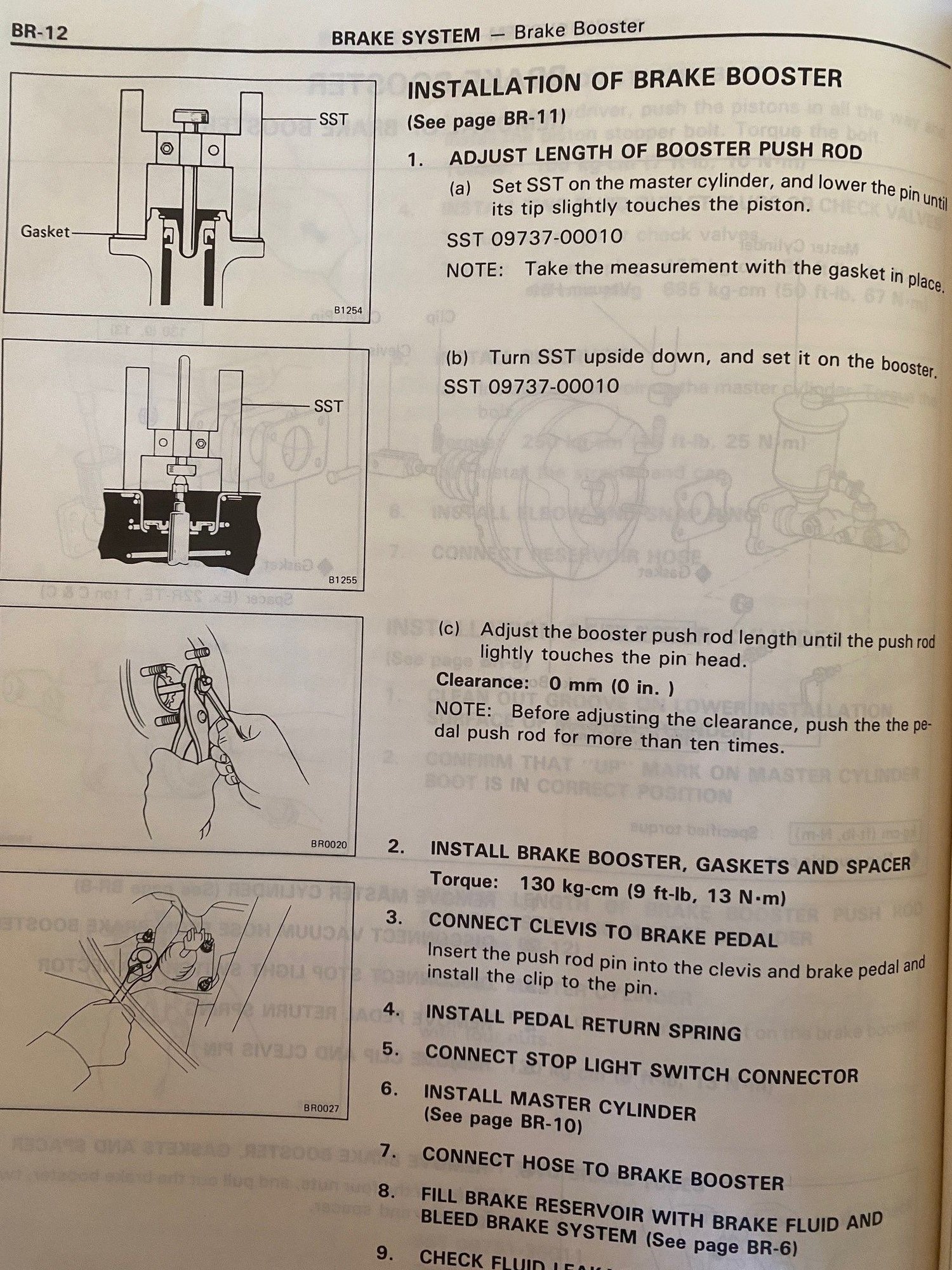

I am new to the Toyota truck systems but not mechanicals in general. Sounds like if this were a little bit older car you could simply adjust the length of the rod that actuates the MC piston...is that what the 'SST' does, electronically somehow? I'll go fetch my FSM, watch, and learn

No the SST simply actuates the ABS actuator to release any trapped air for bleeding. I've thought about adjust the rod but i don't think it's been tampered with. I think there is a measurement i can check in the FSM to make sure its within spec before i mess with it.

looks like there is an adjustable push rod inside the booster, but you have to pull the booster to check it. Not sure if you want to go down that rabbit hole, but it's a possibility. I'm sure you could take the measurement without the SST mentioned.
I would imagine if you could watch the fluid in the MC while someone presses the brake pedal, and if you see movement as soon as they start pressing it, this adjustment is not the issue. But when you say the brakes don't work until you get to the end of pedal travel, it was my first thought.
