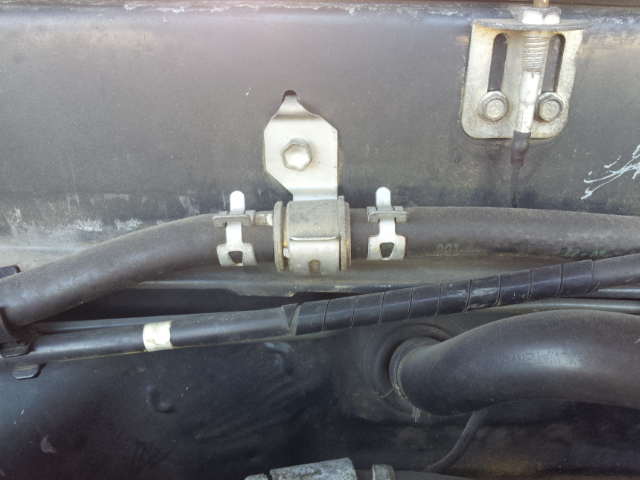

Does anyone know if the brake booster vacuum line has a check valve in it? Like maybe mounted on the firewall?
[IMG]https://www.yotatech.com/Name:  20130325_114827.jpg

http://www.toyomotorparts.com/Page_P...3497,3508,3515
http://www.utoyot8.com/Picture.aspx?...ccode=&ppName=
44730 VALVE ASSY, VACUUM CHECK(FOR BRAKE)
Yes..
