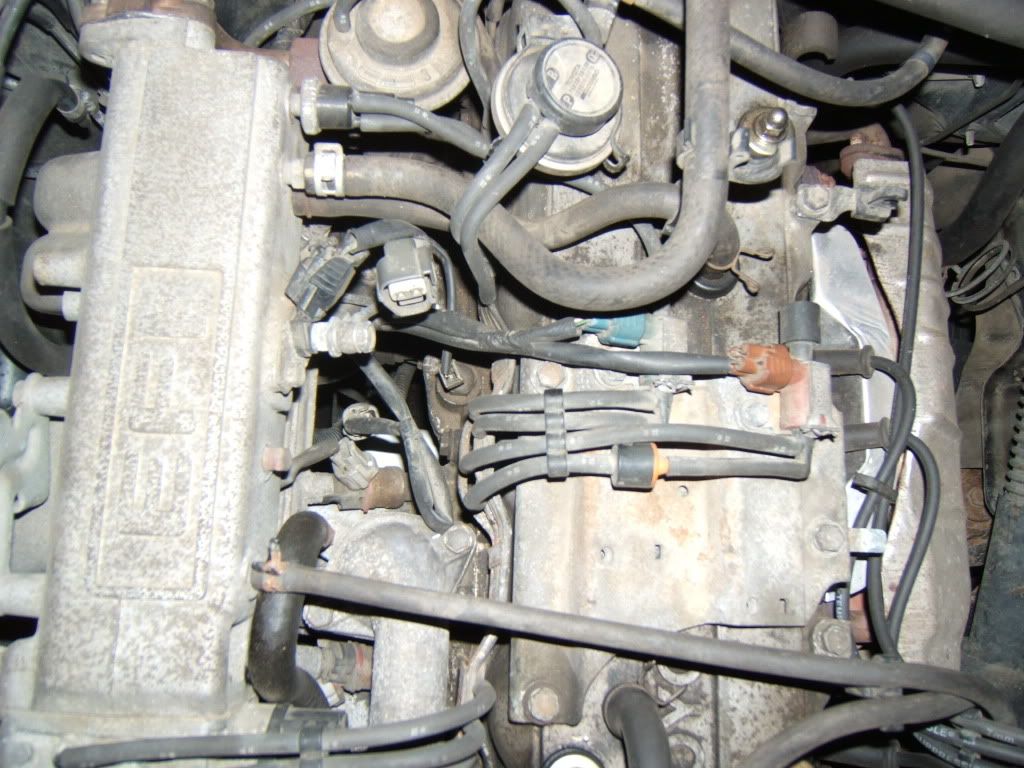

The extra wire you are talking about; is it near the cold start valve? get a pic of it. I think mine is unplugged as well. Might be for cruise or something we don't have.
Yep it's between cold start injector and #4 injector on the fuel rail. I get outta class in 5mins and gotta walk home, so I'll have a pic posted up for ya in about 15mins!

Take a look at this and tell me if its the same one? Right next to the CSV.

It's not the best pic, but its the best I could do with my phone. I can get out my dslr and get a better pic if this one doesn't show you enough.

Looks like the same one to me!
*edit* except I'm holding mine upside down, at least compared to yours

And that's used for some sensor needed for cruise control?

I don't think you need it. Mine was unplugged when I did my HG and left it that way. I have a few other like that as well. I know the one in the front is for the AC clutch.

The only thing I can think of...I could be wrong though. I didn't look too far into it cuz she runs good and from what I can see was never hooked up.

Oh, and between the cold start injector and the next vacuum line coming off the manifold towards the front of the motor, you've got just a plug in the manifold. Both my truck and 4runner have some kind of adjustable valve with a vacuum diaphragm in that spot, with 2 1/4" or so vacuum lines clamped on and 2 smaller vacuum lines just slipped on. . .What do I have that you're missing, and did you get rid of whatever it is for a reason?

I believe that is the idle up for the AC, do you have AC in those 2 vehicles?

That little knob is the ac idle up vacuum diaphram, its adjustable so that you can adjust where the engine idles when the ac is on.
