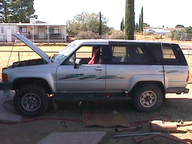

Been looking for a 22re 4x4 project for a while.
See them every day on I-10, one pulling another down the road in caravans.
They're heading to Texas, then onto ships headed for Central America, never to see the US again.
Finally found one just down the road.
W56 stuck in 4th gear. Had'nt run in 2 years: $500

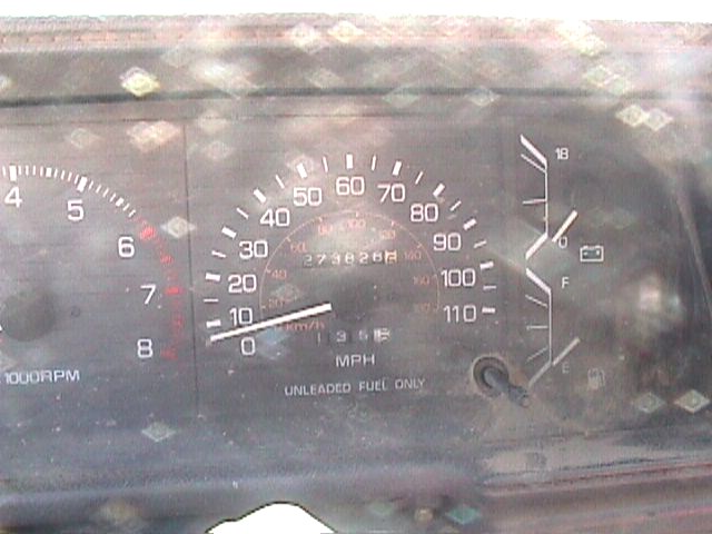

Odometer says 273,000.

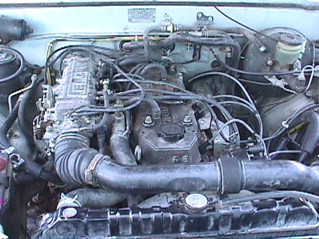

Got her running on 3 cylinders and home in 4th gear low range.
Drain sour gas from tank, new fuel filter and rebuilt injectors from Ebay, idles, runs well now. Compression 150-160 on all holes. Whoo Hoo!!
Got the shifter popped back into sync, is shifting into all gears at the moment, so far so good.
Everything needs at least a little attention, a rear transfer case output seal, for sure.
Maybe ready for a test run next week
