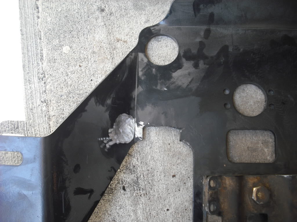

don't have time to do this? probably 1 min with a cutoff wheel:
I'd give yourself some time for your SAS when it happens. a good shop that's done it dozens of times can bust it out in a weekend if they have EVERYTHING on hand and it all goes smoothly, but even then there are other factors depending on what else needs to happen - like prepping the axle for example. i would give yourself at least a week for this. probably easier to just buy a beater car or scooter temporarily so you can get to work, then sell it afterward if truck is your only vehicle.

i was talking about not having time to do dual cases. Is that clearancing for the drive shaft? that looks bitchin... thats the budbuilt x-member? looks pretty damn flat with the frame.
