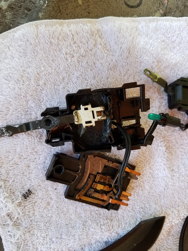

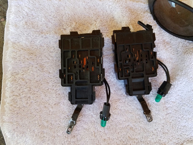

so a bad resistor that seemed good had fried my switch

replaced it and the resistor and life is good again

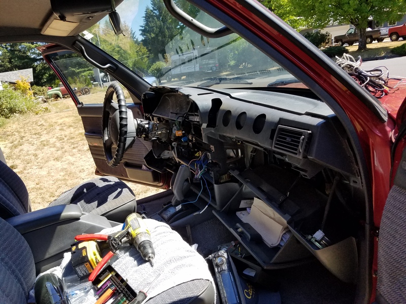

i was also replacing the dash cover and stereo too so I had pulled the entire dash out

it wasn't too bad, you should be able to do it by pulling apart the lower console, glove box and the cover under the steering wheel also had to come out if i remember correctly. i just sort of started unscrewing stuff..
