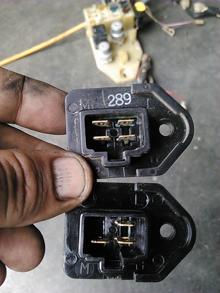

A difficult problem I ran into was the blower worked on Hi. I ordered two resistors for two different trucks. My 85 used a 3 prong so I ordered two 3 prong resistors not realizing there is a 4 prong available as well. When I went to work on an 86, it would not work. Took a while to figure out there was two different resistors.
