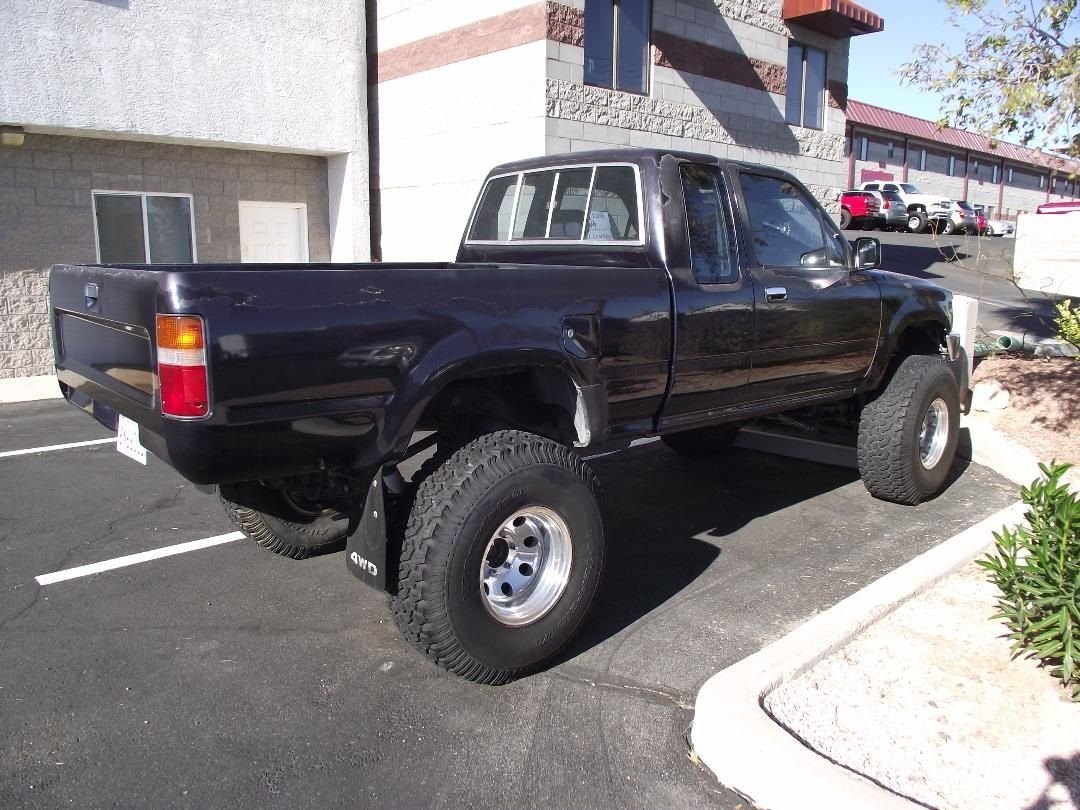

6 inch lifts are for the full size trucks. 4 inch lifts were the highest kits I could find for mini trucks. I liked and purchased the Pro-comp HD 4 inch lift because it ties the pivot point and bump stop drop brackets together for further reinforcement. It also has tubular reinforcement struts that run from the back of the rear pivot point drop brackets up to the transfer case cross member bolts for further triangulation and support for that additional 4 inches of leverage your putting through the suspension mounts. I ran this kit with zero issues for 20 years on 35 inch tires. I have since gone to a pre-runner theme so this kit was dismounted a few years ago however if I needed one I would definitely buy this kit again. I do have it for sale currently and you can see it at the link below.
here is a shot of my truck with it installed with my old 15X10 M/T Alcoa's on 35 BFG's I ran on it. BTW: The 4 inch blocks at the back were not quite enough to clear 35's so an Add-a-leaf was also installed to get the back end up a little taller.
