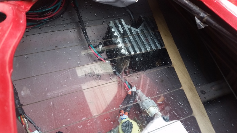

that rear lock is easy to remove, you can pull the rear interior carpet from the tailgate, than you find a metal cover held on by 5 or 7 screws. the key switch is held in place with with a gold colored clip and you should be able to undo the wiring harness (i think it is a 3 wire terminal)
there is also a black rubber sheath type deal over the lock
crappy picture but you can kind of see it in the bottom of this picture
i added some extra wires for a rear mounted window switch
