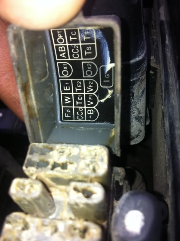

hey i went and did that test, i had an e1 and a te1 instead of just te, so i went for it anyway. i didnt run the truck just turned it to ignition, does it have to run? anyways the chk engine light flashed differently twice and my o/d light constantly flashed. the check engine light flashed once paused and flashed twice, the other pattern was flash twice pause and flash four times. im assuming that they are two different problems correct?

Those were/are the correct terminals to short. And, no....don't start/run the vehicle. Just the key to ignition is all you need/should do. You're just putting the ECU into diagnostic mode.
The O/D light, if you didn't know, is the overdrive light. It will illuminate because you have an electronically controlled transmission. It works like the CEL; if there's no problem, it will flash consistently as you've seen. If there's a problem, it will flash a code in the same manner as the CEL for the EFI system.
So you did get a code 24! Ha! Kinda funny...kinda not. The other code is a 12. The code 12 is the knock sensor signal.....probably because your engine is knocking because of the AFM being damaged. Which comes to the code 24; air intake temp sensor signal. Yep, sounds like you may have damaged it....pfth! You'll need to test it. Did you run that "AFM testing" search?
