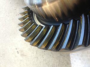

Those patterns look to be the proper depth. new gears.... so do an easy break-in

Originally Posted by westjohns yota
my trailgear 3rd has always done this, ive never had a problem with it except for the howling.....
Both sets of my 5.29 TG gear sets make noise. The coast contact pattern is piss poor for both sets. I'm keeping one in my front and already have a new Yukon set ready to go into my rear.
Wouldn't buy TG gears ever again. Good gears are worth the premium price IME.
