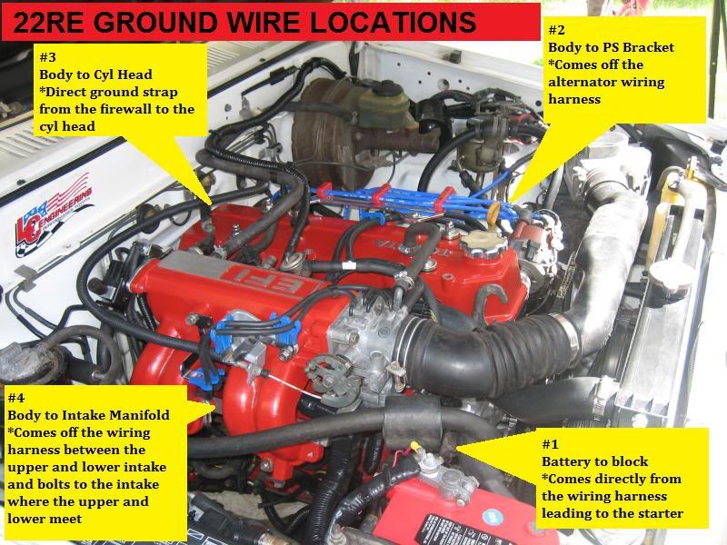

Old Oct 21, 2013 | 07:46 PM
ksti's Avatar
Joined: Dec 2011
Posts: 1,388
Likes: 8
From: CA, Until TSHTF!
Originally Posted by bthompsonwyak
91 toyota pickup 22re 4wd spark plugs last year. Fuel filter before a fuel pump and gas tank. Could be clogged again. Seems to happen more when wet
If it's worse when wet, then it's possible your getting moisture
on some wiring or connection.
Also check for frayed wires and also make sure all your grounds are clean and tight.
