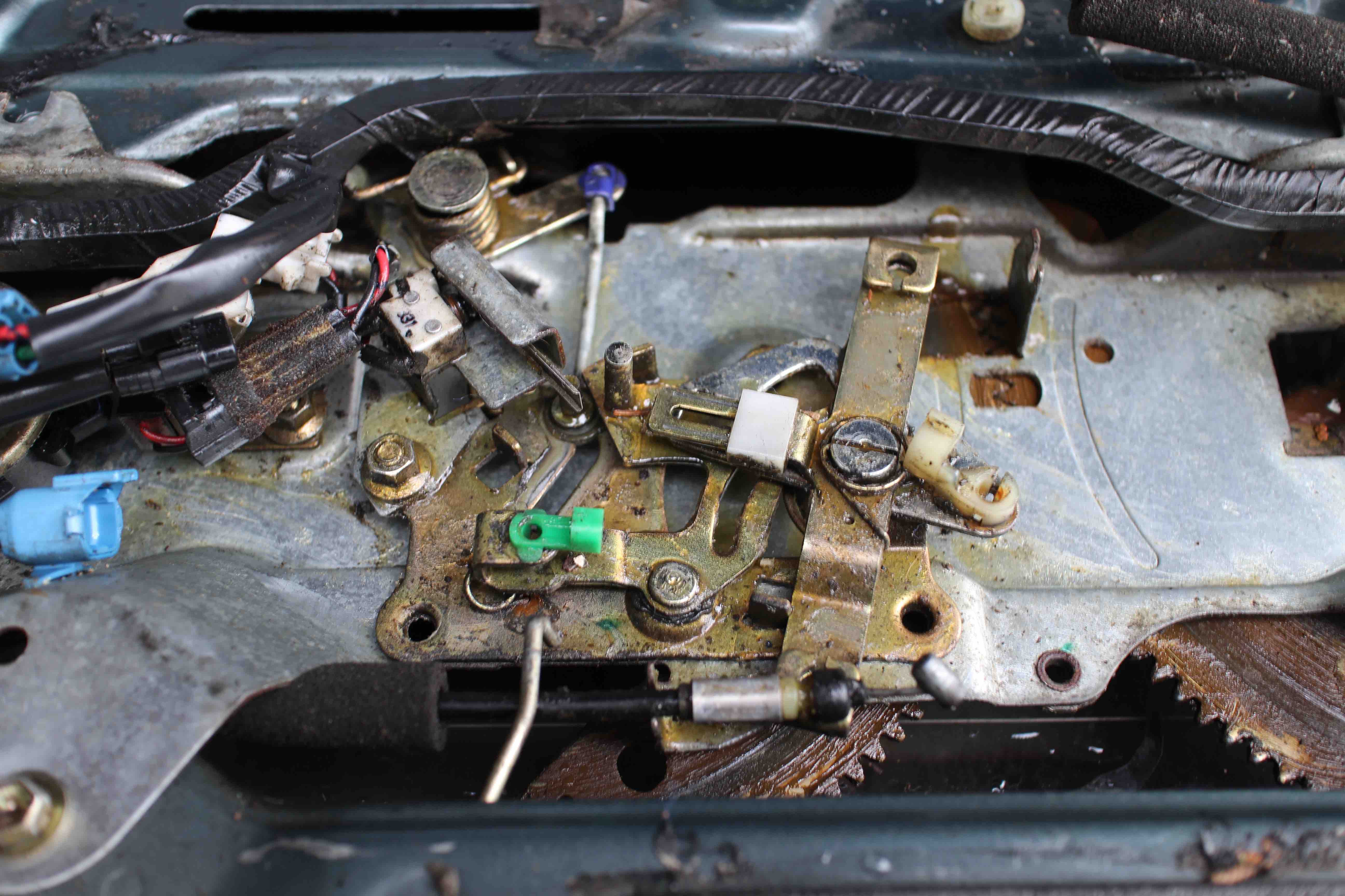

Post some photos of the rear window mechanism and some of us with a lot of time sunk into fixing them should see the problem. Are any of the gear teeth broken? If the arms are bent, should be an easy fix. Not sure what trim you're talking about with 2 screws you can't get under, photos will really help solve this.

If it took a good hit something is bent
I wonder if it Popped the regulator off the Motor enough for the Motor to rotate now it will only go so far till the safety stops it
Pictures !!

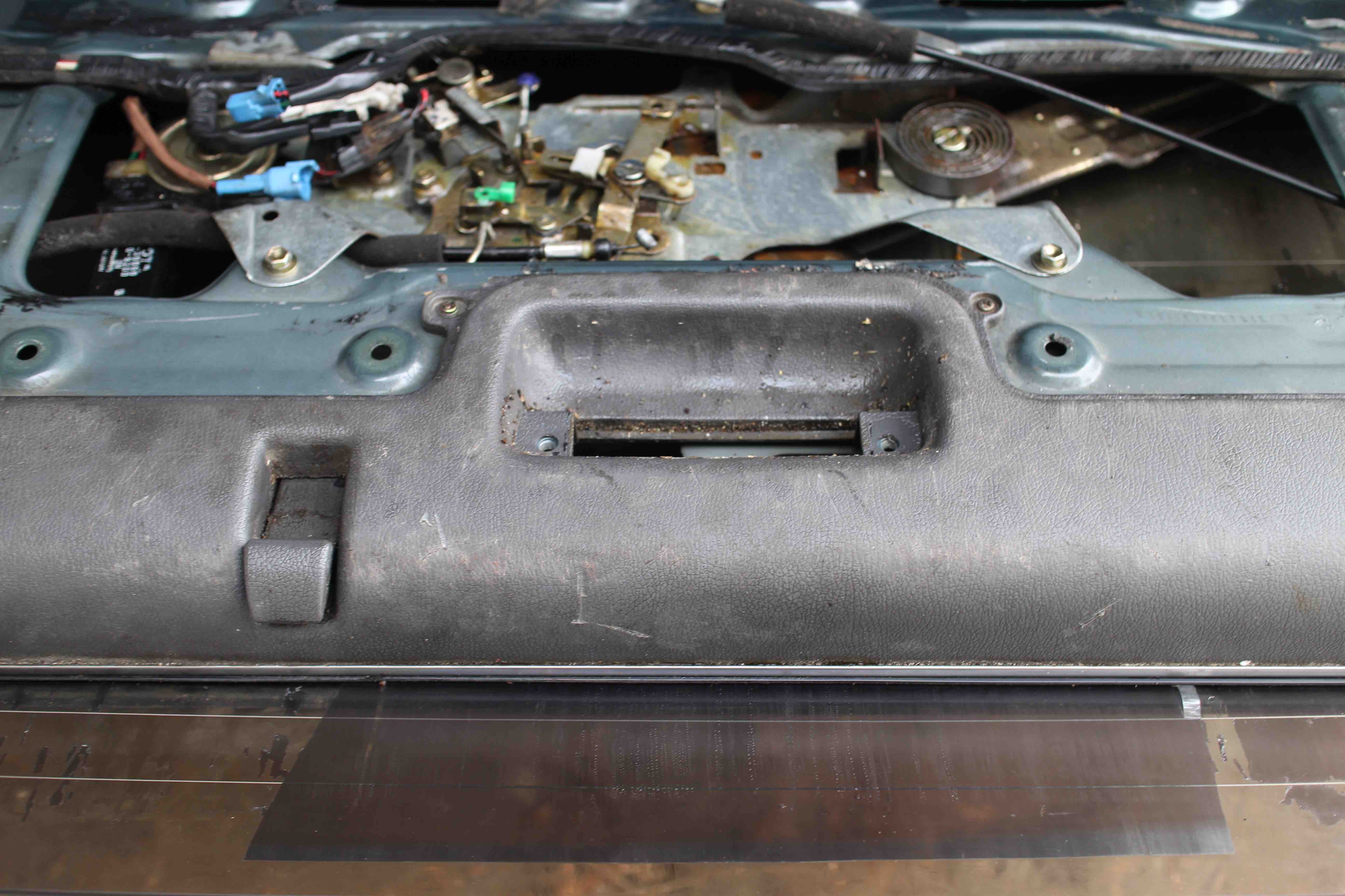

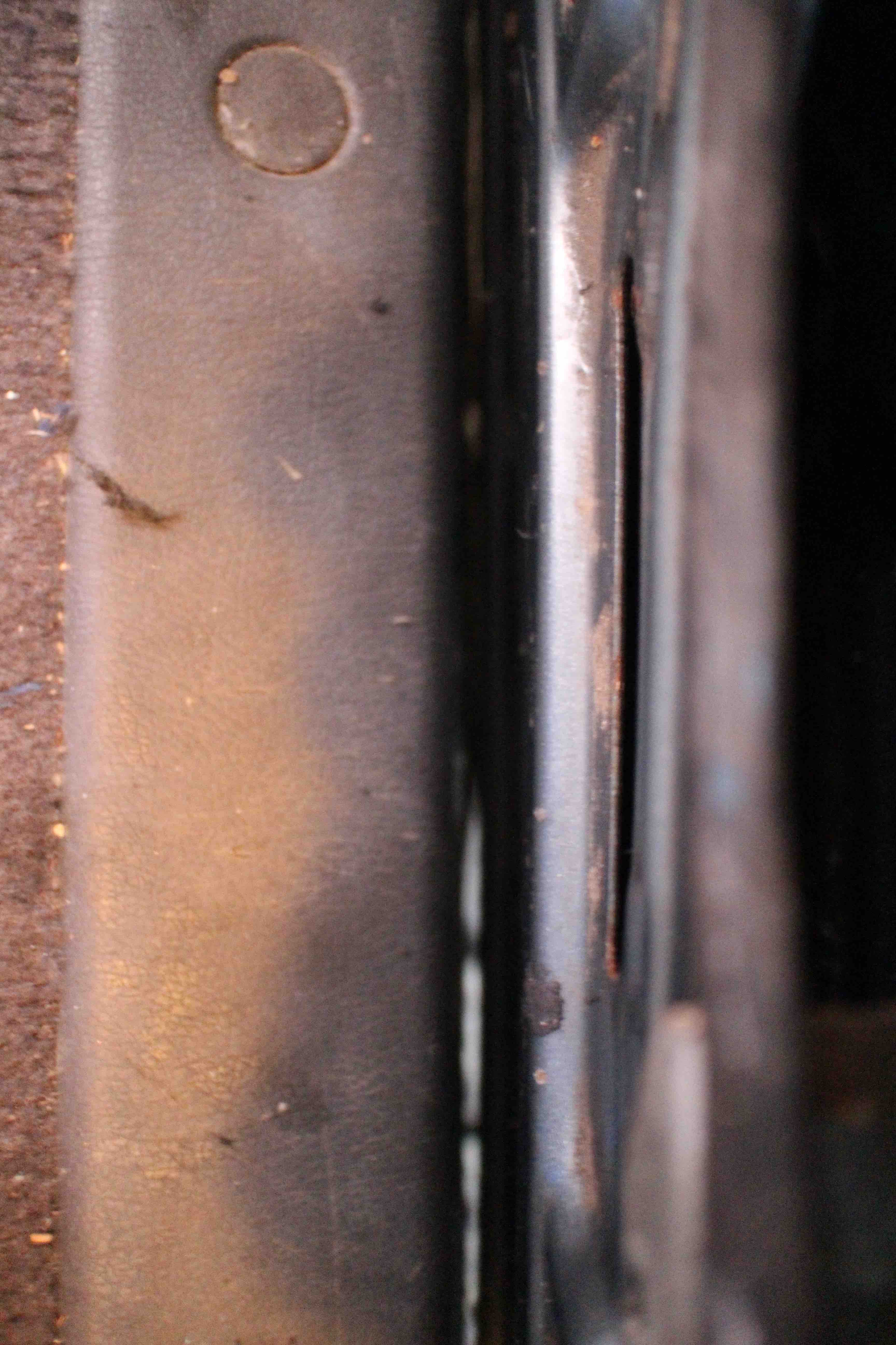

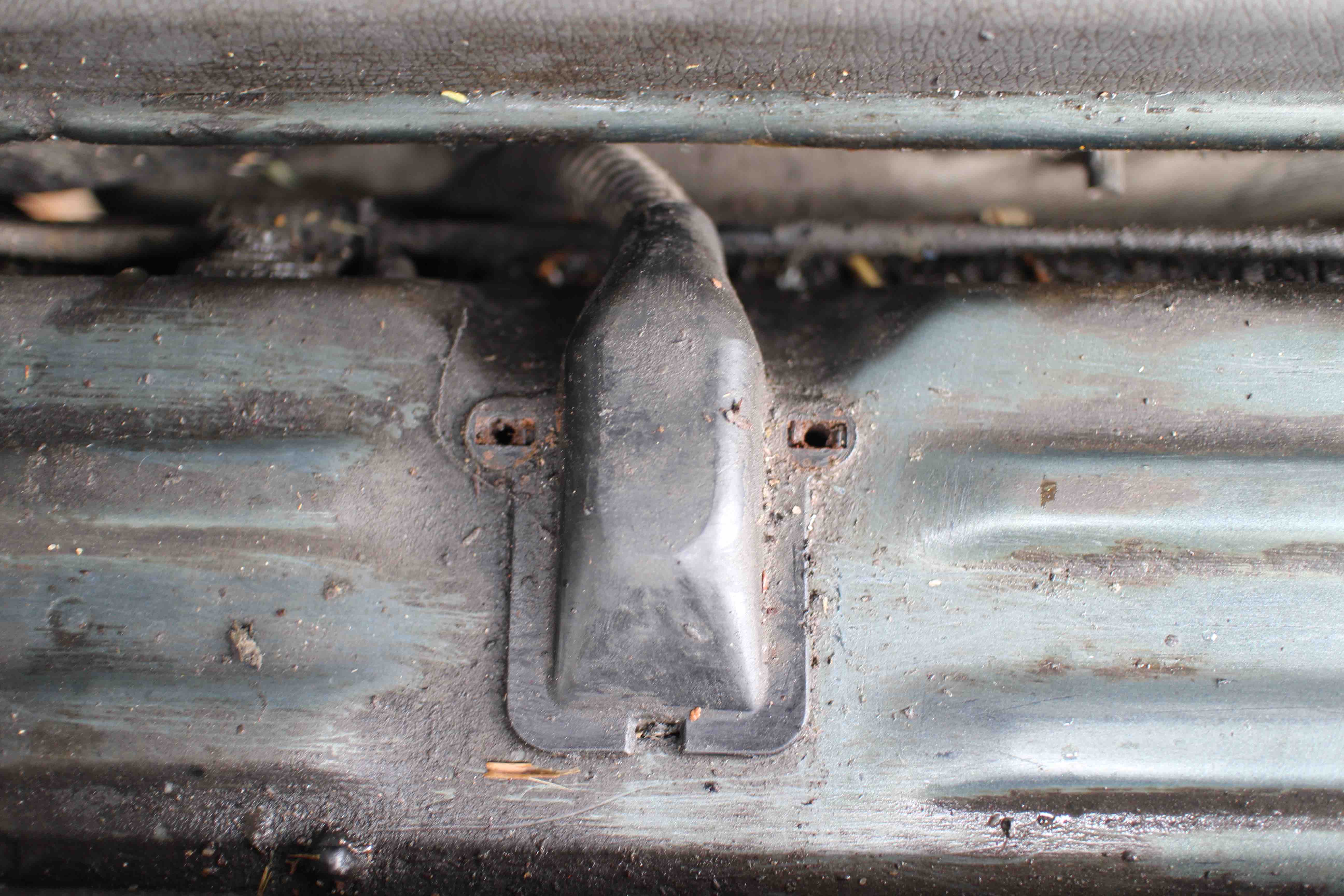

Here are some pics. The 2nd one is that housing I mentioned that carries the wiring harness to the front of the truck. I'm uploading a short video, so I'll post the You Tube link to it soon. Help appreciated!

looks like what I thought The impact knocked the motor loose from the Regulator.or the regulator out of the track
The Regulator is under tension .this needs to be held in place with something as things are assembled
The only time the regulator should move is when the motor is energized when all the safeties are closed
I am at a loss as how to describe it without pulling a hatch apart .
It would take a few minutes in person to figure out

either the motor is trashed or the teeth are missing from the regulator or both. pull up on the glass while you actuate the motor and see if you can get the glass up far enough to disconnect the regulator and remove it for inspection.

Now that's it's light out, I can see the tailgate got bent. Where the tail gate had pressure on it was near the lock cylinder from the inside.
I've tried pulling on the glass while running the motor, but it doesn't engage. Still stuck.
You can see in the 2nd pic that the tailgate doesn't seal to the bottom when fully latched.
Might need whole new tailgate...

Still can't figure out how to disconnect main wiring harness, in particular, I don't know what to do with that housing - anybody seen this?

It has been a few years but I think the plug for the hatch harness is behind the left tail light

Follow up: akwheeler and wyoming9, you were both right. Motor gear was stripped, and not even spinning, even though the motor was. In other words, mangled. Took the regulator arm assembly out of the rear tail gate and greased it up. Found window motor at pick n pull (widow motors of same vintage will work!) and Bob's your uncle. Pretty intuitive to take apart and put back together, but I still hate Toyota for these terrible rear windows.
Oh, and I'm embarrassed to say that the 'bent' tail gate was not bent - it was put back together incorrectly.
