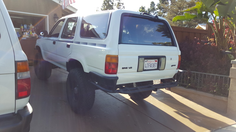

Hi All,
Just bought a 1991 V6 4x4 4Runner this weekend from my buddy. Drives great and both interior and exterior are in great shape too. Auto trans, but that is fine since it will be a DD.
Has a OME lift/suspension. He has replaced the passenger side CV boot 3x and now its leaking again. The CV angle is definitely extreme. What are my options here? Can you lower the differential down a little bit?
Some pics.

To be clear, this is just a front ball joint spacer with OME rear springs. The PO told me it was an OME lift kit, but it is not. Its what you buy from Toytec. Just a ~2.5" lift.
My main question is that after all the searching and reading, I feel that this is an average height and does not usually require the use of any high angle boots, diff drops, or anything special really. It seems weird that the CV boot is tearing after a few miles, and looking for any input on what to check.
The previous owner was just replacing the boots, and might have been doing something wrong, not sure. I am going to try and replace the entire half shaft and see if that helps. Also I'll finally to get everything apart and check myself.

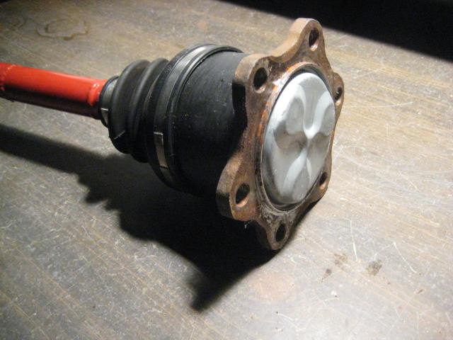

There are some differences in CV assemblies from OEM and aftermarket. I tried to find photos in my archive but gave up. The inner tripod joint or barrel end cap from OEM is stamped to maximize plunge where some of the aftermarket end caps are flat. There are also some barrel depth differences. These will effect the way the CV joint performs. Also the accordion operation of the boot itself (collapses or lengthens) vary from mfg. The CV limitations has been a subject for performance seekers since the beginning. Clearance modification to the barrel, using Porshe or VW assembly, Spicer Slip Yoke, high angle boots, etc. Differential relocation, offsetting the diff, center mounting the diff are other solutions. If you search threads I started you can read about much of this.
As for your particular problem the key point that just came to light is BJ Spacer. This spaces the ball joint 1-1/2" allowing more droop than the CV is designed for. Search that.

I found the photo of the inner CV joint that caps off the barrel. This is the stamped cap, I don't have a photo of the non-stamped but its easy to imagine what it looks like its just flat.
