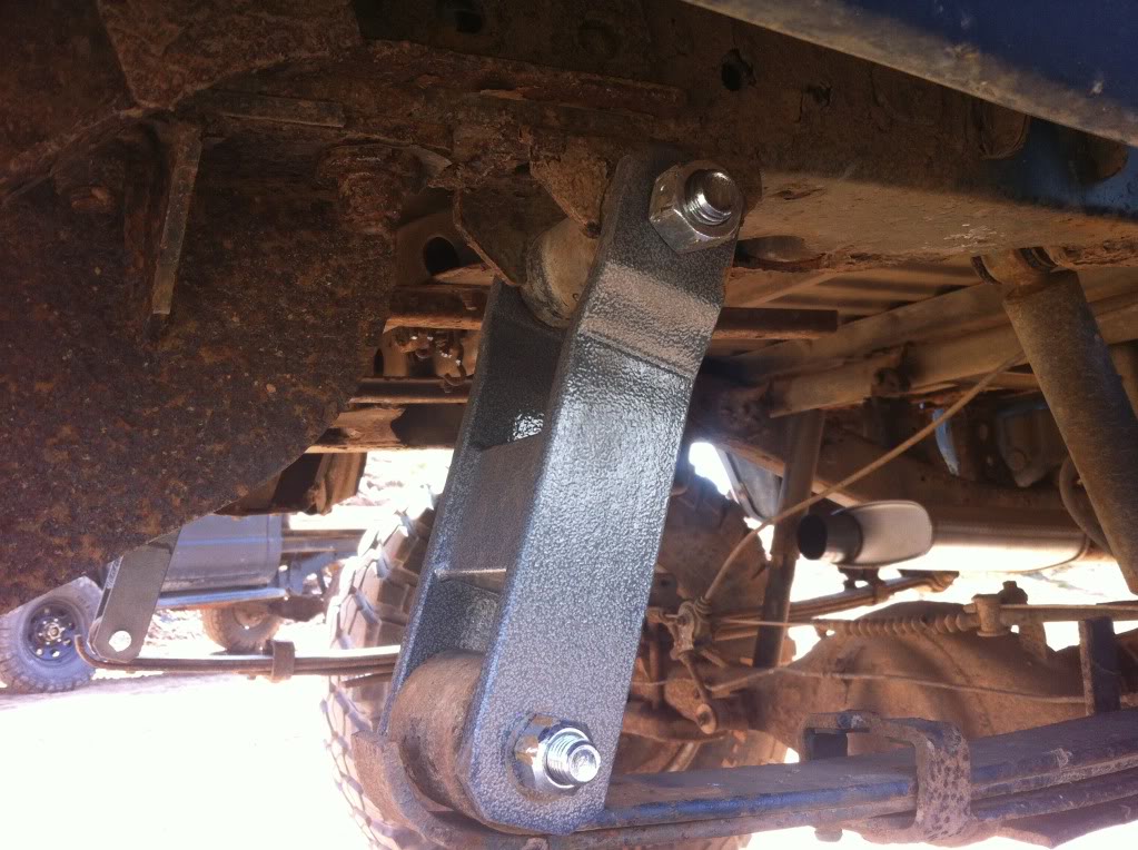

Here's what I did to remove my 4" blocks.
I searched on eBay and bought a pair of 2" shackles.
Once I installed my new shackles I replaced my leafs with a factory set from a donor rig.
Now I only have 2" of lift in the rear. To Gain the extra 2" I swapped it the Zuk mod.
Now I'm currently setting on 4" of lift in the rear and 4" of lift In the front. Also have 3" body lift. Running 37" tire with room for 40's.
You can't really see the mods in this pic although it shows the amount of lift. Name:  null-70.jpg
I no longer own this truck or I'd get ya better pics.
Here's a pic of the shackles i used

Thanks for posting advice with pics, really helps me, i am a hands on person.

wow rusty

Lol WV that truck set for roughly six years in a yard. It's covered in surface rust however no severe rust. It's really clean now tho.
