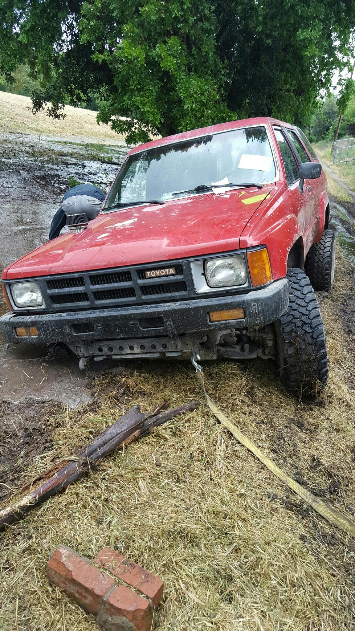

i recently became the owner of an 86 4runner not long after getting it i got it stuck in the mud mostly on the passenger side ive attached a picture ever since it wobbles really bad when i drive it. could i have bent the axle when i got it stuck its not really bent looking to the naked eye.

Pretty sure you didn't bend the axle. Have you washed the truck after getting it stuck? You could have mud on the inside of the wheel causing it to be out of balance and wobble or vibrate.

Mud stuck places or lost you wheel weights spinning your tires.

yeah i thought the same thing so i washed it pretty good when it first started doing it. after you suggested the same thing i took the wheel off i thought was doing the wobbling and it turned out to be a bad tire i think the steel belting is broken inside or something thank you for all the help
