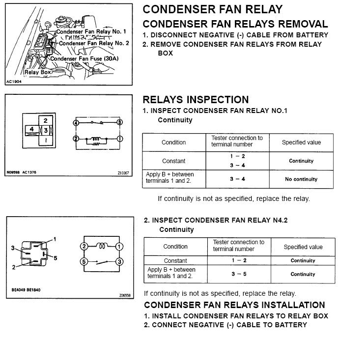

The fan of which you speak is called the "Condenser Fan" by Toyota. Looked up the inspection procedure for it;
1. DISCONNECT NEGATIVE TERMINAL FROM BATTERY
2. INSPECT CONDENSER FAN
(a) Disconnect the fan connector.
(b) Connect battery and ammeter to the cooling fan connector.
(c) Check that the condenser fan rotate smoothly, and check
the reading on the ammeter.
Standard amperage:
8.0 ± 0.7 A
(d) Reconnect the fan connector.
3. INSPECT FAN SPEED CONTROL RESISTOR
(a) Remove the front grille.
(b) Using an ohmmeter, check the resistance of the resistor.
Standard resistance:
0.6 ± 0.06 0 at 20° C (68° F)
If resistance is not as specified, replace the resistor.
I also found this info regarding the relay that controls that fan;
Hope that gives you something to start with.

You are a bad dude Noltz! That definately gives me a good starting point. Do you think that a bad relay in might cause the A/C switch to seem jambed?

I'm wondering if I didn't test the relays properly. Can anyone walk me through that proceedure? Much appreciated...
