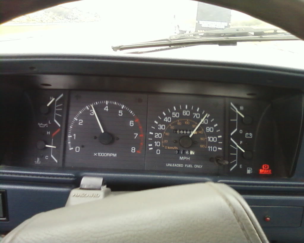

didnt get a chance to today... will do tomorrow. im also gonna check the charging system... should be around 14.4V at idle.. right?
oh, check this out... took this morning while driving. are these RPMs normal for this speed? or low, or high?

Old May 24, 2009 | 09:06 PM
neilan's Avatar
Joined: Jun 2006
Posts: 462
From: Corvallis Oregon OSU
Id say your speedo might be around 5 mph off. (too high) Id be more concerned with your oil pressure being pegged and your amps being darn close?
